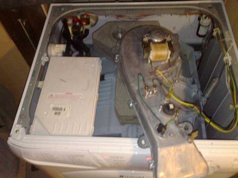

Hi,
Wondering if you can help me. I had a F13 displayed a while ago not thought anything of it. Now went to use my Dryer as its colder now. Since looking this up ive had it open as its out of warrenty. The heater heats but the fan is stuck with all nasty black stuff.

there are 3 differant heater boxes versions for your mc ,all you need to do is undo the nut in the middle of fan and push it down 1 mm ,the nut undoes clockwise not anti clockwise its a 11 mm nut .it stops the fan hitting the lower heater box put a spot of locktite on the nut to stop it happening again

no dont steam it just scrape any fuff off the heater box and adjust the fan
Got the fan going again, but heat element not working. thought it was before but could have been fan motor overheating. Any way to test thermastat? before buying 1 for 5 pound then the element for 33 pounds thanks in advance.
test the themostate with a continuity tester ,you will have a round disc next to heater a very small one size of 5 pence piece blob of paint on top you can reset it with a pin,or if you have a long yellow wire that is not resetable
bottom left is themostat 2 wires on it blue/geen and looks like yellow ,in the middle of that is a blob reset it with a pin
Hmm no joy. Not sure how far it goes in. Got it still running incase it wakes up :D
should just hear a click ,goes in about 3 mm,have you tested heater with a meter

test heater first ,thats above the stat should be 25 /30 ohms ,continuity on the stat should bleep thats the one down bottom on the left,yes borrow a METER :)
Hi sorry about the delay .... got a metre it shows 230v through it.....
