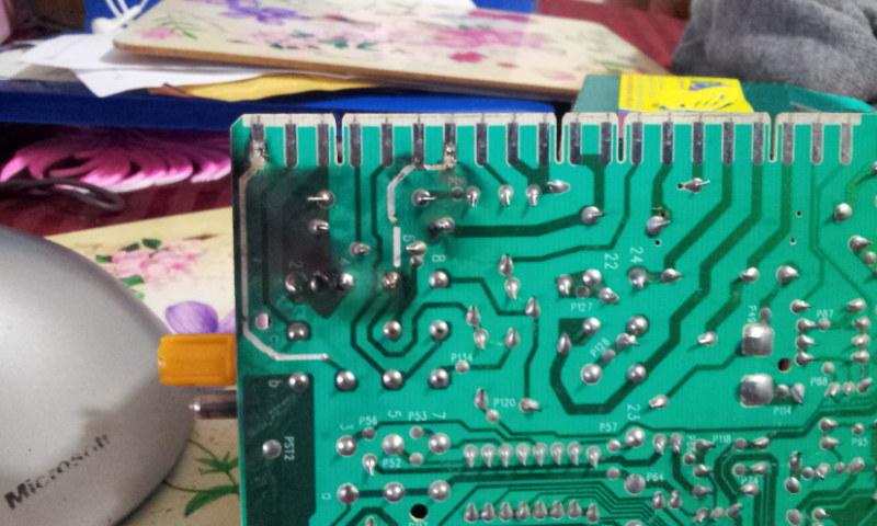

My machine went bang, I'm perfectly capable of swapping out parts or even repairing a pcb but I cannot figure out how to get access to the timer control board, so a service manual would be useful or can someone tell me how to get the front switch panel off to gain access to the timer control board. Many thanks in advance.

EDIT: Never mind, I figured it. Dead PCB and door switch :(
You won't get a service manual trade only. To remove the timer first remove the dispenser then remove the 4 screws round it. Then pull the knobs off. Consol just pulls off , the timer is held on by 2 fat screws. Look at the pcb and the first black block of wires you will find a burnt track from the door lock netural supply solder that with a link and change the door lock. Try that first.
thanks, you were spot on. There are 2 tracks burnt and no continuity reading from the door switch.
see this here.
Are both tracks burnt-out due to the door switch then?
Seems like I can save £33 if thats the case
Yes. Door lock has caused it. Replace it.
Many thanks, machine now works. I probably would've bought a new timer control assembly had it not been for your fast, accurate advice.
