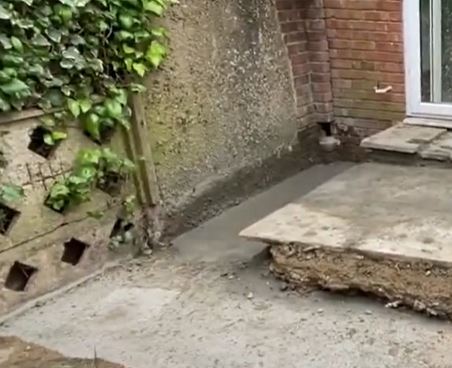

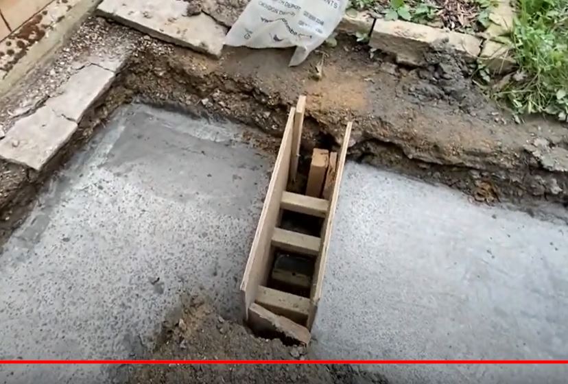

2) Is it ok to fill trench fill concrete in stages.. i.e. do a small section at a time wait for it to set, then do next section several days later?
I watched a video where the builder filled their trench with concrete in stages, left it to dry then did the next bit over a few days- I would have thought if you did it this way to have rebar rods in the end joining the set concrete to the new bit you are laying for strength?
I was under the impression the whole length of trench would have to be laid same day?
Example - in the video the strip joining the house has just been poured, the rest is already dry from day or two previous..![foundation concrete in stages.JPG foundation concrete in stages.JPG](https://cdn.diynot.com/data/attachments/251/251997-62d4cbc5daca51f990801ec997013f99.jpg)
