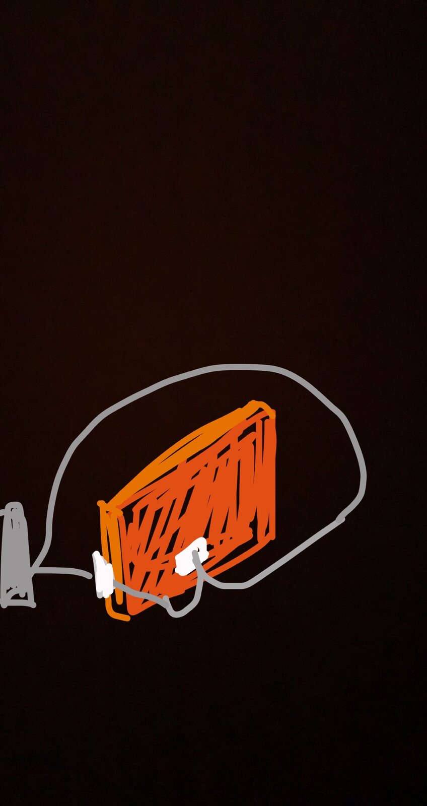

I’m trying to understand the wiring in my house, probably a bit OCD as I’m having it rewired anyway, but I like to do my research.
If a socket on a ring is in the main bedroom, and the box room behind the bedroom has a socket in a mirrored position - surely the wiring cannot be balanced or equal lengths (30cm piece of T&E joining the two) and same for the landing? When other sockets are spaced further apart on larger rooms
Or is it just the final legs to and from the CU that should be a similar length.

just curious more than anything - I don’t want to risk keeping the old sockets in the same position but increased to the correct heights if the current cable layout is wrong.
Read about the balancing of both sides of the ring and I wondered how it was possible in its current layout.
There is no correct height. It is your house.
Balancing does not mean 50/50 everywhere on the circuit - just not more than 27/32 at one end for any appreciable time.
Anyway, if you are having a rewire there is no need to install ring circuits any more.
Non-existent problem solved.

The cable has to be rated at 20 amo or over, and to have a large enough imbalance so 20 amp in one leg and 12 in the other for an extended time is unlikely if the recommendation to have non portable equipment over 2 kW on a dedicated circuit.
If you use a non heat pump tumble drier close to the consumer unit there is a slim chance of an overload in one leg. That is about the only item other than the immersion heater that can draw current for long enough to cause a problem.

If you were installing a series of sockets, in a line, all along one long wall, wired as a ring - to even out the load on each leg/arm of the ring, you would connect them on the alternate arms, all the way along the wall. Arm A, Arm B, Arm A, Arm B and so on.
