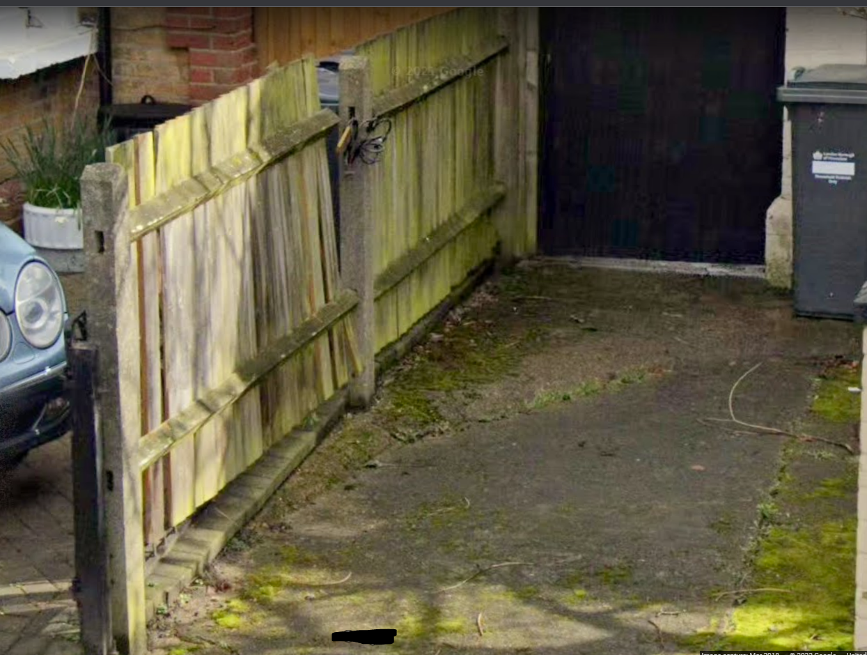

How can I remove these concrete fence posts they are embedded in my concrete driveway.
I am not comfortable using a jack hammer nor a large circular saw.
I have this small saw: DeWalt DCS571N, would it be possible to use it to cut then out of place?
When putting new fence posts in, I am considering surface mounting wooden fence posts but unsure as to durability.
Please advise.
Do you have an angle grinder or SDS drill? If so you could chop it off near the base with a grinder and you can get sds chisel bits that would allow you to chip out the last bit and concrete.
Goes without saying a proper breaker is less effort than an SDS. Your saw looks more suited for woodwork.
If you do break out the concrete plug you'll have readymade holes for new posts. I've used fencemate durapost for a couple of fences concreted in and they are a lot lighter than concrete and don't rot like wood. Bolted down won't be as strong as concreted in.

if you must, use a breaker/sds to break the concrete base and use the post as a lever.
Remove all rubble from the hole before replacing with fresh concrete (wet the existing concrete)
I would certainly refit concrete posts

I would leave them if they're sturdy and straight.
Then you can fix 3x2 batons on both sides and use the holes to bolt them through.
And there you have a great support for fence panels (although they would probably need cutting.
If you want to fit panels straight in (assuming the posts are at the correct distance to each other) bolt fence clips through the holes.
You can fill the holes with wood for support so the fence clips won't wobble.
Another thing to consider is the damage to your neighbour's drive. I don't think those posts will come out without accumulating collatoral damage.

Good point. Usually the 'fair side' of a fence, is installed so the owner has the better side. In the photo, the fair side is to the left, is that your neighbour?
An easy way to remove the posts, is to simply hit them hard with a sledge hammer, so they shatter at the base. Once shattered, the steel reinforcing will be exposed and can be cut flush with an angle grinder at ground level. A bit of tidying up, and your bolt down steel sockets for the new fence can be fitted on top.

The first post as you enter driveway is lopsided I think when they were lifting the skip many many moons ago it could have knocked it over. I rather just renew everything and make it all look uniform. Finally, the rounded top and speckled posts look ugly in comparison to the newer posts we had installed in the back garden.
You are absolutely right, I didn't consider this. I noticed the neighbours driveway border blocks are loose due to difference in height with my driveway and over the years the sand from under the driveway blocks has depleted leaving loose blocks. Maybe I can lift the blocks and place them aside.

Yeah well maybe. Given the disruption likely to neighbours driveway, I reckon it may be best to call a professional contractor in. Maybe along with that, I may as well get the uneven and cracked driveway concrete sorted. Oh Boy, don't expect much in the way of repairs when buying property from retired couple downsizing, especially an old Victorian. Things are never as easy as they appear at first blush.

I never thought to use fence clips through the mortices instead of using arris rail mortice fence brackets which admittedly are a nightmare to deal with.
Using clips as you described would indeed save me from having to install arris rails and batons.
The biggest issue I have a lopsided concrete post as you enter the driveway and that is proving to be a showstopper.
