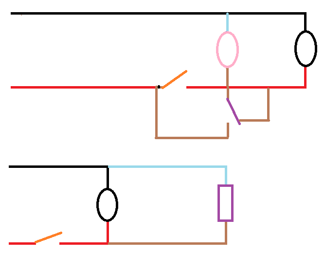

I have an occupancy sensor controlling the lights in the hall, and another controlling the lights on the landing. This has worked well for over 10 years.
I'm now building a glass balustrade with LED lighting in the handrail on stairs and landing. I would like this to be controlled by both occupancy sensors, so that if either sensor is triggered the handrail lighting on the stairs and landing will both come on.
To make this more complicated - the landing and hall sensors are currently on different circuits at the consumer unit.
Can this be done somehow, perhaps with solid state relays?
Existing lamps shown as black circles with red and black wiring, orange switches being occupancy sensors, these usually have a neutral connexion but not shown here.
Additional lamp shown as pink circle with brown and blue wiring, purple being a relay coil with a changeover (2 way) contact.
The enclosure containing the relay will require a label indicating "2 supplies"

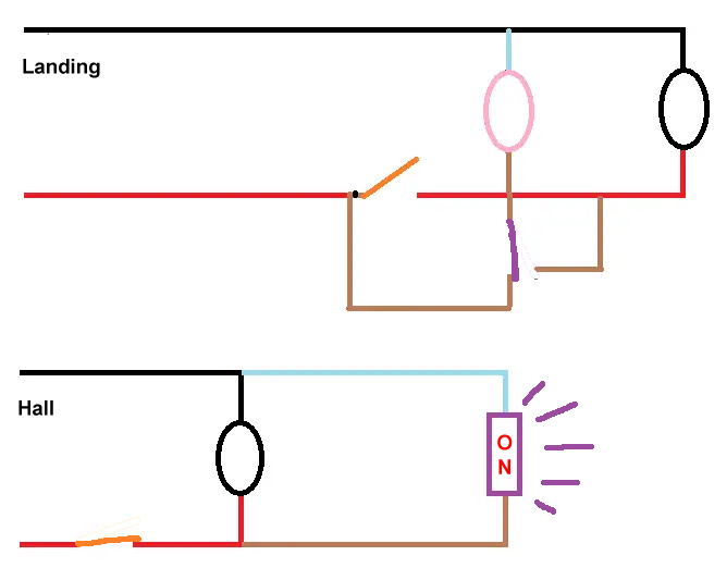

Hi Sunray,
That's very impressive and posted so quick!
I've spent the day trying to get my tiny head round it, and think I finally understand. I take it that everything is shown as OFF in your diagram, and that if for example the Hall occupancy sensor was triggered, it would look something like this:
If I've got that right, can you please advise if something like this LY2NJ relay would do the trick (is it overkill being DP?):

It's the LED lighting that will be inside the handrail, beaming down into the glass. If it was controlled by the occupancy sensor on the landing, then the handrails wouldn't illuminate when you walk through the hall. If it was controlled by the occupancy sensor in the hall, then the landing handrail would be unlit unless you walked downstairs.
So you need a box with two relays, job one is select relays which can fit in a box of a size you like.
I did it with my central heating, there was room in the kitchen cabinet to mount a box large enough for two din rail mounted 8 pin valve base relays.
But guess you want smaller units?
Hi Sunray,
Yes you have understood correctly and that relay will be fine. The listing says 240V ac but the picture shows a 12V dc version.
Looking at their other items I'm sure they have simply used the wrong image but it may be worth confirming the requirement for a mains version when you order.
As others have said you will also require an enclosure, any 'electrical box' that it fits in will do but consider the space required for wiring.

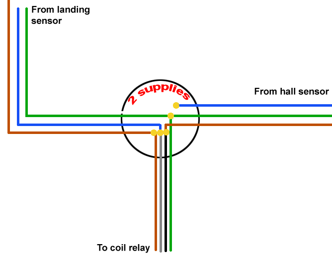

I'm planning to locate the relay junction box in the cupboard under the stairs, since that's where the controller for the LED light feature will be. I have some spare 4-core cable (6243Y) which I'd like to use for this.
The cable from the landing sensor and the cable from the hall sensor will cross paths in the hall ceiling. Keeping in mind these are two separate supplies, can I terminate them both in a single junction box and then run both supplies together inside the 4-core cable to the cupboard under the stairs, providing I clearly mark both junction boxes with "2 supplies" - or is this a big no no?
