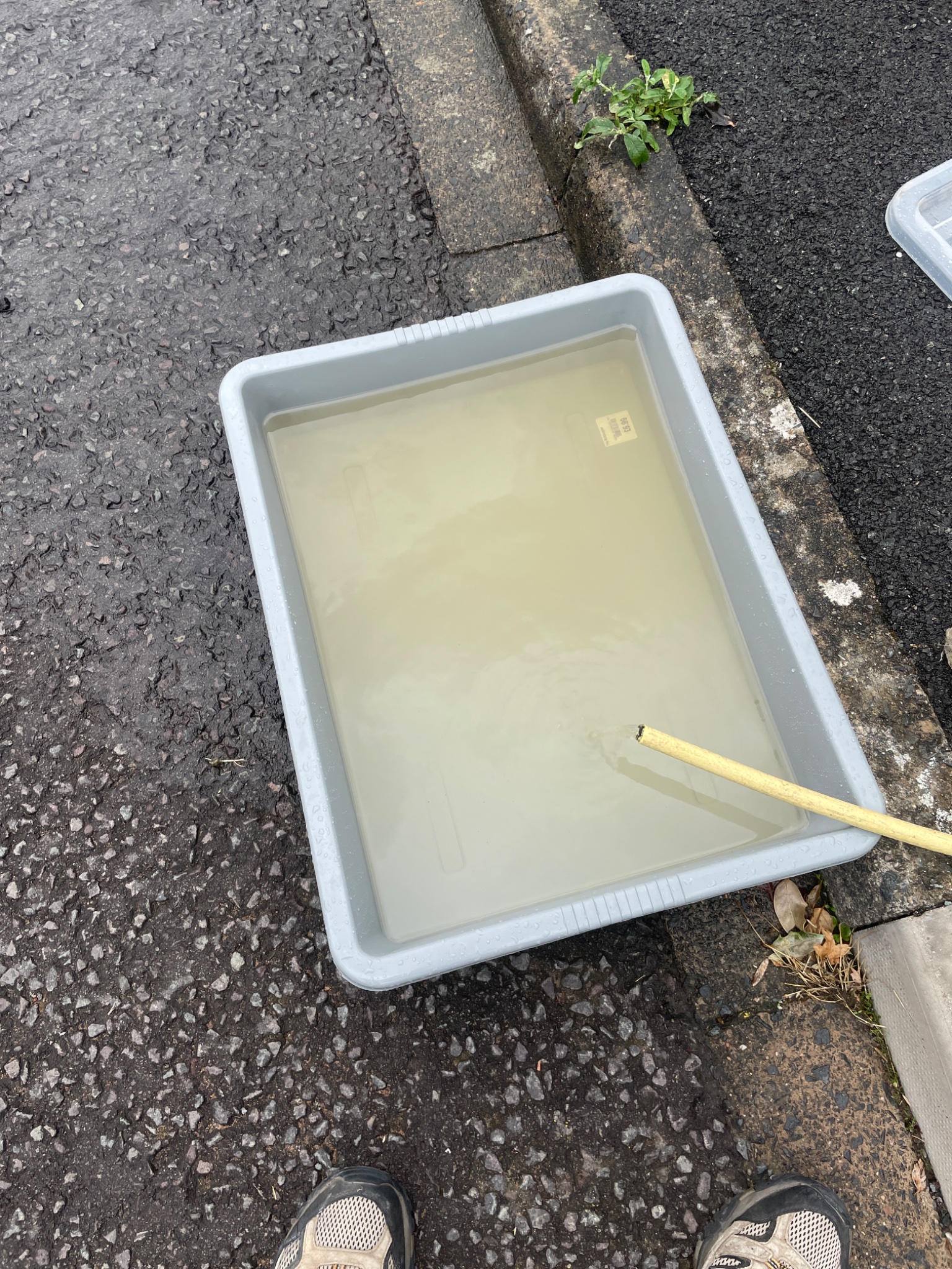

Hi all
So I have had MC3 in my central heating for 10 days and today I have emptied the system
I have filled the system twice bleeding the radiators also and ran the system each time for 45 minutes before emptying again immediately after turning the central heating off
I have also left the hoses on my lowest drain points individually while the filling loop was open to give it a further flush
I have now drained once again, and as you can see from the attached photo, the water still appears yellow
Can anybody clarify just how clean I should be expecting the water to be please or should I continue with the above approach until it is virtually clear?
TIA

Should be as clean as it goes in.
Thanks @Mottie and that’s the answer I was expecting although I’m a tad puzzled as to why it’s taking so many attempts to run clean

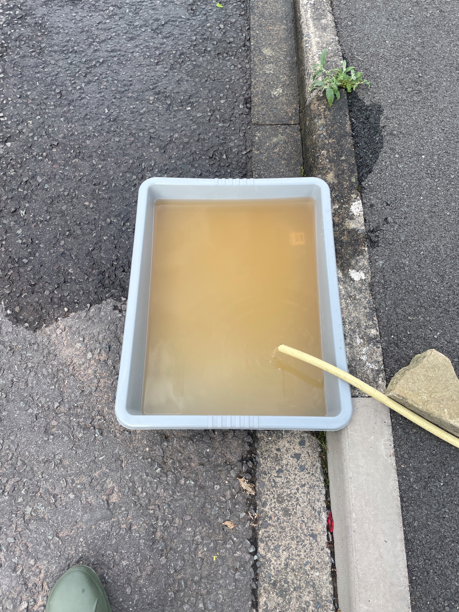

Thanks @gas112
So I think this is drain down number six or number seven and as you can see it is still extremely yellow in colour
Gotta say I’m actually regretting putting this cleaner in now I think and don’t understand why it’s not coming out if that’s what this yellow is indicating

thats a strange colour after all those drains and refills especially on a pressurised system was that also the initial colour or was it a lot dirtier as in brown /black .
Yellow/cloudy colour is usually flux residue which would have cleared after a couple of flushes
The colour has been pretty consistent @gas112
Always a yellowish colour and no, it’s never been dirty brown or black

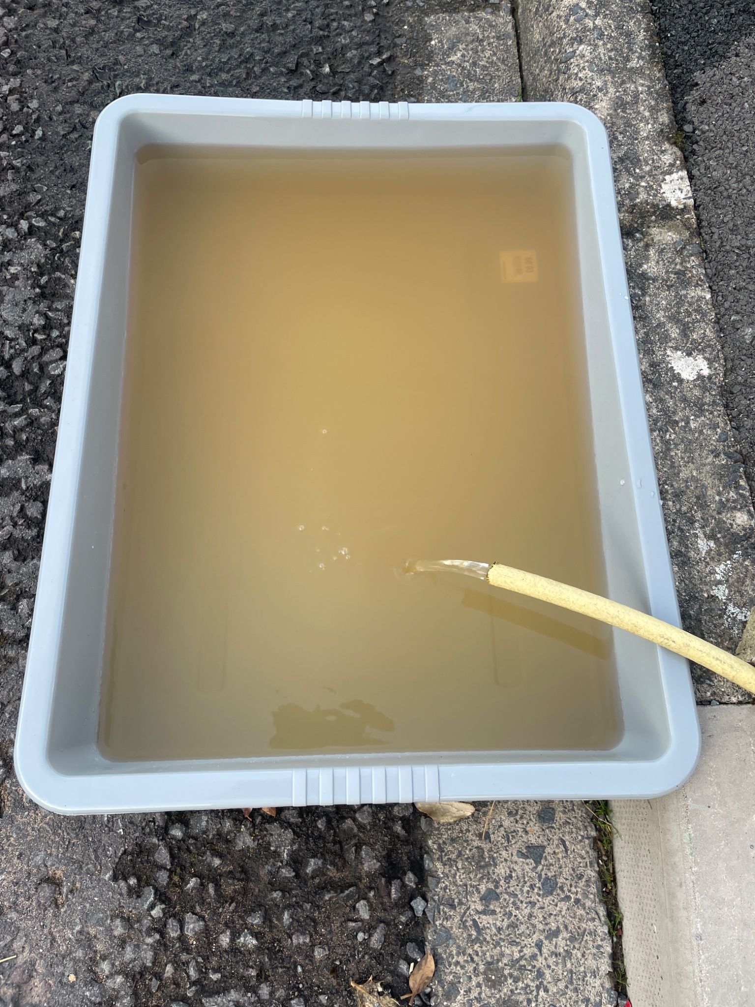

@gas112 here is the latest drain off water
Once it tails off, I shut 3 out of the 4 downstairs drains off and then flush that rad and it will go clean
I start with the closest to the boiler and then work away
I throttle the drain a little to fill the rads a little before opening again
Gotta say I’m like you, after this many drain and fills it should be improving, shouldn’t it, regardless that the upstairs radiators aren’t being flushed individually
They are being diluted significantly each time I refill
