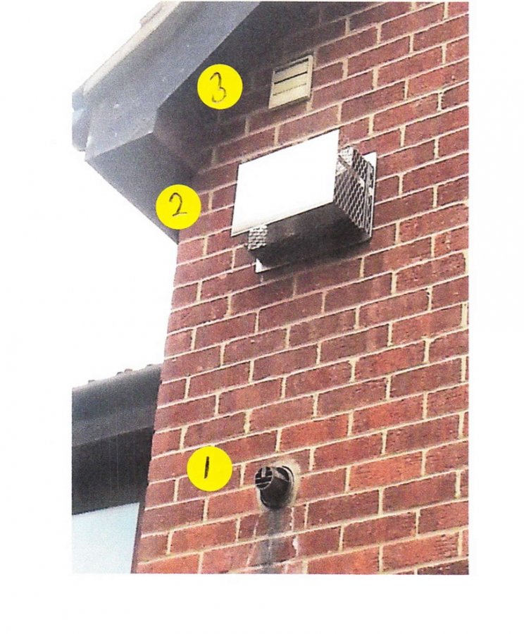

Ok, so now I am really confused. The Engineer has stated that he has issued a warning notice and used his discretion to allow the temporary use of the appliance. His test figures show passes for flue operation checks. What is my position now - could he come back and disable the appliances?
Apparently there is no insulation around the feed pipe taking the gas pipe through the brickwork - needs rectifying
If he ar the job then he should have asked your permission to switch off the offending appliance. I take it he did not ask you? If he did you are within your rights to refuse.

We are landlords of this property and use a letting agent. He told the letting agent that he used his discretion in not turning off the appliance.
