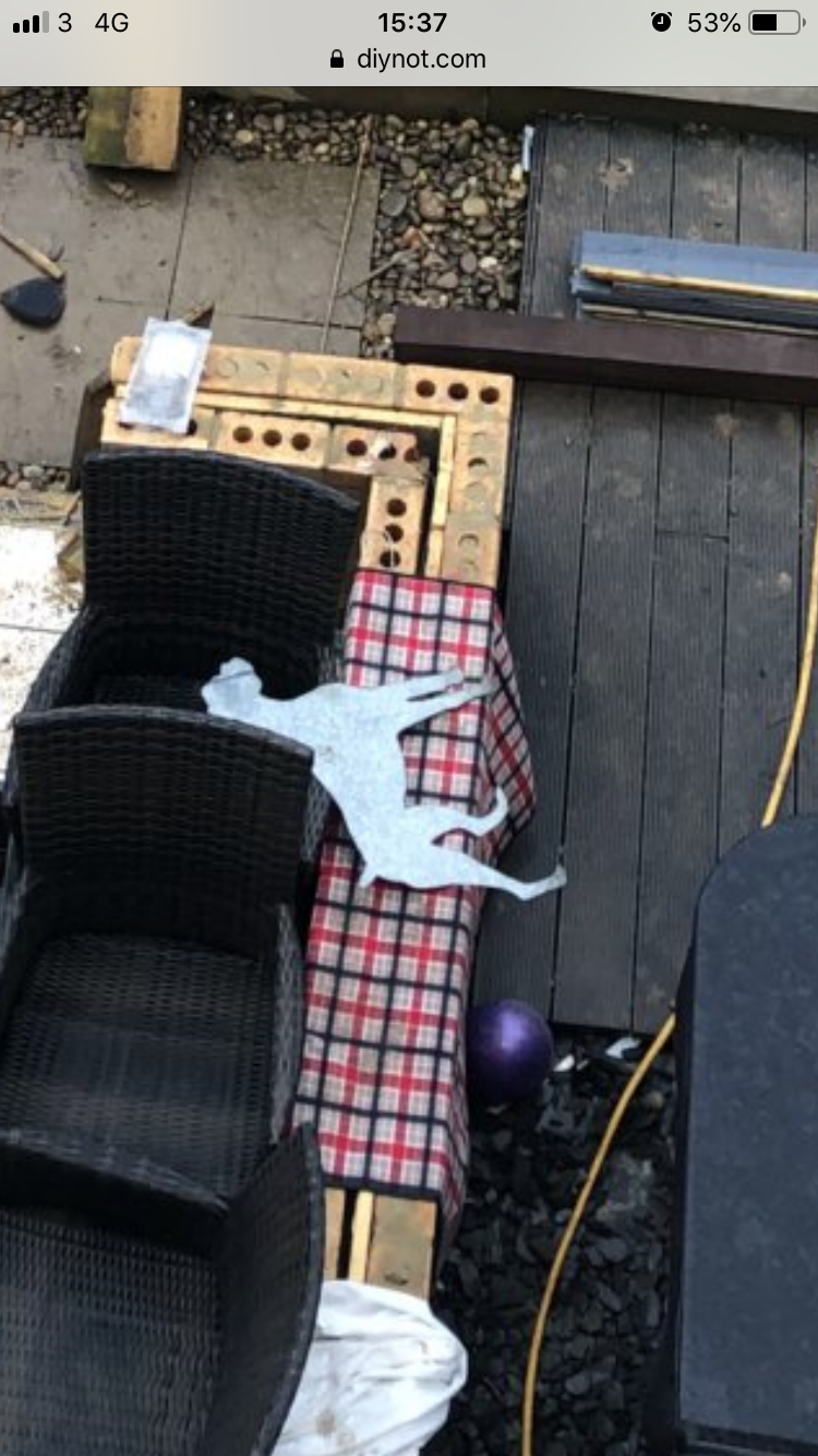

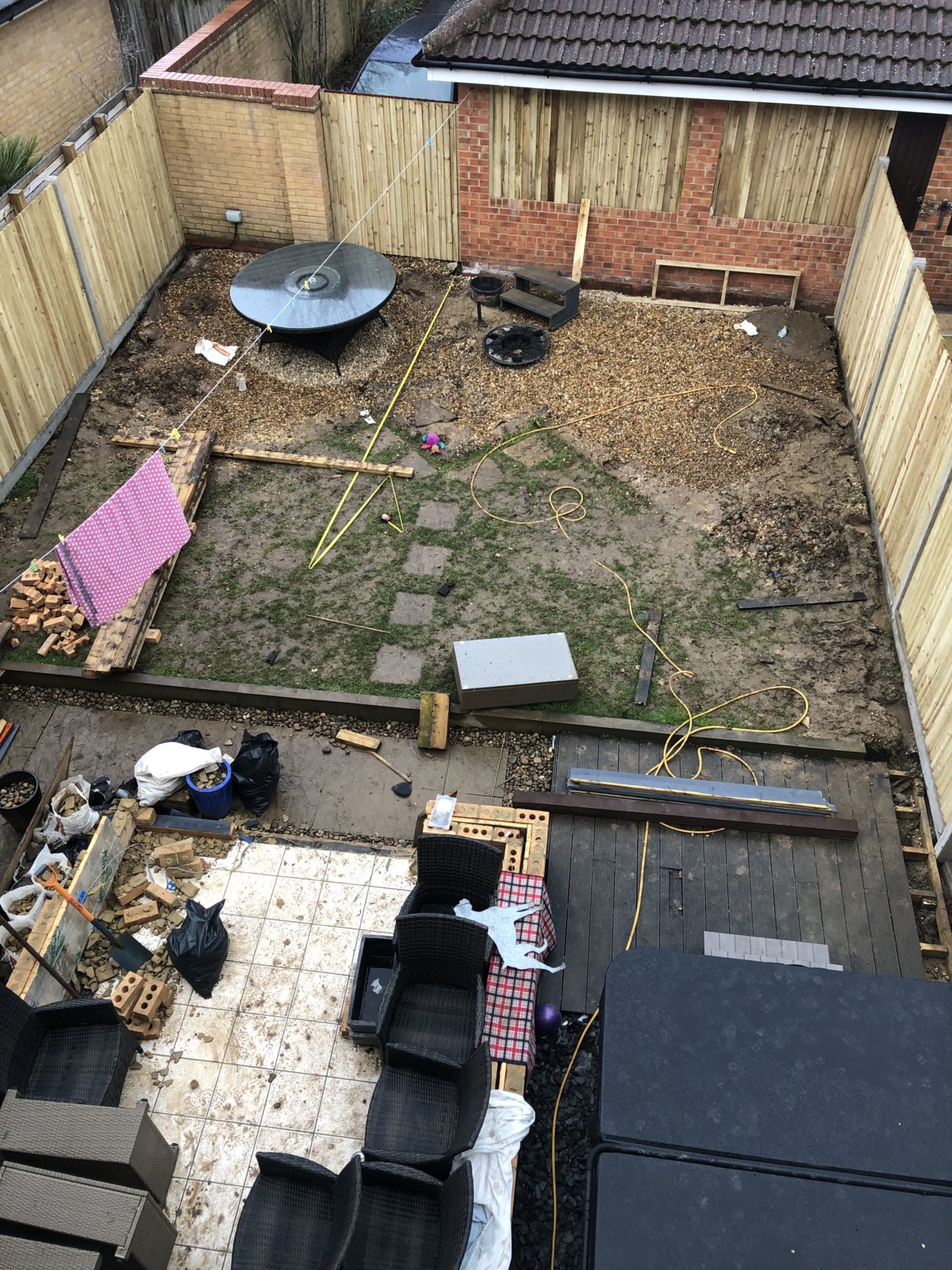

Hi - looking to build a 3 brick high retaining wall - intended it to be 2 wide eithba solider course on the top - it will be approx 8m long
How deep should I go with the footings ??
It is to replace existing sleeper holding back grass, although I’m going to move grass towards house (sleepers have been replaced a couple of years back and have never moved )

Scrape off the top soil a nd a bit more, normally about 250-300mm

Never mind the dog.... Why has the house at the bottom of the garden got fences for windows?

Frost heave is very important as well as soil type. When you drive around and notice garden walls and gate pillars leaning, it's because the foundations weren't deep enough for the soil type. The ground freezes and the wall/pillar leans a quarter of a millimetre. When it thaws, it seldom goes back, hence the lean over the years and hence the difference in quotes between someone knowing what they're doing as opposed to a cheap quote. In the long term, initial cheap quotes cost more money. Engineering brick with 3:1 morter is technically a DPC on garden walls, so I always start with 3 courses of engineering brick. DPC under copings is important, especially on parapet walls. Copings often detach because the vast majority of builders do not put the correct additive in the mortar.
I can't remember the exact depth for frost heave but I always go 2 concrete blocks and an engineering brick below ground level, which is 525mm. I think frost level is about 400mm to 450mm. In the link I've attached, some designs include insulation!! Put it this way, my walls don't move.

The height is hardly anything. I would say you wouldn't need to go any deeper than the 300mm max woody stated.
