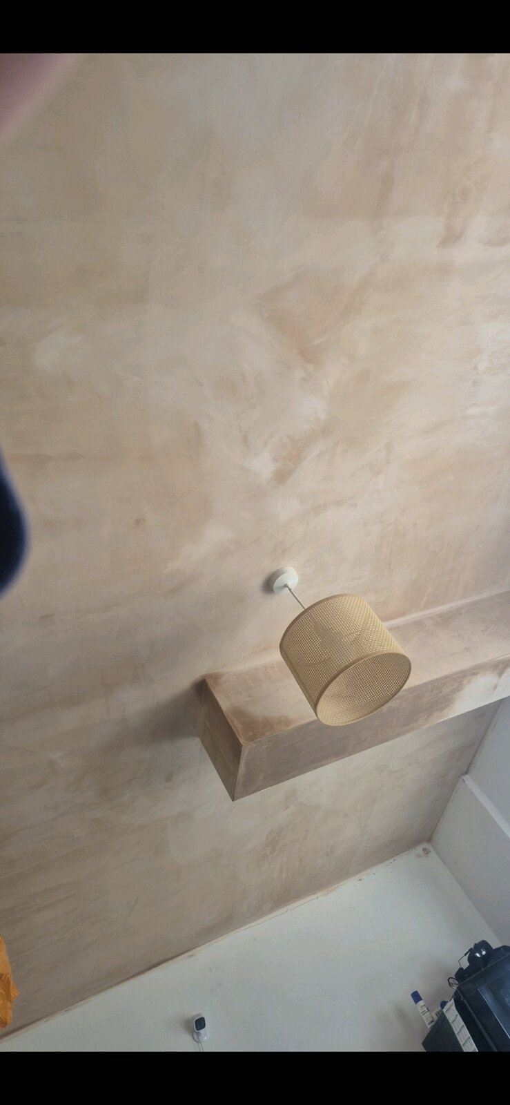

Hi all
Just wondering hiw difficult it would be for a total amature to paint a ceiling? Never painted before. What would I need?
I have been quoted £220 to paint it. Worried will make a total mess and have to get someone in to not only paint it but try and fix the mess I have made?
How many 5l bottles of paint would you estimate? Also need to do some of the walls as they have got some plastering on them. So yeah some wall too.
Please see photo.

I’ve just had my ceiling plastered on Tuesday. It’s dried out now so I’m at the same stage. For bare plaster, you need to seal it first. Give it a light sanding all over then paint it using a roller with a 50/50 mix of emulsion paint and water. When that has dried you can give it a couple of coats of emulsion, letting it dry in between coats. Don’t know how big your room is but for just a ceiling and a bit of the walls, a 10 litre bucket of paint will be more than enough. If it’s a smallish room, 5 litres should do it. You can always buy more if you need it.

The ceiling will require a diluted coat, followed by 2 full fat coats of paint. It may then require sanding/filling.
7.5L of Dulux Trade white matt emulsion will be about £30. That means the labour is up to £190. Potentially, that might involve moving furniture and laying down dust sheets.

Off the top of my head, £40 for dustsheets (if required), £15 for a decent 9" roller and sleeve, £5 for a paint scuttle, £30 for a decent extension poll, £15 for a decent brush to cut in the ceiling (plus a step ladder). That is £85 for tools only. Yeah, each of those can be used again.
A room with absolutely no furniture and obstructions, you could do all three coats in one day, assuming that no sanding or filling is required.
£190 for labour (when you factor in capital outlay does not seem unreasonable). The decorator needs to turn up (travelling time), shifting tools and then 30 minutes to clean the brushes/rollers. Sorry, it seems reasonable. As a decorator in London, I would charge more than that for a single ceiling. If I were doing the whole room, I would knock a bit off because of the logistics.
A morning is very hopeful. The mist coat will dryfast, but getting the final coat on in a morning is risky, as the second coat is unlikely to be dry.
