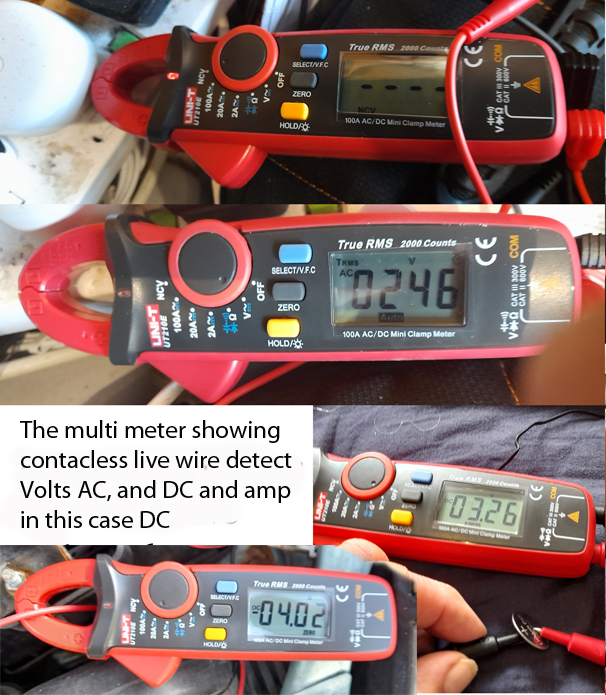

We have three tools, Multi-meter-reducesd2.jpgVC60B.jpgRCD tester.jpgthe multi-meter, the one shown can show 0.001 amps, the installation tester often 250, 500, or 1000 volts, and the RCD tester, first two not too expensive at around £35 each the last one likely more than £200 but to be frank I would not suspect the RCD is faulty, so one of the other two, but a type AC RCBO costs £15 and type A £18.60 and you at moment have type AC, plus an isolator to replace the existing RCD so the big question is if it would be worth finding the fault, or moving to RCBO's?
The RCD you have serves 5 circuits, the fault could be a built up over the 5 circuits, once between 15 and 30 mA the RCD will trip, but spread it out you could leak 75 to 150 mA before it trips, and when it does you only loose on circuit not five.

I tested my own whole house
and am reading 19 mA, which could trip a RCD, but I have 14 RCBO's so that leakage is spread between 14 devices, so unlikely to trip any one device.
