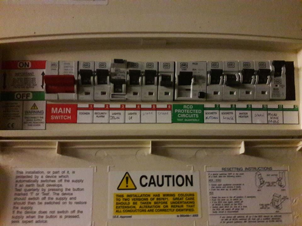

Hi All,
On Saturday night about 1am (give or take a couple of hours) our RCD tripped, if we turn the socket breaker off then the main RCD will stay on, (lights kitchen etc) Our kitchen units are on a separate breaker so it won’t be the fridge/freezer.
We have unplugged all appliances taken out all the fuses from spurs (To our knowledge) and it still trips when nothing is plugged in,
Before we get an electicrian to rip open the walls to check cabling does anyone know anything else we could do? Any help is greatly appreciated.
Alex
With ALL the MCB's on the RCD side switched off, reset the RCD to the ON position. It stays on, correct? If so, switch on 1 MCB at a time until you find the MCB that trips the RCD. Which circuit trips the RCD?
The RCD stays on if i have the 'sockets' breaker turned off. So we have lighting etc, but as soon as i turn the sockets to the on position it will trip out the RCD and I cannot keep it in. I've unplugged everything in the sockets in the house.
Think he answered that, @omega015
An RCD will trip if there is a fault on the line OR the neutral side. The fuse in a spur is only in the line side, so the FCU switch needs to be off.
First suspects will be where electricity and water can/could meet. So you must completely disconnect boiler/heating systems, outside sockets/lights/etc.
If still no go, and if the RCD trips consistently with that circuit, then you need an electrician with an Insulation Resistance tester to trace the problem.
Its more likely to be something attached to the wiring, rather than the wiring itself, unless you have
and his friends in your house..
Possibly a fault behind one of the sockets, cable chafing on a sharp edge, hidden JB, any outdoor sockets or lights fed from socket circuit
here is a picture of the box, just a little worried he will have to take out a wall to find where the fault is!
We have a main flick switch for the boiler, should there be another with its own spur? I can't think where else water will be in.
Thanks for the help by the way. Appreciated.
No he wont, if he/she is even a half decent electrician.
You can take off all of the sockets you like, but a fault like this will be unlikely to reveal itself unless you are very, very lucky.
In the end it will be something obvious/forgotten, rather than in problem that results in the house being demolished!
I guess you didn't do any DIY work just before the fault appeared?
