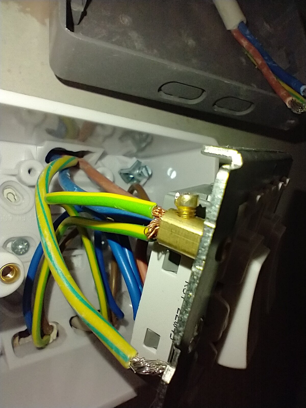

I am installing a dual immersion switch.
The mains + 2 element earth cables do not fit into the switch's earth terminal.
There is an earth terminal in the pattress box. Can I use this and if so which earth cable goes there, the mains or the 2 elements or 1 element?

Why not? Three wires are not that big.
Is the switch metal?
All earth wires must be connected together and to switch if it is metal.
Either all in the same terminal or in a connector block and then another wire to the switch if it is metal.

Use a Wago if necessary.
Thank you both for the prompt reply!!
The terminal is metal. Here's a photo.
Excuse my ignorance. Which connector do you mean?
I would use a WAGO connector , Easy to use. It is like a busbar.
You will need to put each wire in each connector and another wire to the faceplate (the one you are trying to use for all 3) It's an easy connect like in Post 8

He needs to connect 3 earths and have an earth to the faceplate. As they wont fit in the faceplate.

I suppose I can use a 5-way Wago or similar with 3+1 cables and leave a port unused?
