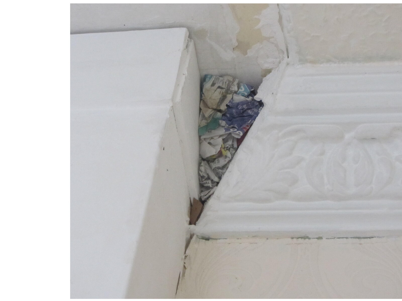

Some time ago length of coving, including round corner of window, fell off. It was replaced with plain panel, but has left bare ceiling which needs repairing with woodchip, and also the coving has now stopped at an odd angle. I'm not a DIYer but friend's offered to help. I need to paste woodchip so it blends in with stuff already there, plus somehow fill in the end of coving so it doesn't look so odd.

OK, similar coving appears unobtainable - I had seen it in Homebase years ago. It's far deeper than average. So I decided to fill holes in, and got 500ml no nonsense lightweight filler, not yet applied. Then someone suggested stuffing with newspaper - ok so far as it filled the huge gap. Then a matter of wet or dry paper? Spray with glue before plastering? If wet, would it rot inside the plaster? Someone else said avoid paper and gave me wire mesh, which is difficult to cut or bend - fine for holes in walls, but not for a gap which juts out, I thnk.

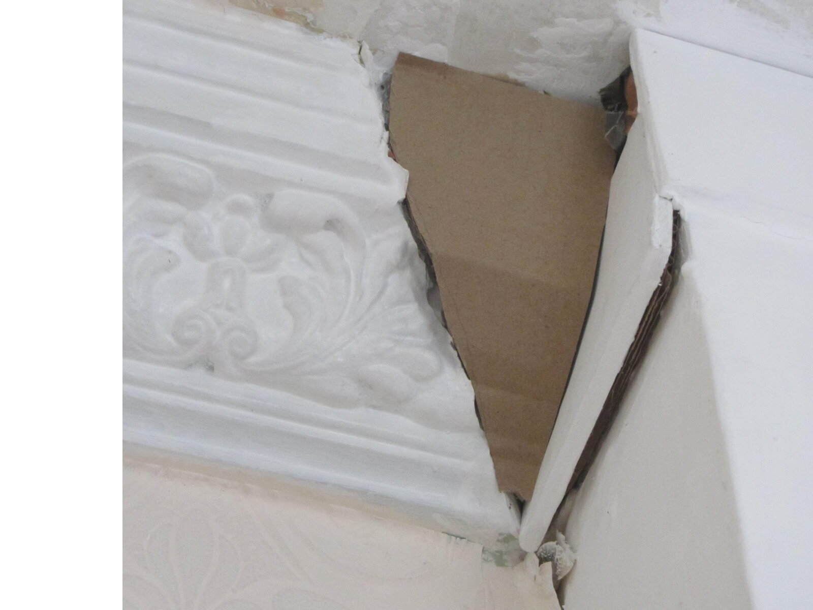

2 previous decorators both said they'd just stick card on and paint over that. Do they mean cardboard? Seems very fragile.
Any ideas with newspaper/glue/soaking or spraying water before plastering? You can see from when previous decorator put up pelmet it wasn't perfectionist, but it's done the job ok. Just don't want it to fall off or cause further damage.

I'd use a ready mixed sandable filler. Believe it or not I quite often use the 500ml tubs from home bargains. It dries rock hard and sands nicely. I'd recomend glueing some wood in rather than news paper and then filling with layers.
One other thing is to mitre each joint the opposite direction. This is usually how these would be finished, curving away from the pelmit rather than right up to it. Then fill in the ceiling bit and wood in the hole and fill again.
If this is a bit much though, build up gap with wood and layers of filler. Or pop in a slightly smaller piece of coving and filler over the top. When filler is wet you could always attempt the pattern with your fingers
