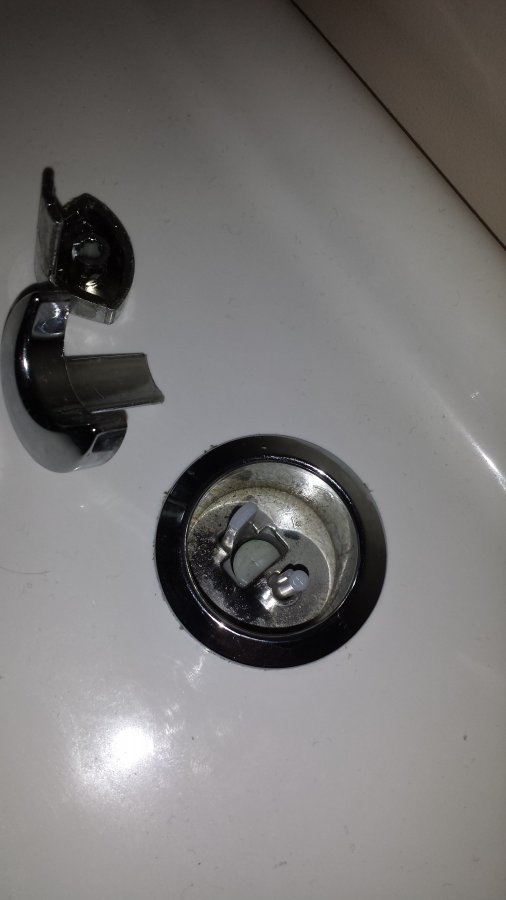

How do I get the top off this close coupled WC
26 Apr 2012
11
3
Buckinghamshire
I need to replace the washer on the ball valve of my WC. I cannot work out how to get the top off the cistern. It's not the cable type button assembly as it won't lift off so I took the buttons out expecting to find a screw inside the housing
This is what I found. How do i get this off?
Cheers
Steve
Looks like mine. The outer chrome bezel unscrews on it. Nothing to grip it but it should be just finger tight.
Two fingers of each hand on 3&9 o' clock of inner aperture... Rotate anti-clockwise...(y)
