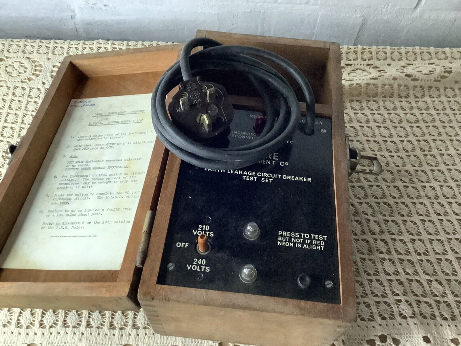

Oh dear, I suppose with the old ELCB-v there may have been a point, I never ever tested one, not even seen a tester other than pictures Clare ELCB tester3.jpg looks the part, but never used one. Must have missed that day in collage.
Oh dear, I suppose with the old ELCB-v there may have been a point ...
I rather doubt it - I've always felt that the "-v" of ELCB-v (or the "VO" of VOELB) is really a bit misleading, since what actually 'operates' them (essentially a solenoid) is the current through their coil, the 'v' (or 'VO') being the voltage generated across the coil by the current flowing through the impedance of the coil.
