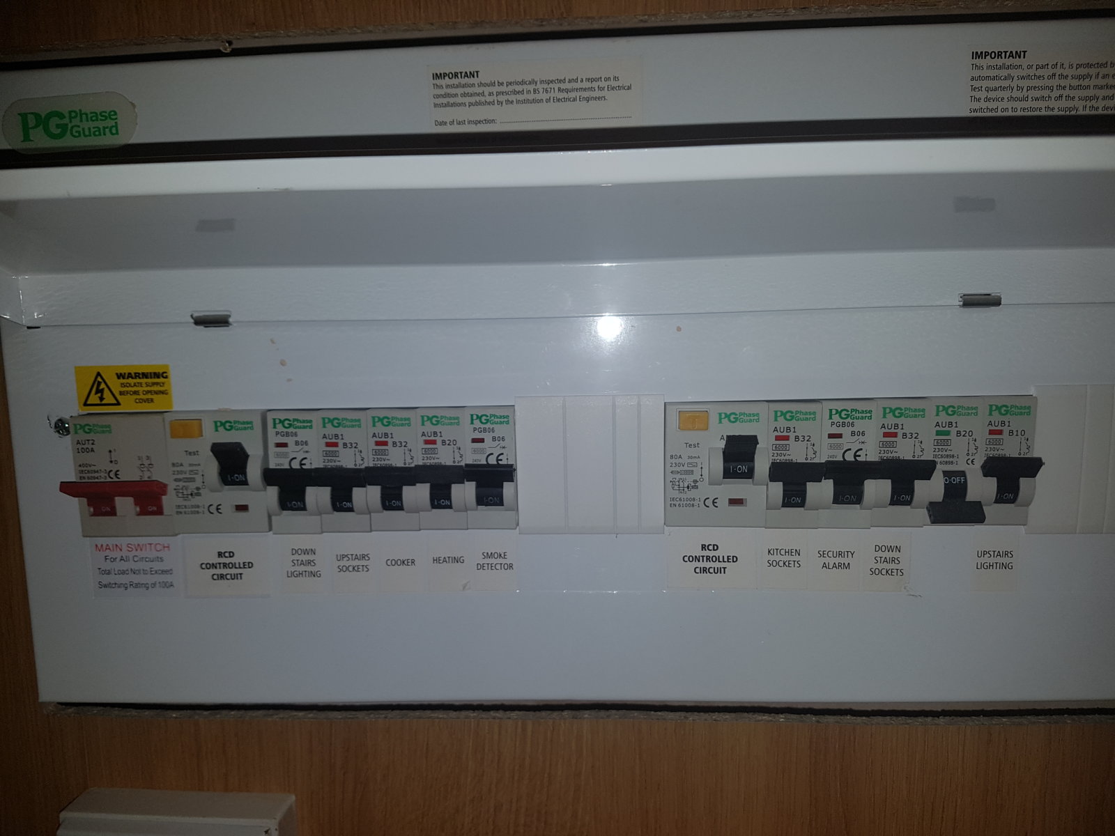

I'm thinking about getting an electric car charging point installed. My issue is that it would be fairly easy to run cables from the consumer unit to the outside of the house where the charging point would go, however if the cables needed to be run from the electric meter it would be pretty much impossible to do ( would have to pull up tiled floors etc).
So I wondered if anyone could tell me whether it's possible to run the cables from my existing consumer unit? I've attached a photo of the consumer unit but if anyone needs any more information in order to answer this please let me know and I can reply.

If a suitable double pole RCBO can be obtained to fit that consumer unit then possibly.
If not, then no. Another consumer unit is required either adjacent to that one, or in some other location.
Without having looked at the requirements for EV charging, could one not fit a large MCB (Say 50A) to feed a 2P RCBO in a dedicated enclosure?

What I'm really asking here is, can the EV point be run from something in or near the existing consumer unit (picture attached to my original post). Whether that is another consumer unit or an RCBO in the existing unit or whatever is fine, but the point is that it will be easy enough to run cables to the charging point from the area where that consumer unit is located, but the meter is in a different room which will be impossible to run a cable from

In my opinion there is enough space in your consumer unit to be be able to connect your EV point there, your electrician will be the person to make the final decision.
What is the grey box just in the bottom of the picture?

The installation needs to comply with Section 722 (and also ideally the Code of Practice) so it's not as simple as that.
I looked for Phase Guard RCBO and could only find type A, and the consumer unit would need to either have a third neutral bar, or converter to all RCBO, I have the same problem with a CP Electrical consumer unit, except for 6A where you can get type AC the only RCBO I can get is type A. Never even thought about it when it went in.
Given the Type AC RCCBs in the picture I'm not sure whether that is a typo on your part.
It will require at least a Type A RCD (including RCBOs) - but in some circumstances the requirement will be for a Type B. The RCD (including RCBOs) MUST break ALL LIVE CONDUCTORS also, and be dedicated (i.e. not shared with anything else).
I wouldn't hugely fancy the chances with what's there. The most likely option would be a separate dedicated DB for the EVSE.
Yes typo all I found was type AC but from @markyd1 post it seems it does not matter, the HappiZappi car charger it seems does it all, however it is how to take the power from the CU needs a cable able to take full supply to house and although the electrician in @markyd1 video connects it to the henley bloc I am not so sure that is a good idea, normally we aim for a single isolation point.
