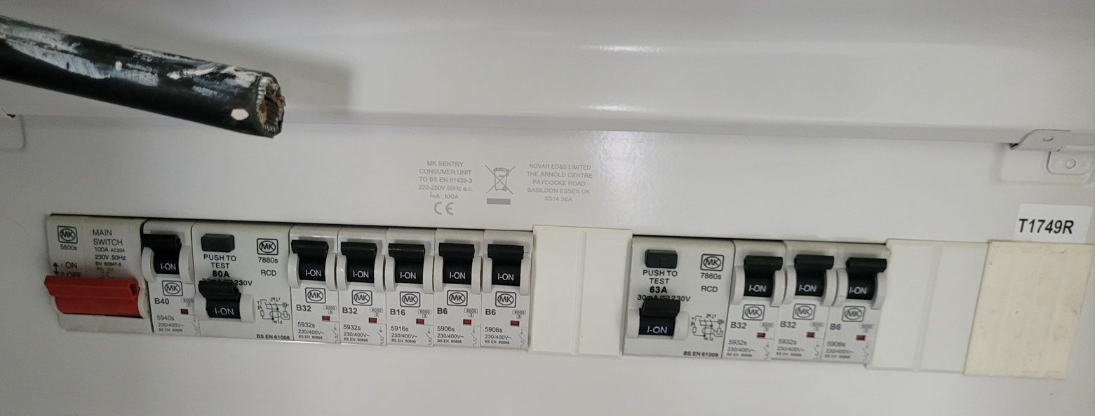

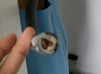

I would like to buy a consumer unit for my garage where a 17mm thick 3-core SWA cable has been left by the previous owners. The other side of the cable is at the main consumer unit, This cable is currently not connected at either ends. Does 17mm overall cable thickness give any indication of thickness of cores inside?
The requirements for the garage are:
1. Couple of interior LED battens
2. Two interior sockets
3. Two exterior sockets
4. Three exterior PIR LED flood lights
5. An Electric Garage door
6. A type 2 (7 KW) EV charger
7. Future capacity for an extension above the garage (should be ~6 sockets and spot lights)
Can someone please help me get the right consumer unit? I am especially concerned about the EV charger and want to get the correct setup for EV installation in the near future.
A picture of main consumer unit added, please note that there are no electric showers or electric cooker in the house.
Many thanks in advance.

Normally one can find the size of the cable written on its side, however as far as EV charging goes some how it needs to monitor how much power the rest of the installation is using.

One with a main switch, surge protection of the required type, a quantity of RCBOs one for each circuit, and several blanks to fill the spare ways.
However you buying a consumer unit and expecting someone else to install it is not going to work.
Neither is you installing it and expecting someone else to test and notify the installation.
2. Anything to add/ modify on the main consumer unit?
Sling it away and replace with a new one.
Or possibly modify the existing one to add surge protection and somewhere to connect the armoured cable for the garage. As none of the circuits are labelled, impossible to know without further investigation. Many other details missing such as the type and size of the supply, connected loads, is equipotential bonding present and correct, size type, length, condition of that cable to the garage and so on.
This isn’t really DIY work and EV points have a whole section of the regs dedicated to them
My advice would be to locate a local spark WHO DOES EV points and use them

The armoured cable is 3-core 6mm one. The current consumer unit could be as far as 8-10 meters from the new planned consumer unit in the garage.

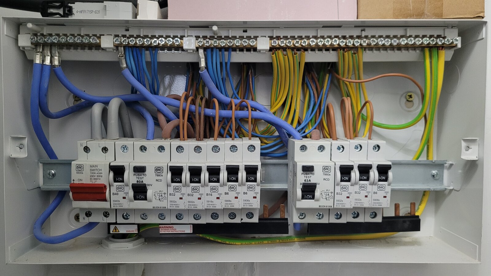

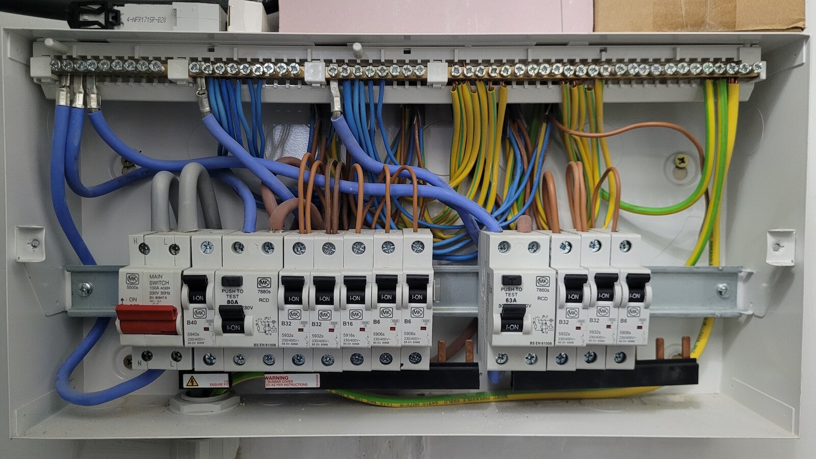

Attaching a pic of the main consumer unit with face off. As you can see there is plenty of space for SPD. Can the armoured cable can go to 40A MCB which is blank?

I see no reason not to use the existing 40 amp MCB. And since consumer unit is metal, a SWA gland should not be a problem direct into the CU. As to if re-energising an old circuit is considered as a new circuit, you read the part P yourself and make up your own mind.
To my mind if you have the skill to complete the installation certificate then there is really no problem, they are a free down load from the IET web site. It details what you need to test, by having boxes to enter the results.
