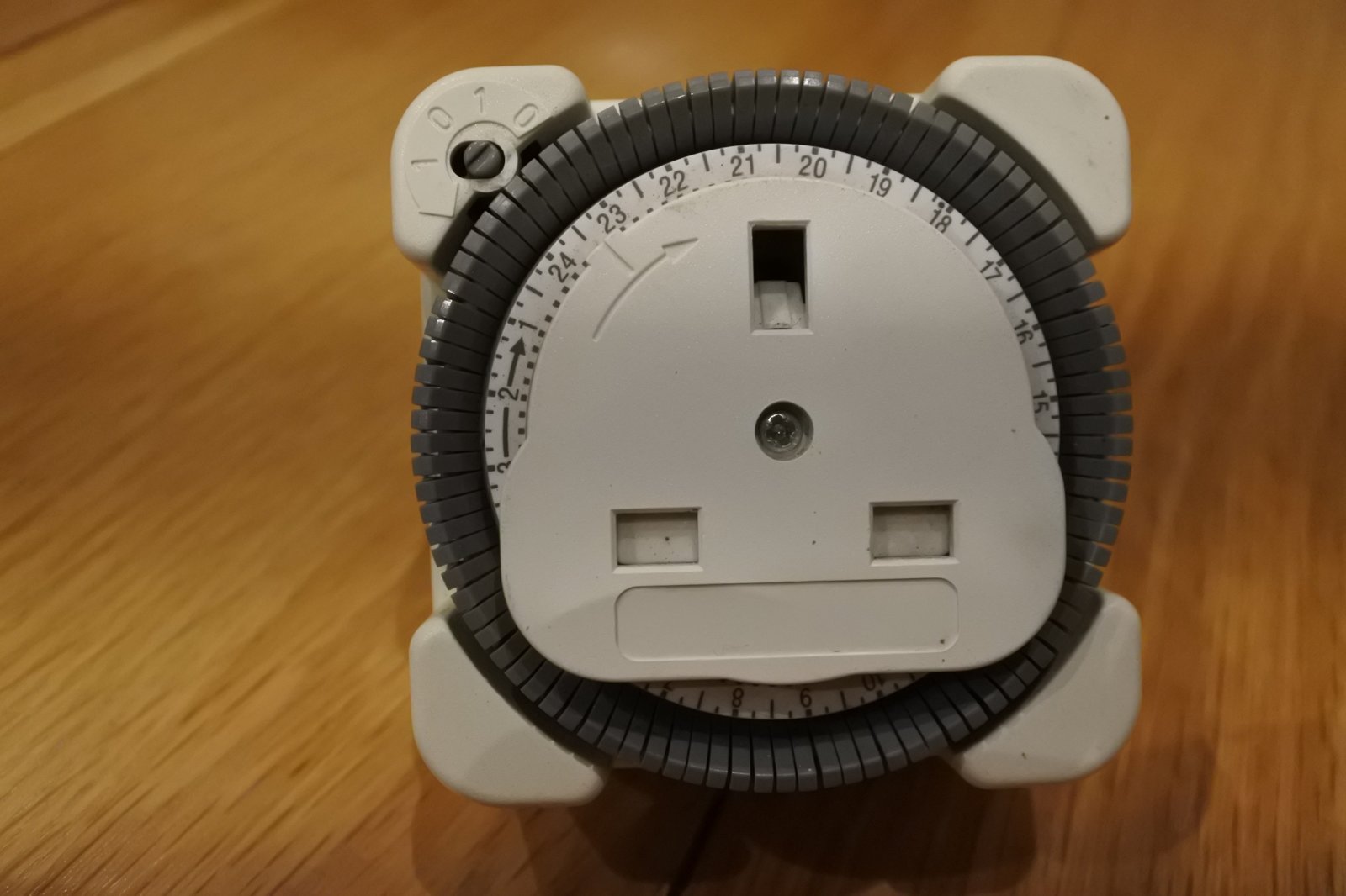

All,
Please see attached photos of a mechanical timer plug. Unfortunately I have no instructions and cannot identify the manufacturer.
I would be very grateful if someone could provide guidance on how this plug is operated.
Many thanks
Paul

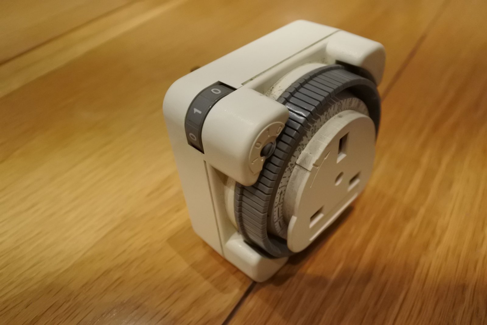

The small black segements can be moved in and out to "turn the power on & off". Best plug it in and see whether in or out is off or on if that makes sense!
Thanks Chivers, I am having trouble with the dial(s) on the corner (which say 1 and 0)
The slot in the bit that rotates points at either "1" or "0" to indicate whether the switch is in the "on" or "off" state respectively (i.e. pointing at "1" means "on")
Kind Regards, John
No need - just move some of the segments to a different position, rotate it by hand and see what causes the cam in the corner to go from on to off and off to on.

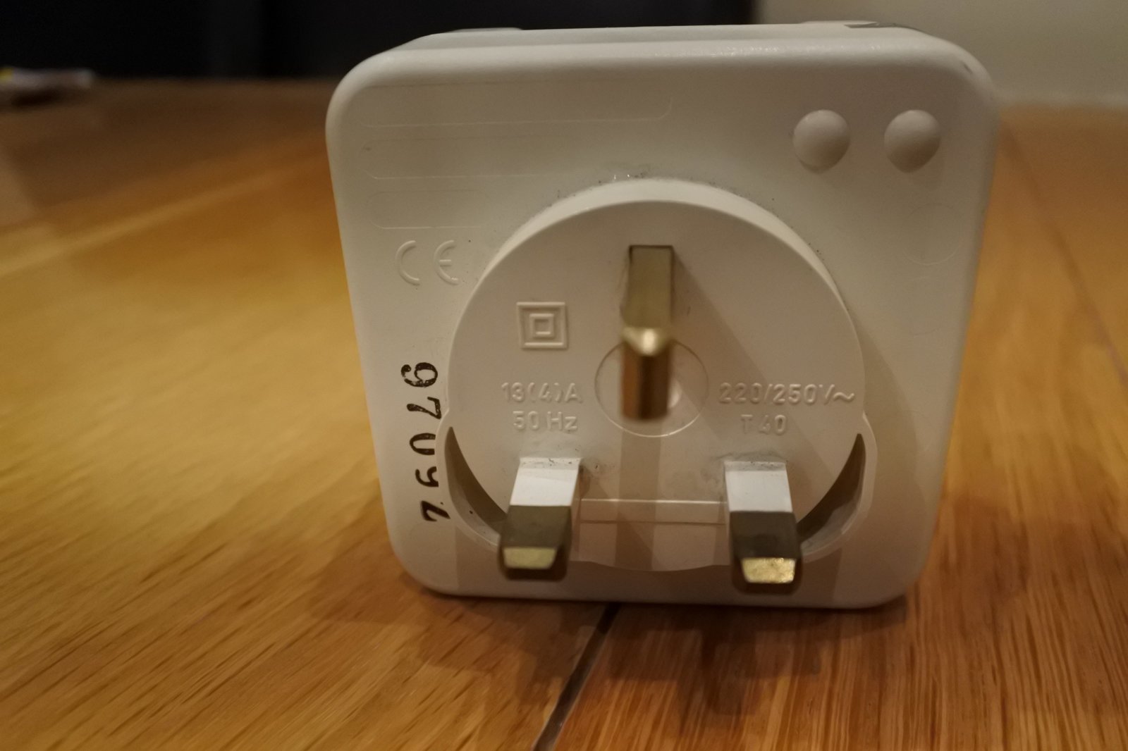

With the stamped number suggesting it dates from 1997, must be worth buying a new one at the supermarket.
