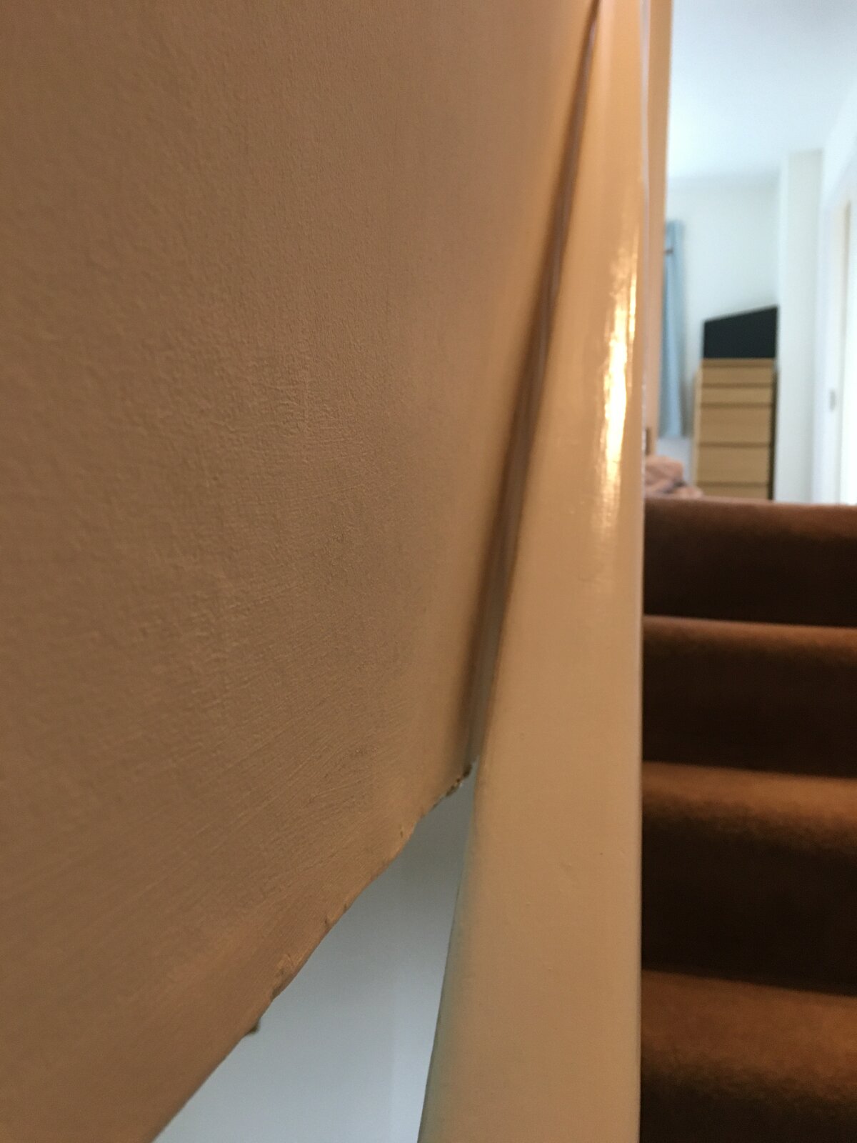

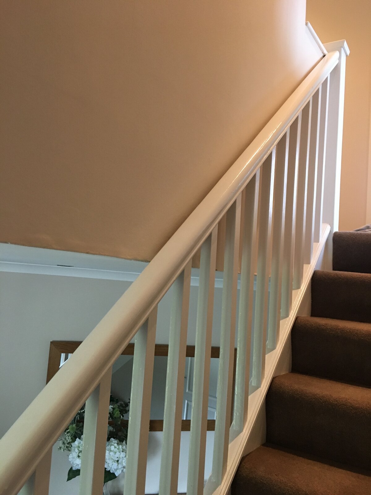

How do I trim this hand rail in place?
7 Oct 2014
237
39
West Lothian
We replaced our banister but the new hand rail is wider and now fingers can’t fit between it and the ceiling/floor at the top. As a result my aging mum has nothing to hold on to.
Is there a tool or technique to take 1/2 inch off the side of the hand rail so close to the wall?
Thanks all

Sounds like you need to remove it, use a router to remove a section then repaint and refit.
Router.
A good diyer would've thought of this problem before buying a different size handrail, but it happens to the best.
Is the wall a solid one or studwork?
Someone could cut that handrail using a tracksaw, widening the gap but it would be messy, and need hand work as well.
Short of removing the whole thing, the easiest is to add either a second slim handrail parallel with the first, possibly using the spindles as support (I've done this) or a second slim handrail screwed to the wall but slightly higher than the existing one (so a "step" )
Another option could be a cord/rope running along the wall above the bad part.
Router.
Just realised this is not an easy handrail on wall brackets.
Well, that's quite a problem as no router will fit that close to the wall.
Multitool might work but you need a very steady hand.
Who fitted this?
Cut it at the top of the stairs where it meets the newel post, pull it away from the wall enough to get your hand in then re-attach it.
