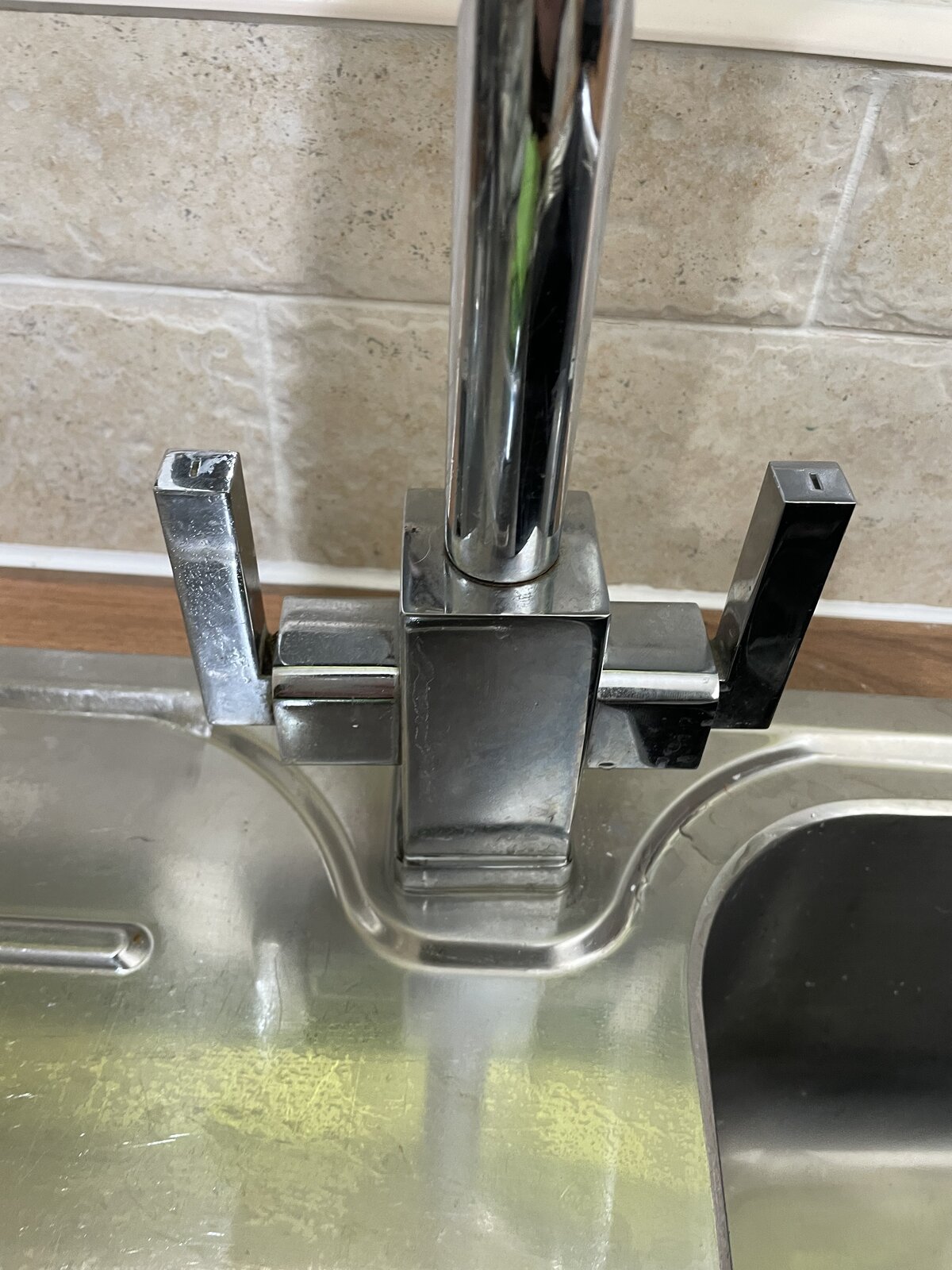

How do you access the cartridge on a tap like this?
12 Dec 2014
144
5
Birmingham
This is leaking at the handle so I think the ceramic cartridge needs replacing. How do I get to it?
Look/feel for a grub screw, it may be covered with a cap that needs prising off.
Blup
At the bottom of the handle at the shroud, feel on the back of it, that may be the place for the grub screw, loosen that and the handle should pull off, then the shroud that should give you access to the ceramic valve.
Thanks. I'll check again when I get home. I couldn't feel or see one, even using a mirror, but I might have missed it.
Maybe not, wouldn't be the first I've come across handle that just pull off, if you absolutely can't see any grub screws either at the back or on the side of the handle then logic suggests they can only pull off
