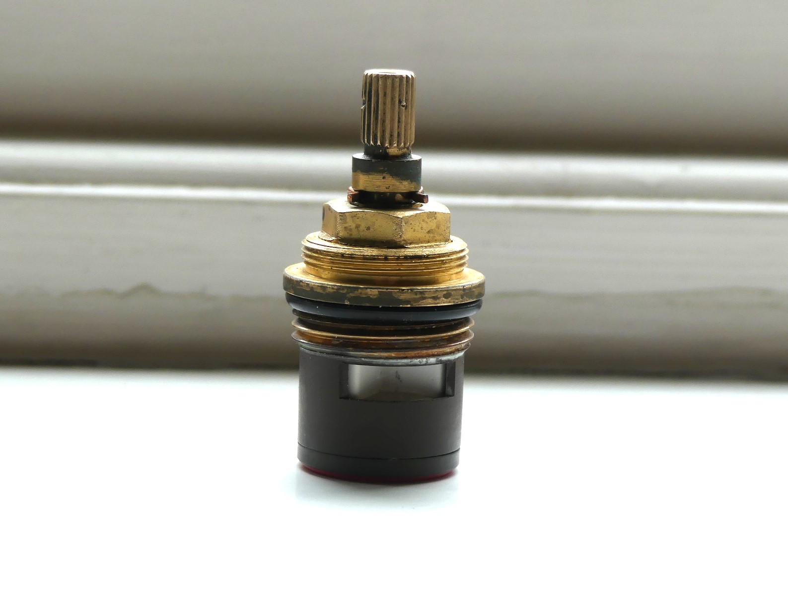

Hello. Is there any sort of standard coding for ceramic cartridges? I have the measurements for a 20-spine, 3/4 cartridge but there appear to be various choices with slightly different sizes. I do not know the name of the mixer taps the cartridge belongs to.
I have attached an image of the cartridge.
Thanks.

Best of luck mate, but tapmasters, divapor and lunns are good providers.
You need to be spot on with your measurements and spline count though......even one spline difference will screw things up.
