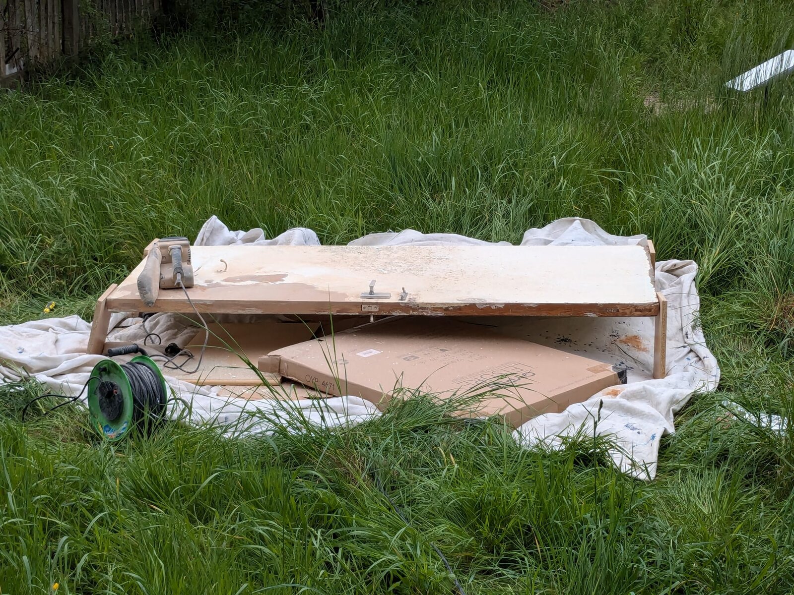

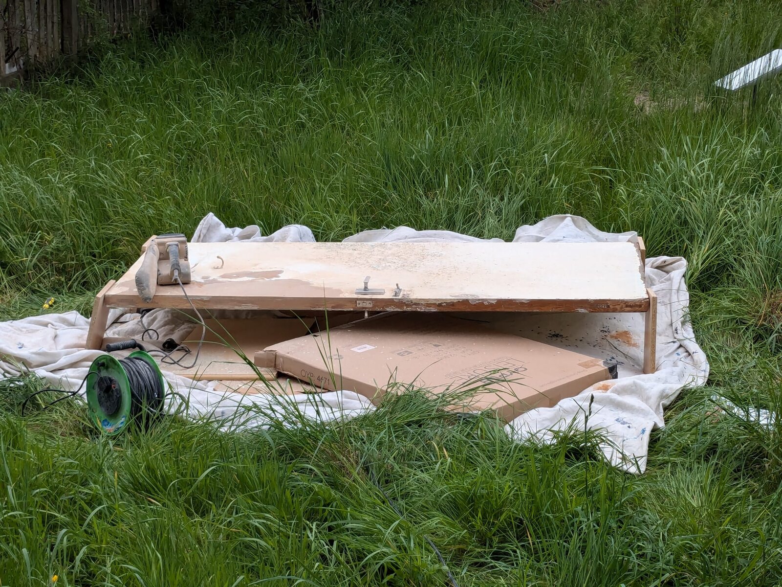

I'm doing it! See attached
Some things i have discovered in the process
1. Doors are MUCH heavier than i thought, its about twice the weight i expected
2. Screws are weaker than i thought. The door is connected to each leg with one of these:
And three times now, a screw has bent
3. This arrangement is not very stable, the legs dont hold up incredibly well if the door is pushed against them. Maybe i needed some cross slats to stabilise them, I cut up a big panel of plywood which was about 40x60cm, into quarters
I am managing though, its not perfect but im getting there
