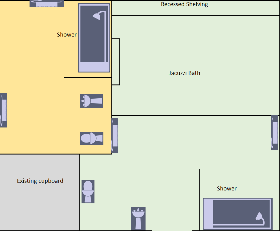

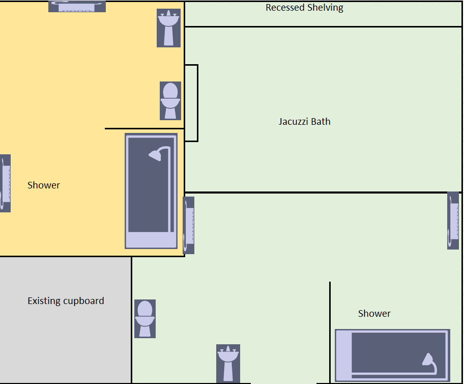

I see the logic and it had not escaped me that might be easier but the proposed configuration for that area is a walk in shower.
This was the proposed
but I guess that could be reconfigures to the below to more align the toilets.

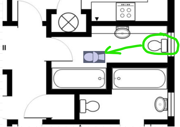

Red dots are current soil pipes going downstairs through the building. Yellow dots are potential locations for new toilets. Green lines are potential soil pipes connecting potential new toilets to existing soil pipes.
Any thoughts on the 3 locations ?
