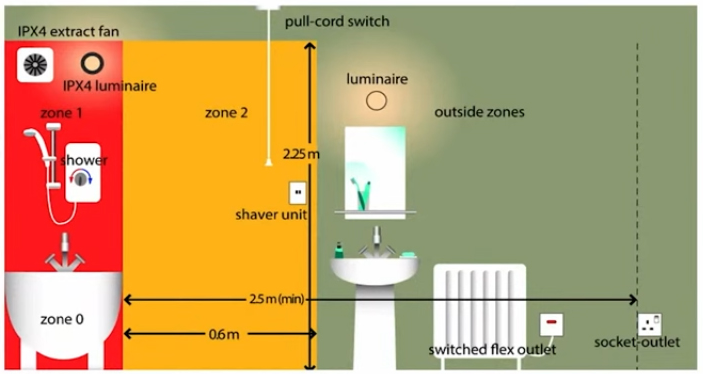

Note socket outlet now 2.5 meters not 3 meters. Not only this forum but simple internet search, we are likely to get wrong info for ages.
Need to skip a bit either end, but some interesting changes.
