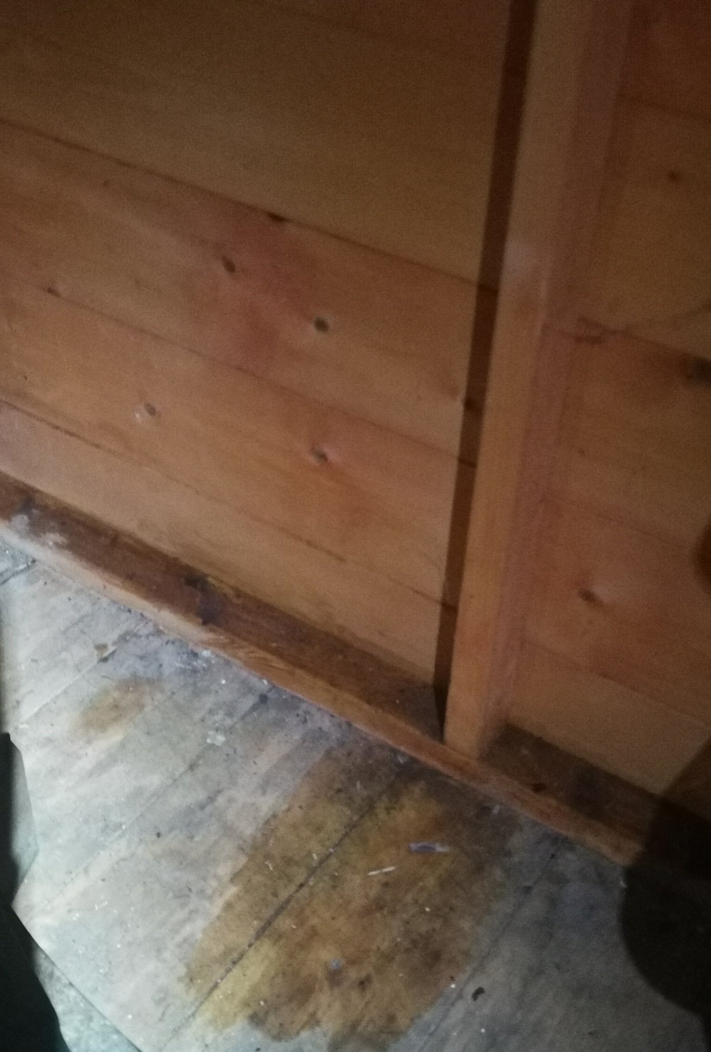

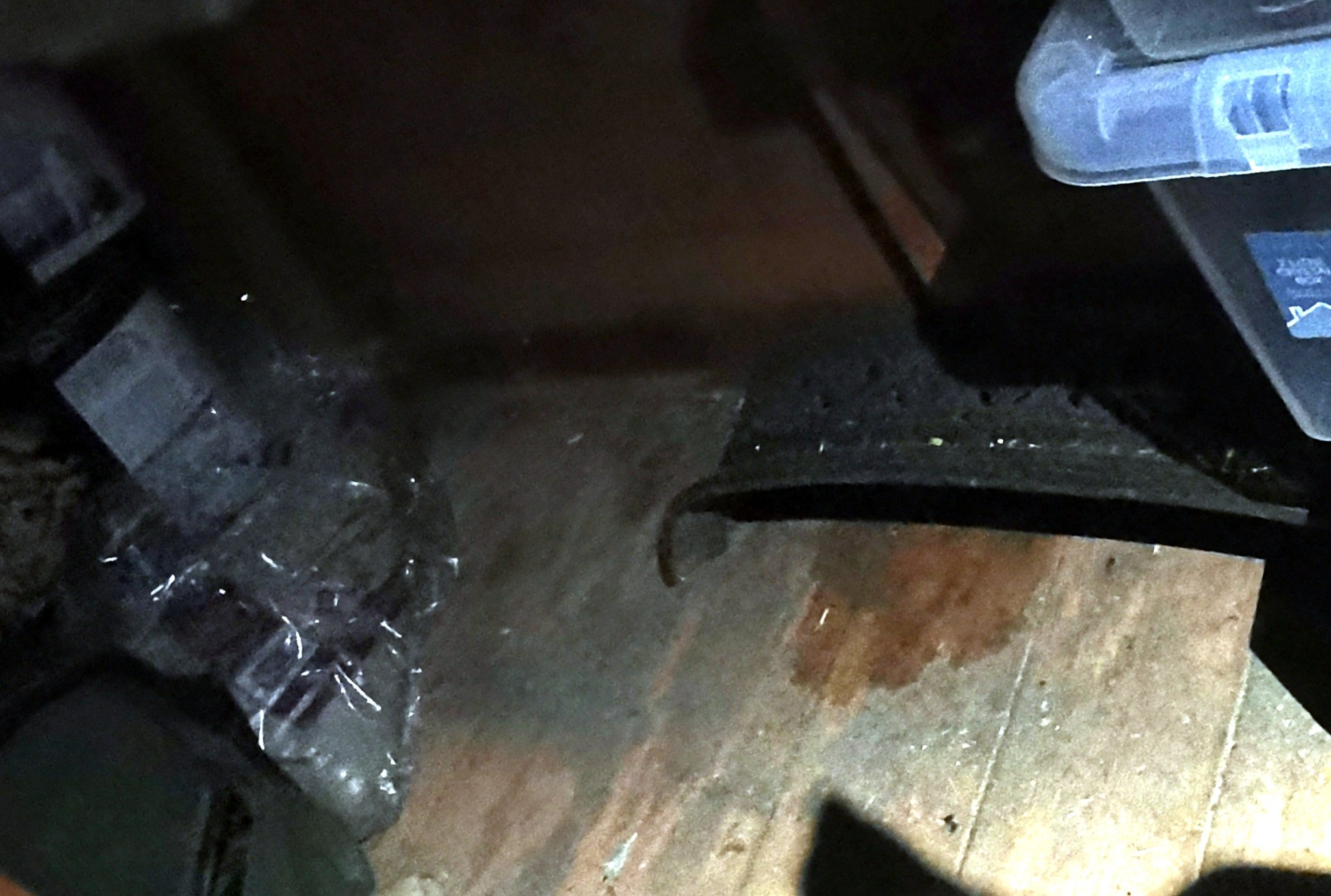

How is water getting in my shed ?

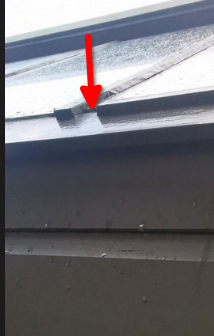

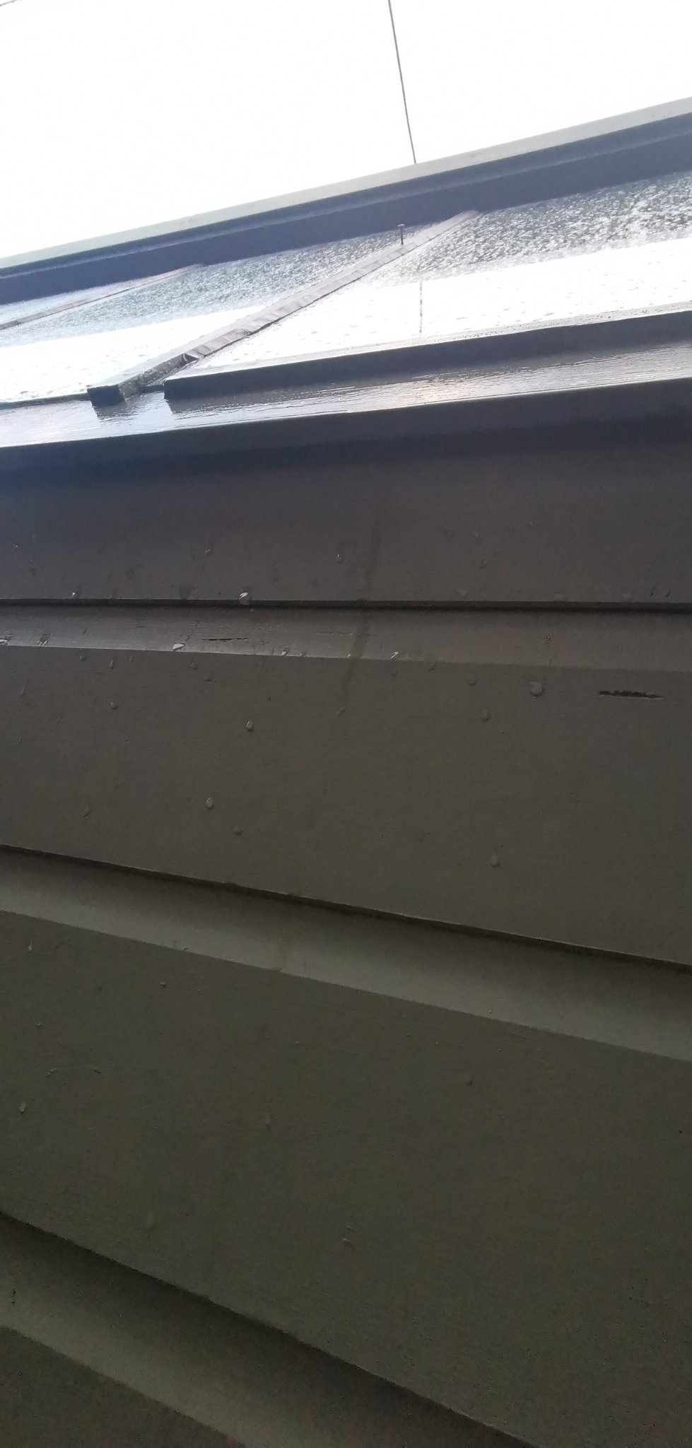

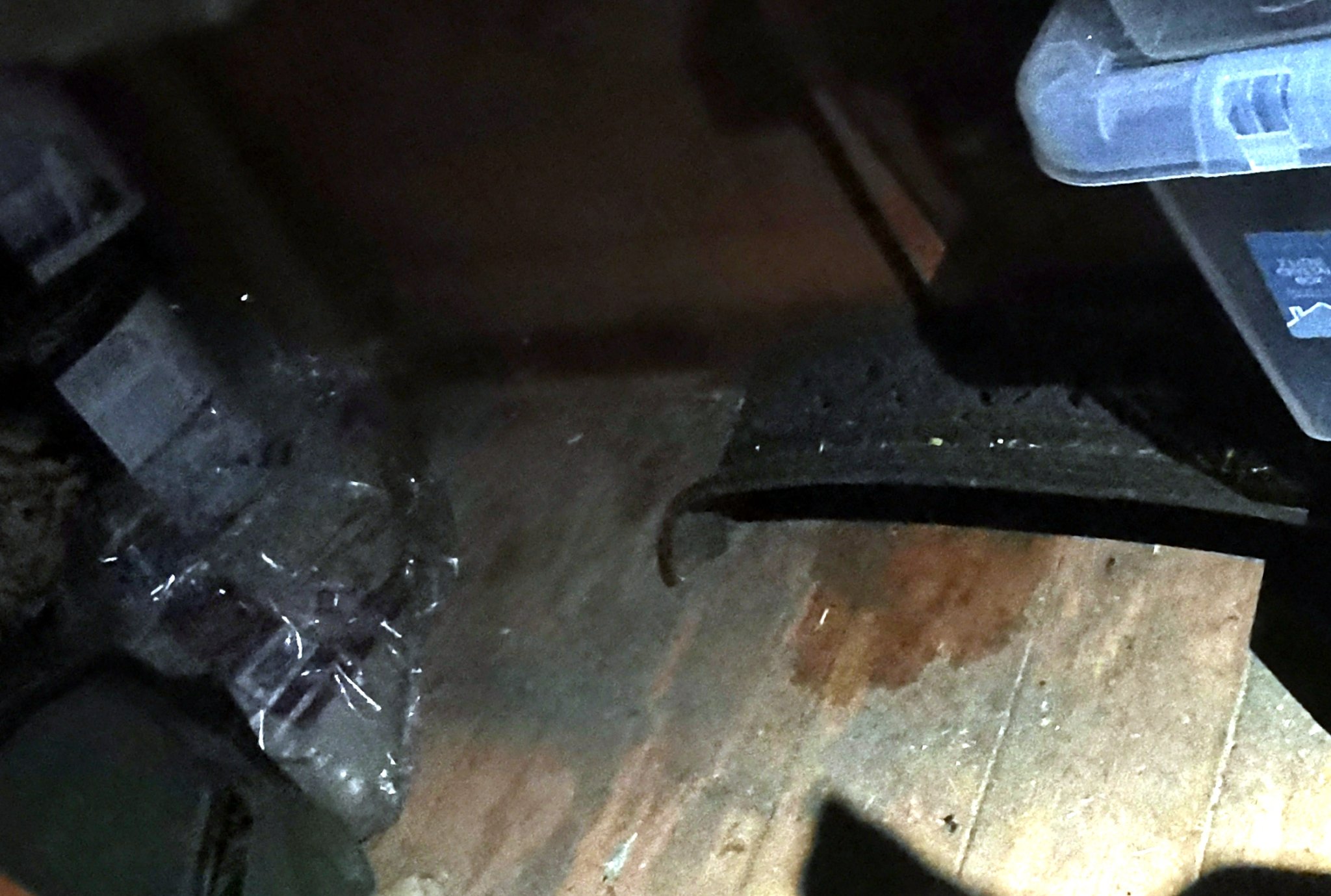

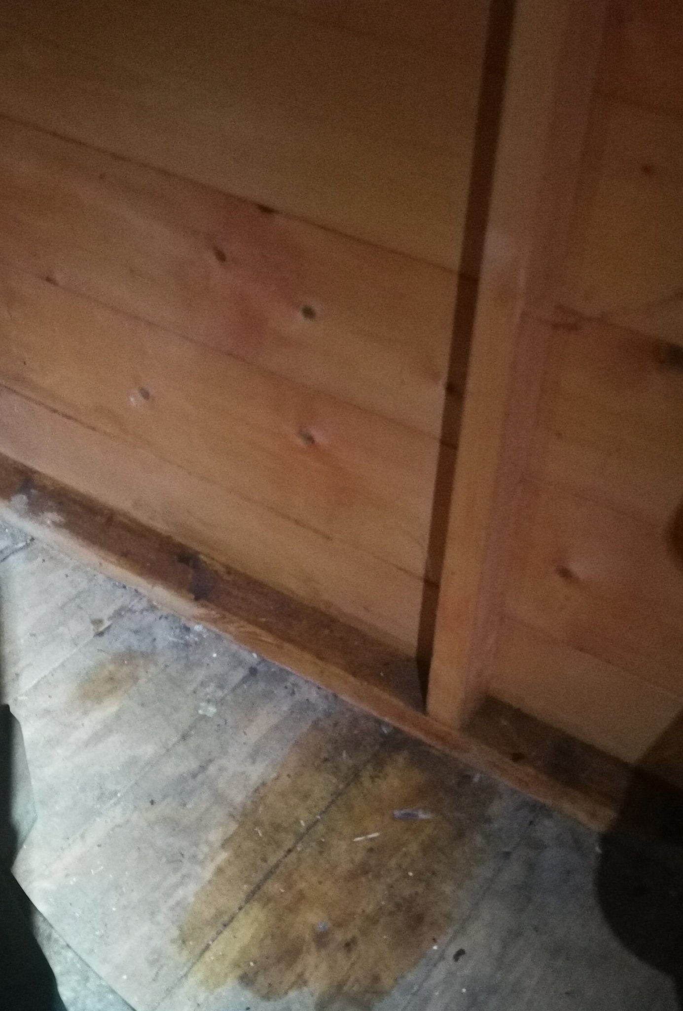

It is coming in some other way and not capillary otherwise it would be wet on the floor as well as the raised bit that is adjacent to the outer panels. It has got worse and water is coming down from underneath the potting bench, but above the bench it is dry. The stain you can see is dry and from oil. I have taken a shot of the overhang in the same spot the water is trickling down from inside. It wouldn't be possible for water to get in there. It has been exceptionally wet the last few weeks and the area is very damp with no airflow (unless I open the gate) so I am hoping it will all dry out come Spring/Summer. It's also very cluttered in there and I have been storing logs in the area (it was quite wet before I put them in mind) I shall treat the waterlogged inside with cooking oil when dry to stop it rotting in the future.

It's not from underneath, it's coming from higher up.
Perhaps it's both.

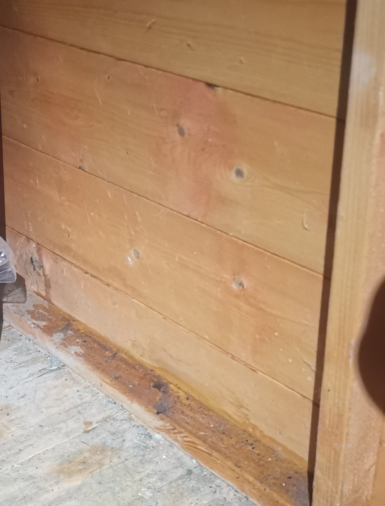

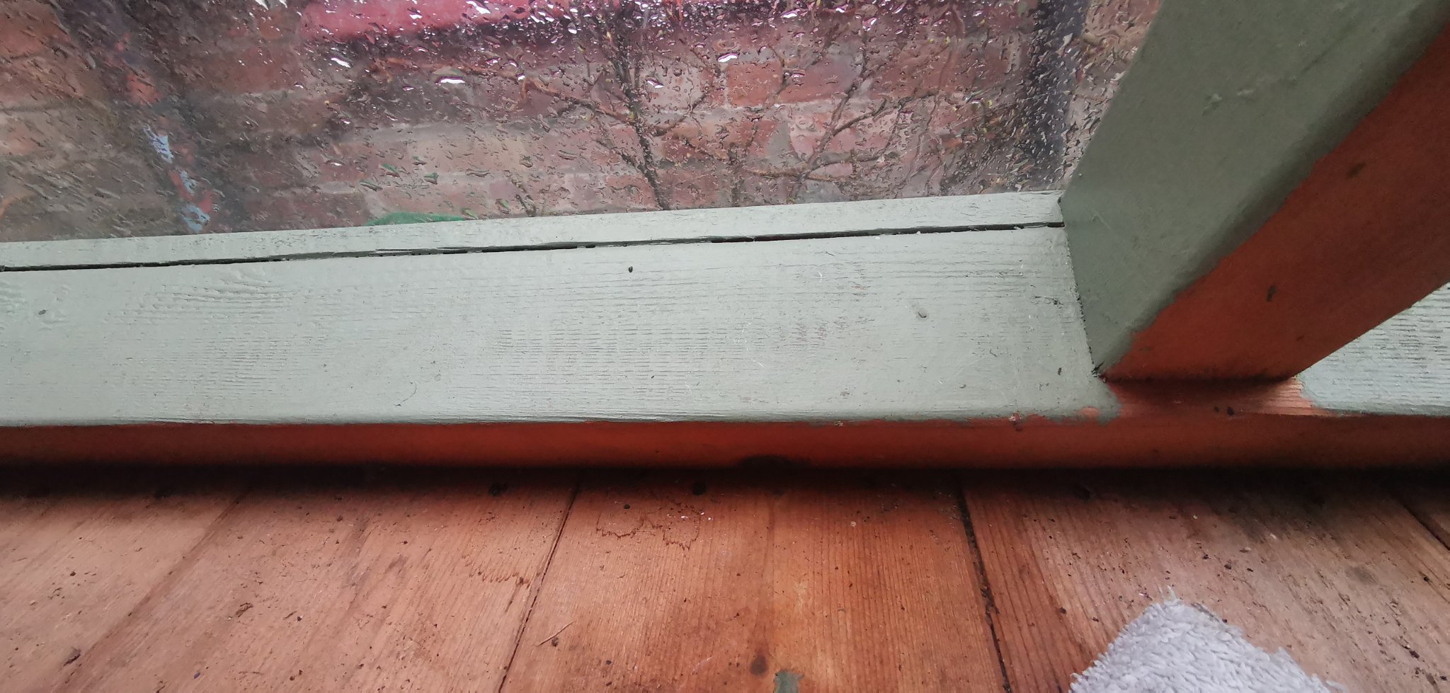

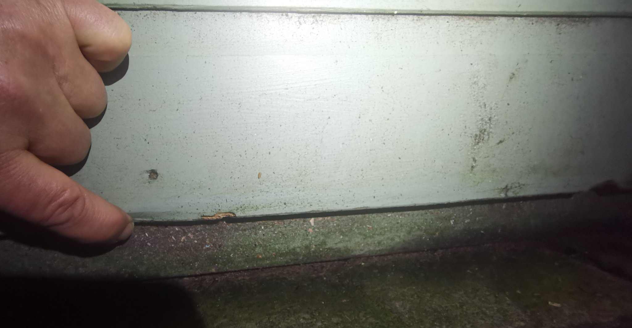

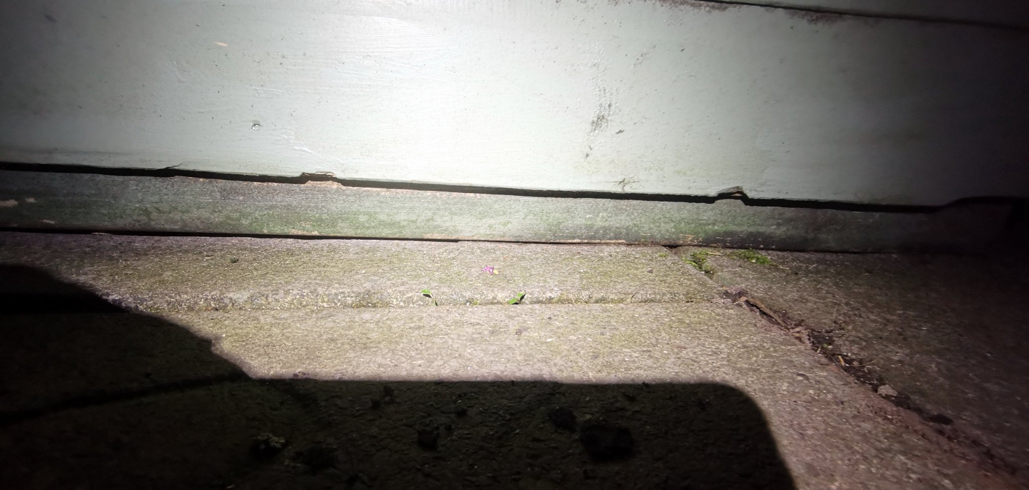

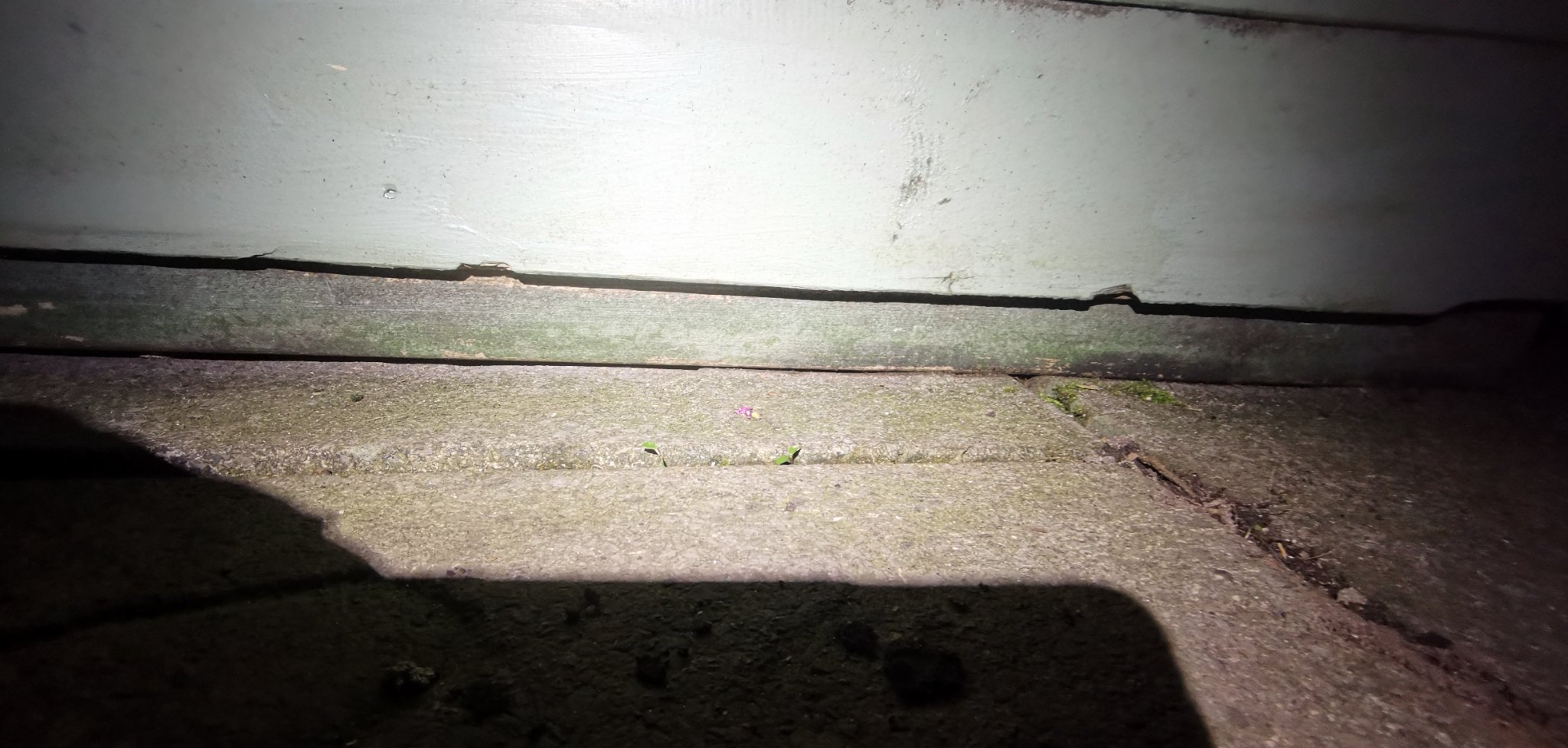

IMG_20260208_174542.jpg - what's that vertical face below the T&G but above the flag? Whatever it is is damp enough for algae to grow on it. It is either the bottom of your shed, or in contact with it, and it looks damp.
IMG_20260208_174758_edit_859851493546919.jpg - the moisture is clearly working its way up that bit of T&G from below.

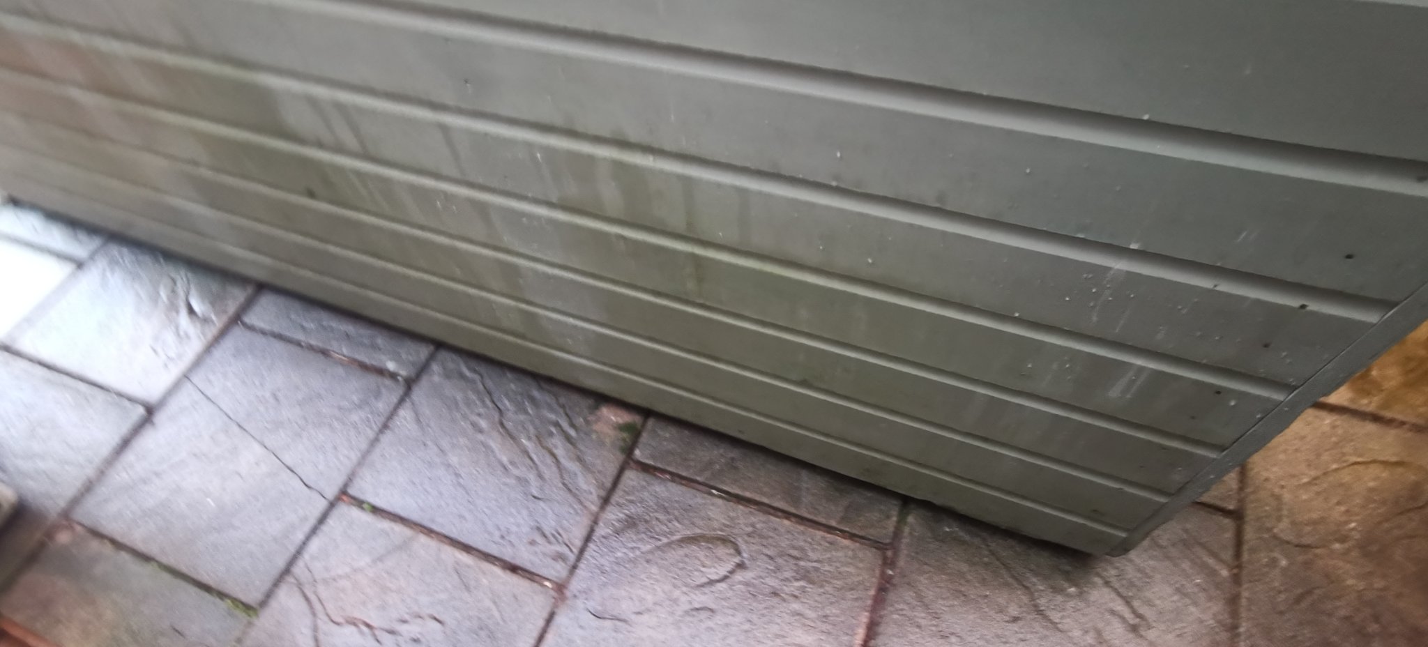

IMG_20260211_164234.jpg - You've got water clinging to the cladding on the outside. Painted timber is not impermeable forever, it will expand and contract, small cracks in the paint will open, moisture will be let in, etc. Also, think about what happens to the water when it has run down to the bottom of the cladding. It will stay there for a bit and if the underside isn't treated then it will be absorbed into the timber.

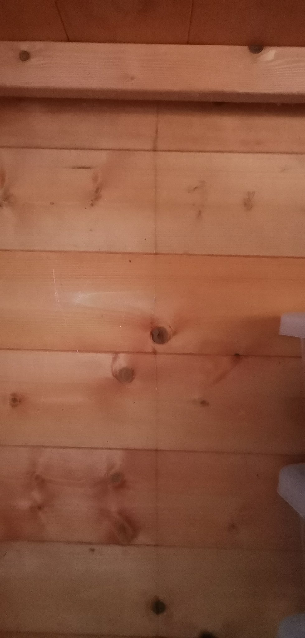

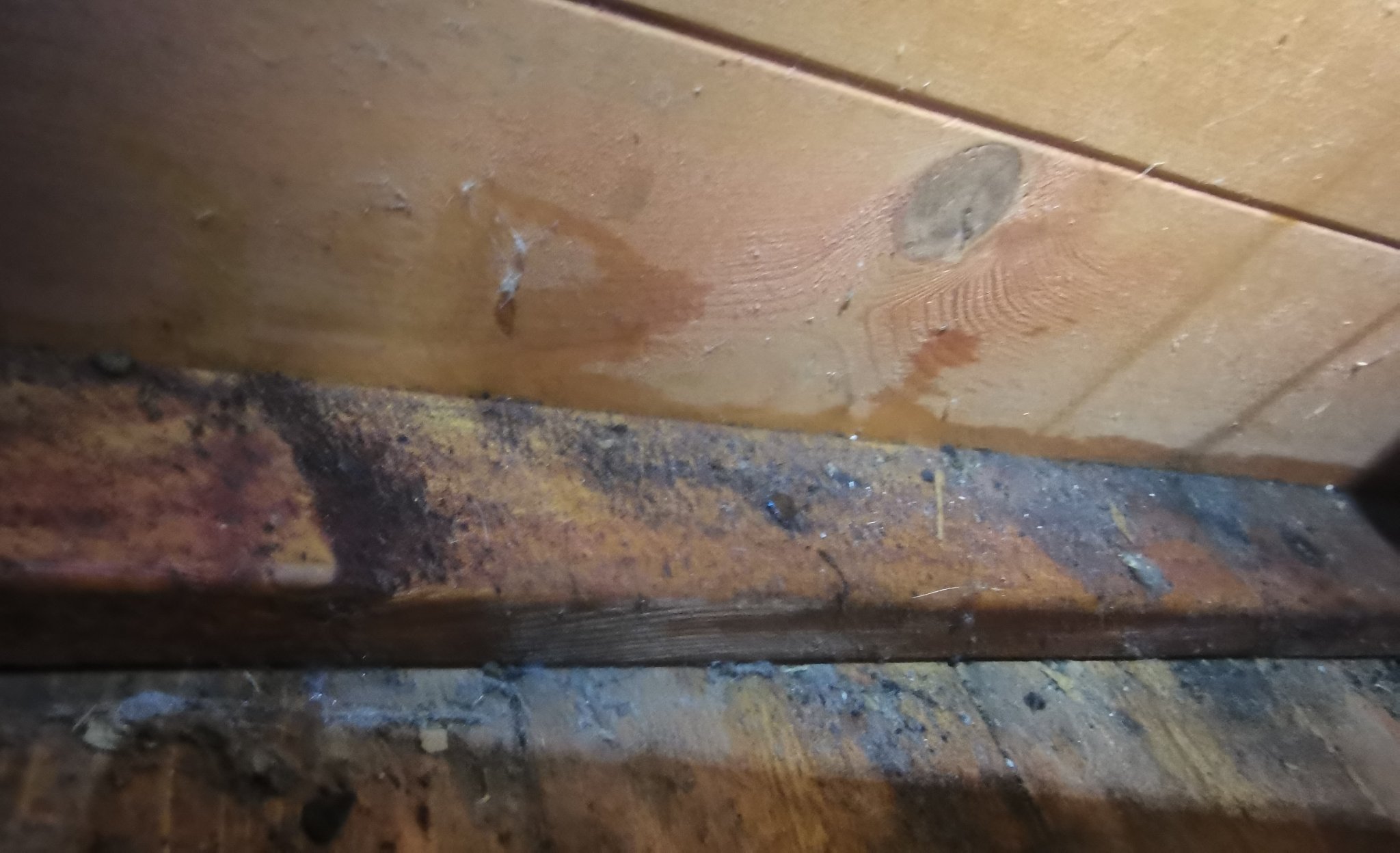

If water can get in here then I can see it might run down the inside:
It's not running down the inside as just gone out (sorry the images are not great as just spotted this in the dark, and the shed is in need of de-cluttering.) The base of the shed it stands on is sound and yet above that it has seeped into the inside. The very bottom edge of the cladding is dry with rot. Absolutely shouldn't happen as painted with weatherseal and stood on paving. I shall just give it a good dollop of more paint thickly applied at the base so no rain splashes etc will get in. Perhaps lift a slap and get stones under it for drainage.
I have to say it's driving me mad!
