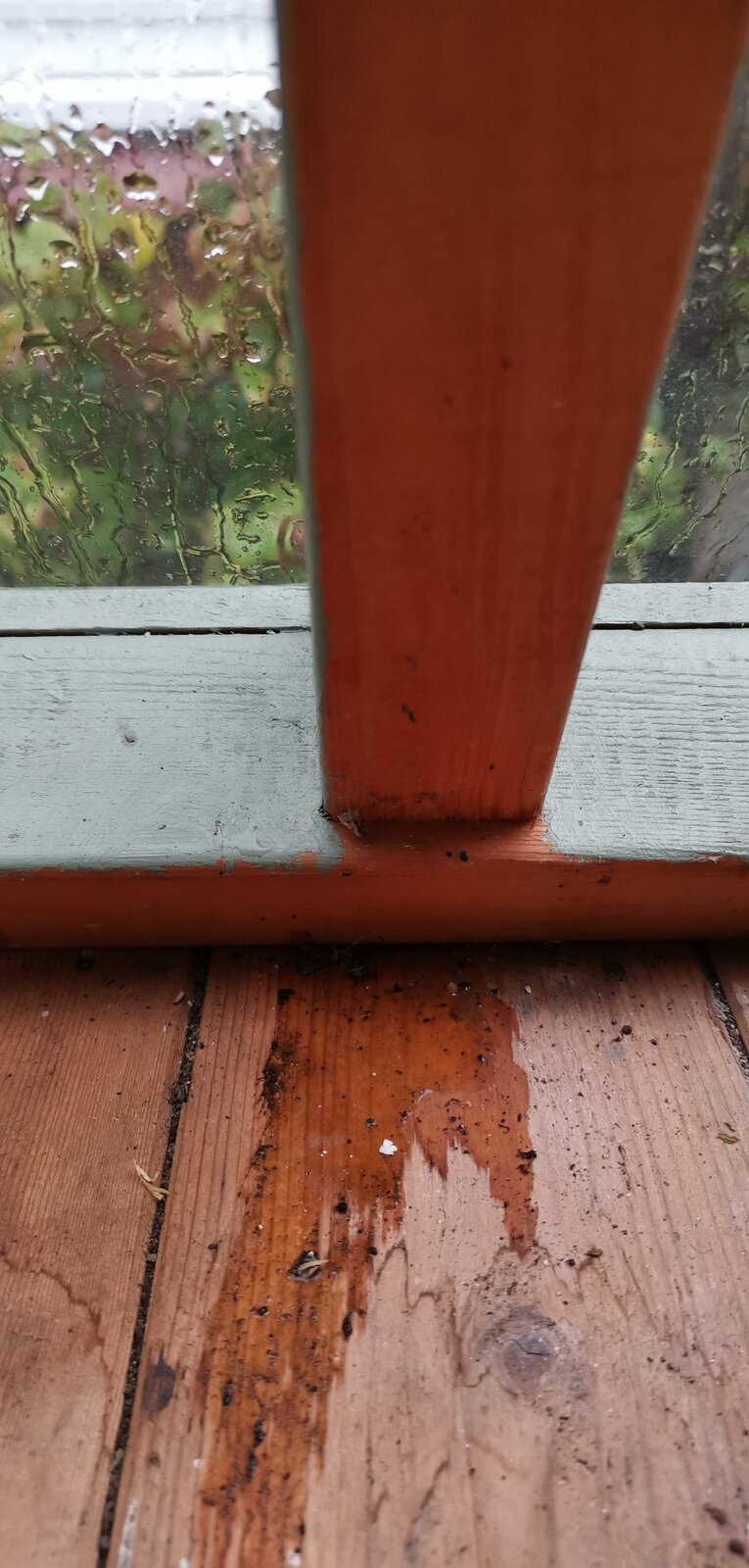

I absolutely can't fathom how this water is getting into my potting shed. The outside is sound with no visible way water can get in. I have felt underneath the bench and can't feel any water of moisture. I know the putty in the glass is a bit poor (my bad) BUT from the inside there are no signs of it coming from that with runs or drips. It just seems to pool where you can see which defies logic and physics as the outside has a wooden overhang. I tell you, nearly all my diy issues are with water being where it shouldn't. It's exasperating.

I'd guess water is running down the window panes, and then running back on itself.......seal the left and right gap next to that vertical piece of timber.

Thanks John but I can't see any evidence of it running down from anywhere. When I had perspex just sitting on the wood with tacks holding it on (no sealant) I had no issues with capillary action. It seems installing glass and putty has caused so many problems.
Capillary action is the reason and as Burnerman said you need to seal under the glass. The green mould / algae shows that moisture is getting behind the glass too so that would be a good point to start and see how it fares.

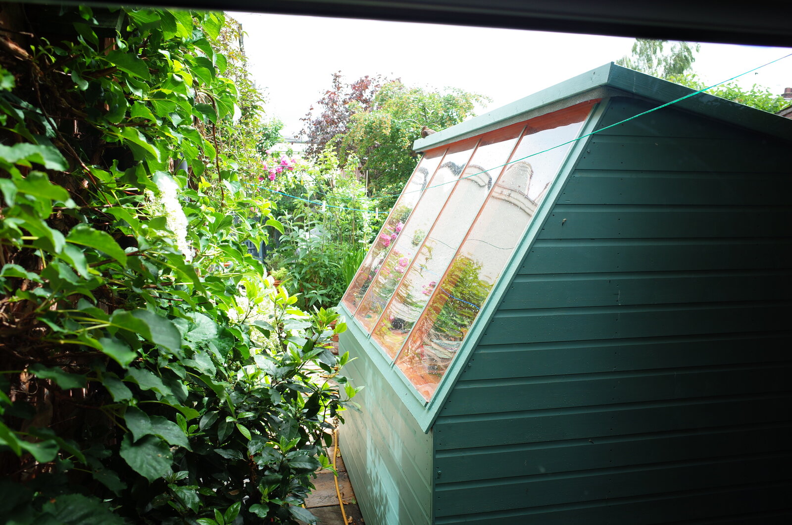

can you show me a picture off the outside off the glazing where it meets the cladding below the glazing??
i fixed my neighbour's shed leak as the glazing was set back and any water running down the window met the back off the cladding[glazing overlapped and fixed to cladding back] as no cill was fitted
I can assure you there is absolutely no water running down from the glass anywhere inside. No traces as completely dry but it seeps in as you can see. Even outside I can't see any evidence and it's only this one area out of 4 panes. So frustrating.
Here is a better shot of the exterior taken 5 years ago showing the overhang

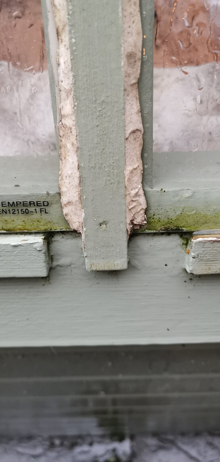

We can all discuss this from now until Xmas but you need to actually try something to stop it so start with sealing under the glass, if that doesn't work then consider looking at the putty and perhaps replacing it with sealant which , to be honest, is probably better for a shed given they are generally prone to movement with people and wind unlike house glazing. Keep eliminating possible causes until you fix it or it may just be you have a Woodlouse with a bed wetting problem.
Taking the putty out would be a monumental task and sealing the bottom difficult also. I have used sealent in the past and water still got in. I could paint the putty with the same Dulux weathwrseal to fill the gaps.

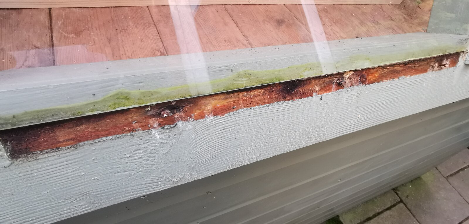

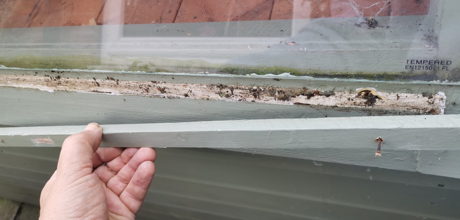

Just taken one of the ledges off and it's pretty wet. The nails are rusty so going to pull them out, treat with Ronseal wet wood rot, paint and replace ledge a bit lower.
The photo with the ledge in my hand is the repair I made only this Summer with Ronseal and wood filler. It clearly isn't working but looks like I should have Weathersealed under the wood before I nailed it on. Will treat again and try and use nails that don't rust and paint yet again with Weatherseal.

It looks like it is the "ledge" that is holding the water back so I would get shot of that and maybe replace with 2 vertical modesty blocks per pane (or something similar) with a screw through the middle.
If enough space, first tuck a length of dpc up behind the glass, just to help the water shed off

I think patch it now for getting through Autumn Winter and in Spring take glass out and start again with sealant.
