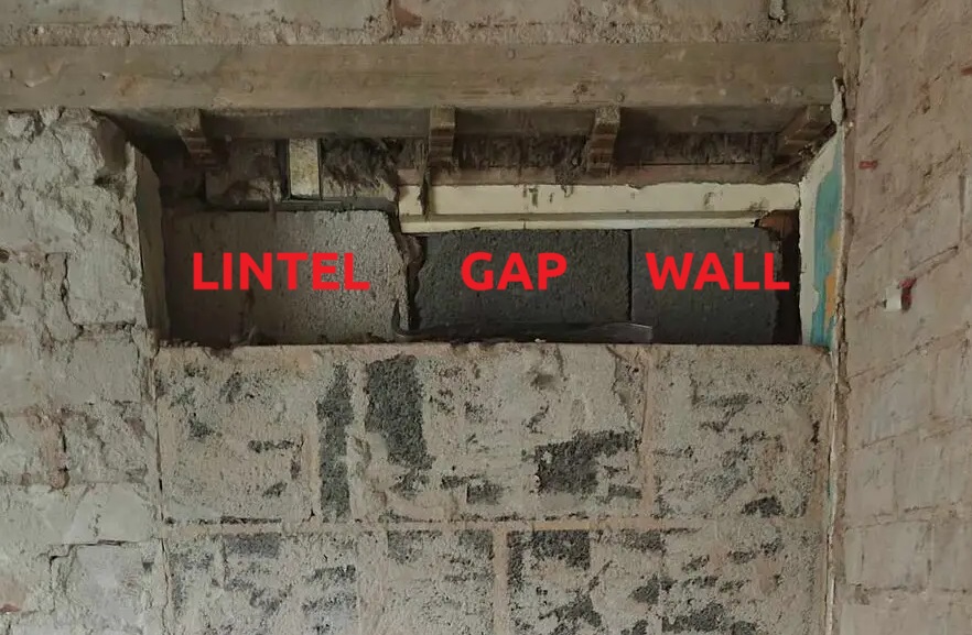

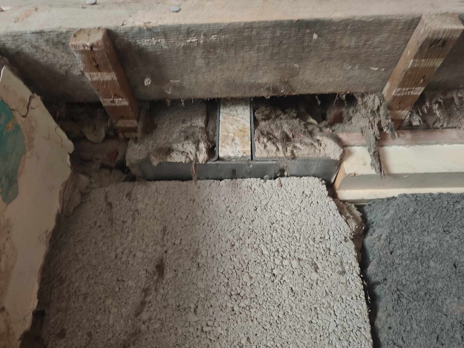

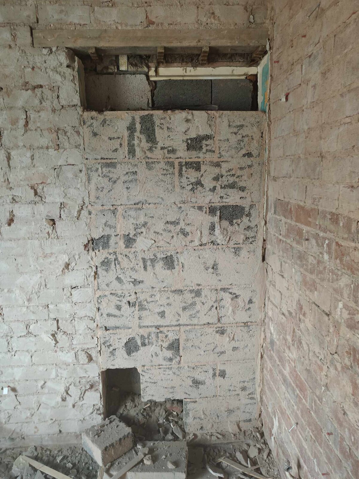

Hi everyone.
Can someone advise me how many acrow props should I use to support this beam?
I will be reopening the doorway and will install another beam under it for permanent support.
I have 2 acrow props and I wanted to check if they will be enough.

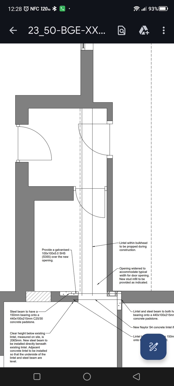

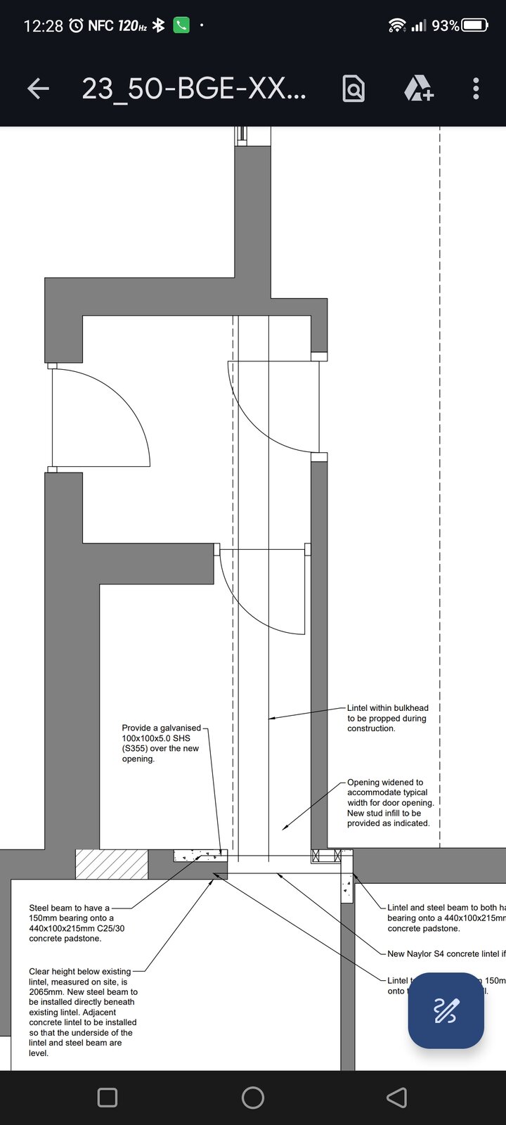

Surely you need 2 and a needle or one and a strongboy - assuming the opening is being widened beyond the span of the existing.

The opening will remain the same width.
Why do I need a needle?
Will putting acrow props directly under the beam close to the doorway I will reopen will not be enough?
Why do you even need an acro then? In your picture the opening is already open and supported. If you want to put a new lintel lower down or something an acrow directly underneath will stop you getting it in. If the opening needs to be lower to accommodate a door lining just infill above with some timber and plasterboard.
The picture is the proposed plans.
Please take a look at the photos on the first post.
Opening is covered with block work and the beam is resting on the padstone
I will need to support the beam in order to reopen the doorway.
An existing lintel is sitting above right where he wishes to open up a new doorway. It is perpendicular to that new doorway, meaning the end of the existing lintel will be floating, one the masonry is removed. He intends putting a strong lintel above the new door opening in order to support the existing lintel end.
Difficult to tell from the photos but my answer's 5.

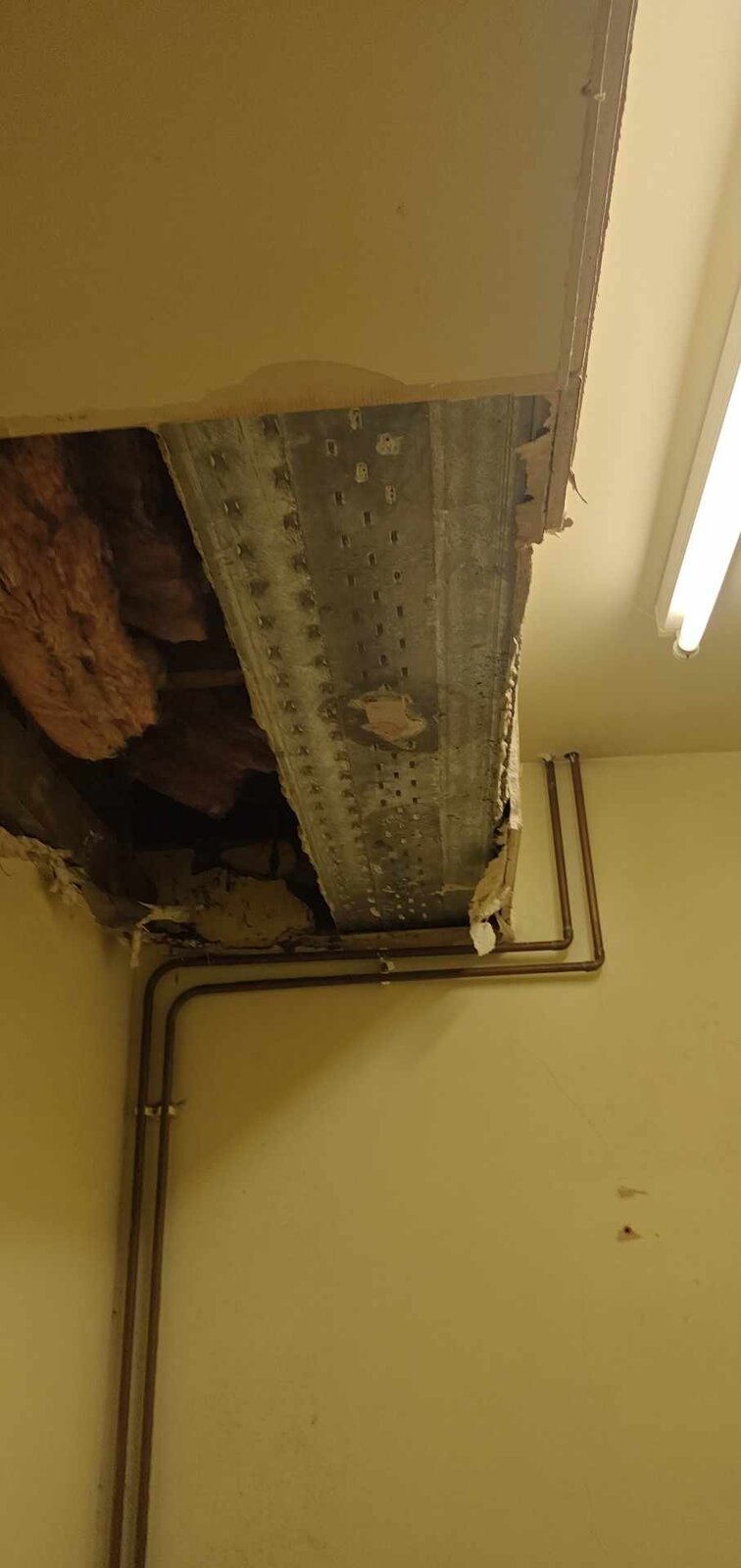

You need one to support under one end of the existing metal beam, on the other side of the padstone you're about to remove.
Then you need another four with two needles to support the brickwork above the wooden beam as you'll need to remove the brickwork from under this wooden beam and whatever's on the other half of the wall to create the opening for your new lintel/beam(s).
Or if you're intending to leave the wooden lintel in place then you may get away with fewer, as you'll only need to support one skin of the cavity wall. But it's difficult to work out how the intersecting wall on the other side helps or hinders.
Basically just support anything you're taking stuff out from under! It's not complicated.

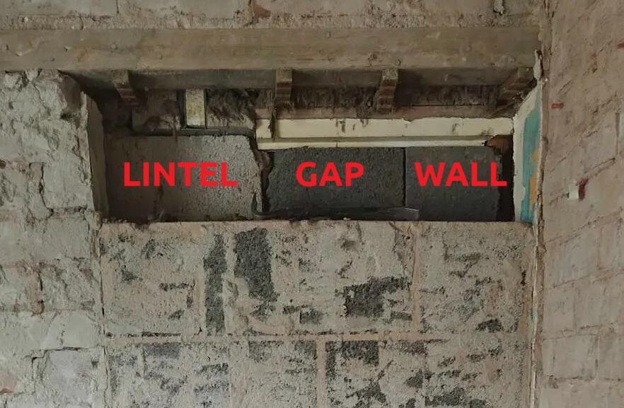

It looks to me like your new doorway is going to bump into the end of the intersecting wall on the other side (in the yellow room), probably why it was bricked up in the first place. Picture of my interpretation of the photos...
Sorry, didn't see the lintel. One under it and as above, doesn't appear to be much else to worry about but hard to tell.

Just saw that the plan does confirm this. So it's going to be a very narrow doorway, also with restricted height due to the beam under the lintel.
Thanks @Ivor Windybottom
The Wall highlighted on the right is internal and I will plan to move it, so the width will remain as it is ~95cm.
Since the width will not change I am planning on keeping the wooden lintel in place.
I am not bothered about the height.
In summary I will then need
1 - to support the existing beam close to the doorway I will remove
2 + strong boys - to support brickwork above in the place where I will insert pad stones for the new beam which will support the existing beam
Still just the one, if all you are doing is removing the end bearing. Other support may be necessary for other parts of the project.
