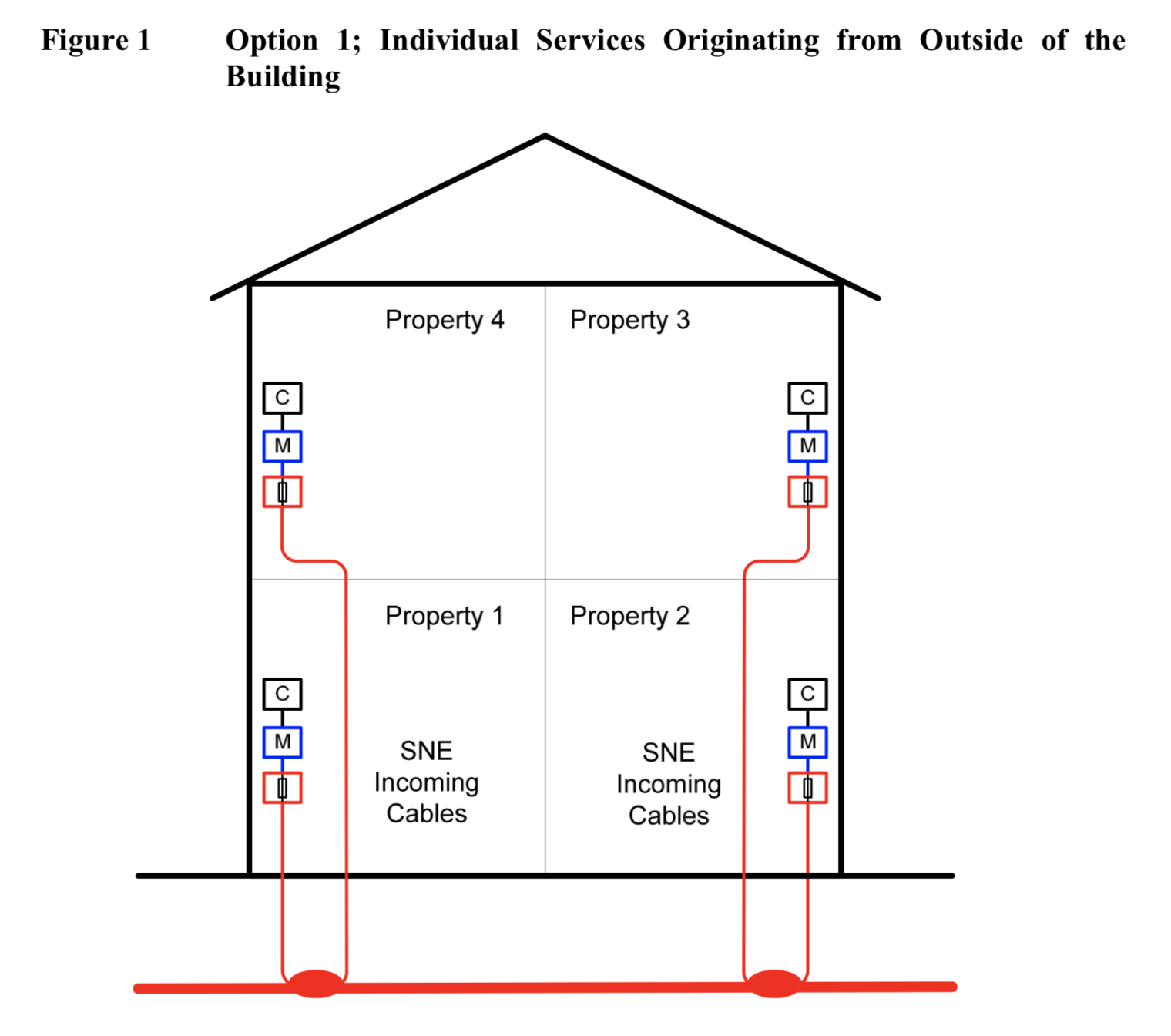

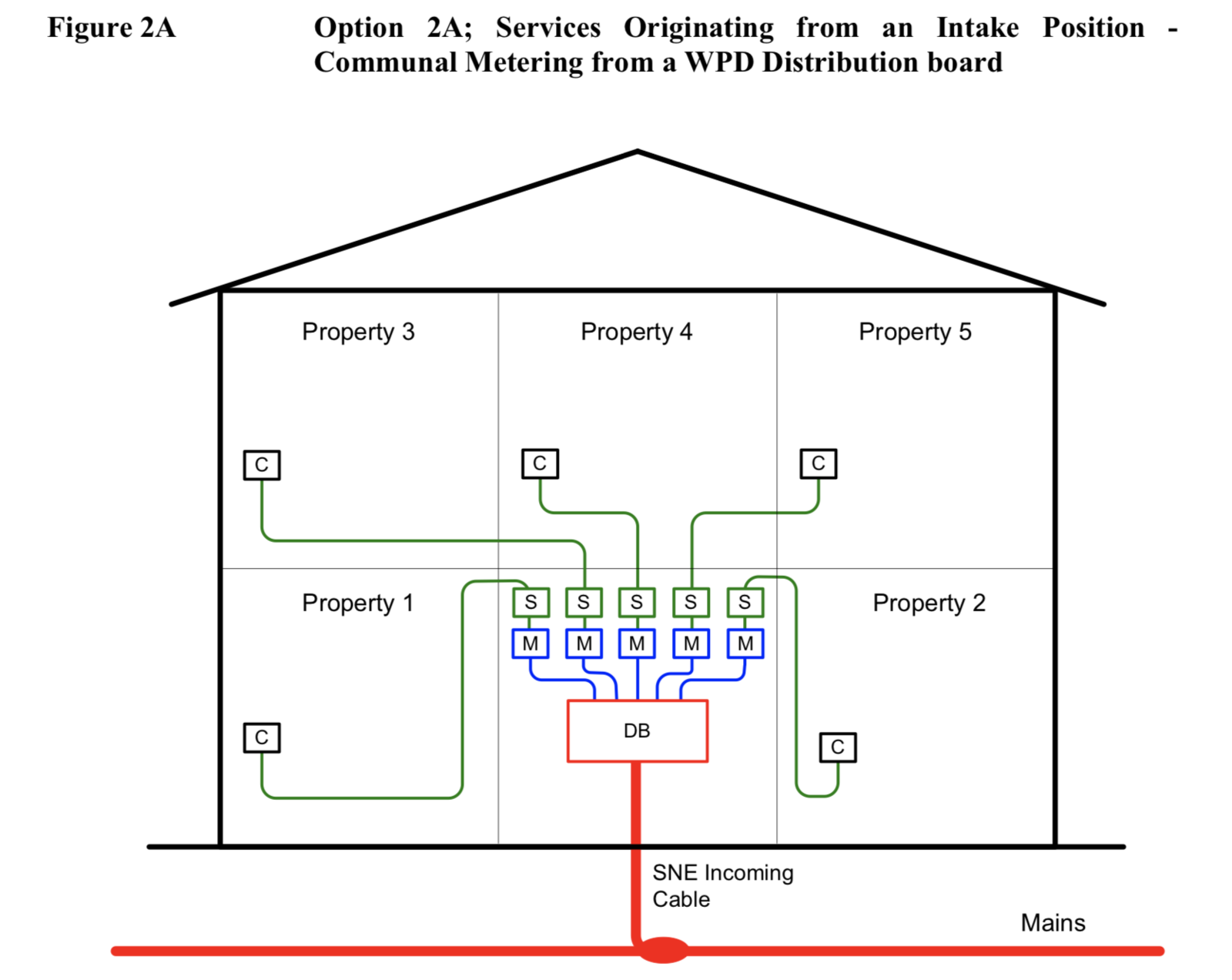

    I would speak to the DNO first - I would imagine with the building being an old commercial supply it should be up to the task, but if it's not, their requirements will determine what you can do. Around here, there are two (main) options for multiple supplies
    Screen Shot 2018-03-20 at 22.47.12.png Screen Shot 2018-03-20 at 22.48.07.png
    They dislike the second option as it involves their equipment throughout the fabric of the building - or worse, clipped up the face of the building.

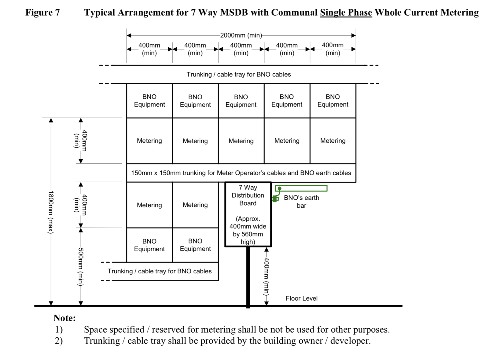

    I would reccomend thinking about having a switch room incorporated into the plans. Min dimensions in the drawing below. (It goes from a 3-way MSBD to a 7 way)

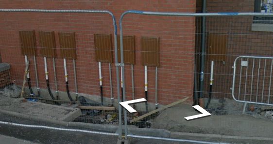

    What's this? (clearly not enough room for a service head, together with multiple meters and {presumably} multiple switch-fuses) ?? .....
    [​IMG]

    That rather depends a lot on one's view of "reasonably unobtrusive" :)
    Kind Regards, John
    • Like Like x 1

    I agree. Particularly the box on the left! And I hope there's some structural support above the missing third of the wall!

    Well, it's acceptable where they are .. might not do for a mansion block in St Johns Wood
