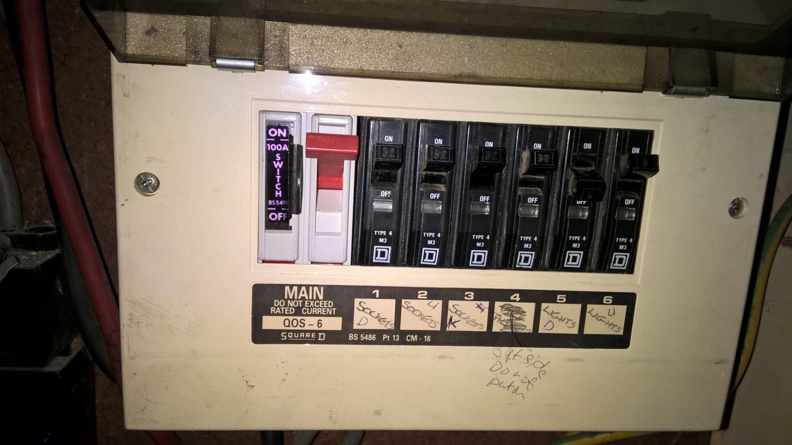

an electrician came today to see the house for EICR and he immediately said the will not pass because the consumer unit does not have any RCD, see attached picture. is that true?. I asked him what need to be done to rectify this so the house can pass. he said a new consumer unit is required which will cost £1000.
my questions are:-
does the consumer unit MUST an RCD to pass? or it is recommended?
if yes to the above, does the complete unit needs to be RCD or just the power sockets? 184_consumer_unit.jpg .
Get someone else.
An EICR is a report on the installation using the latest regulations, so it will include a lot of "improvements recommended".
There is no fail.
Unless there is something exceptional, £1,000 is very expensive.
Items that are inspected have 3 codes - C1 for immediately dangerous, C2 for potentially dangerous, and C3 for improvement recommended.
Any C1 or C2 will result in an outcome of 'unsatisfactory', and those items must be rectified before the installation is considered 'satisfactory'.
C3 items do not have to be, however C3 items are those which are not dangerous now, and won't lead to dangerous situations in the future either.
Guides such as this one: https://www.electricalsafetyfirst.org.uk/mediafile/100740439/Best-Practice-Guide-4-Issue-4-.pdf
suggest that no RCDs on socket outlets which are likely to supply equipment used outdoors are a code C2, so your installation with no RCDs will have at least one C2 and be unsatisfactory.
However that advice is actually out of date, as the particular regulation which required RCDs for socket outlets only for items used for outdoor equipment originated in the 16th edition over 25 years ago, and no longer exists. Today, virtually all socket outlets in dwellings require RCD protection and have done for years, therefore the lack of RCD protection for socket outlets is a C2 regardless of whether they could be used for outdoor items or not.
Replacing the consumer unit is not the only option, as RCDs can be added as separate items. Whether that is a cheaper option depends on the particular installation.
Even if it is, cheap options are not always the best option.

I would suggest you get a new CU, that will include certificates including test results so you won't need a separate EICR.
Get some more quotes for the cost.
If you end up going the new CU route then think about arranging the power distribution for the convenience of the tenants (ideally each separate living unit should have its own circuit breakers so a fault in one unit doesn't inconvenience other residents). Might be quite pricey as a retrofit....
... ideally each separate living unit should have its own circuit breakers so a fault in one unit doesn't inconvenience other residents ...
With an ancient 6-way CU like that, you'd basically be looking at a rewire to achieve 'unit separation' for the tenant's convenience. Don't imagine that's going to happen.
