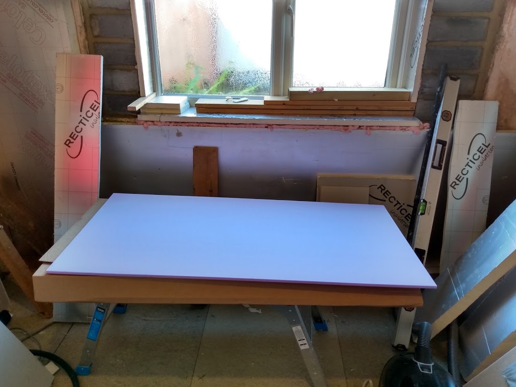

It's ordered. To clarify, in the pic is 25mm insulation and 9.5mm plasterboard, so 34.5mm total. So those thermaline scholar boards will be no good.
I think I had this dilemma in another room and ended up just spraying the dryfix foam on thick ... will leave the top as it is (did like this in new bathroom window it it looks OK) but replace the sides with 10mm insulation, giving an extra 15mm minus skim and adhesive.
they’re thermaline. i was referring to fruitybum as scholar:LOL:.
New insulation arrived, and in one piece!
A bit wonky, but it'll have to do. The thin board gets push out by the foam, which i didn't expect, but once plastered and curtains up nobody will notice...

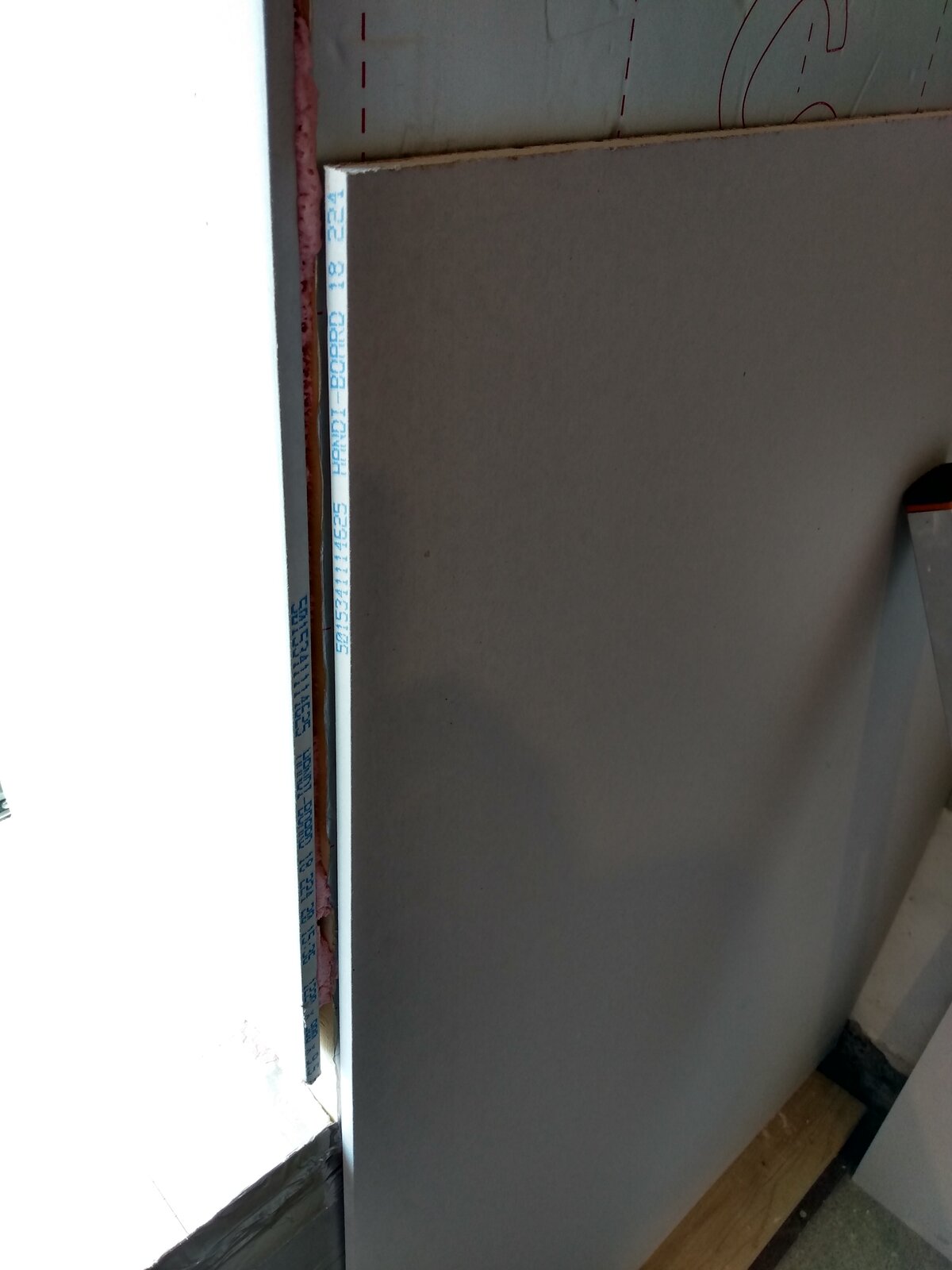

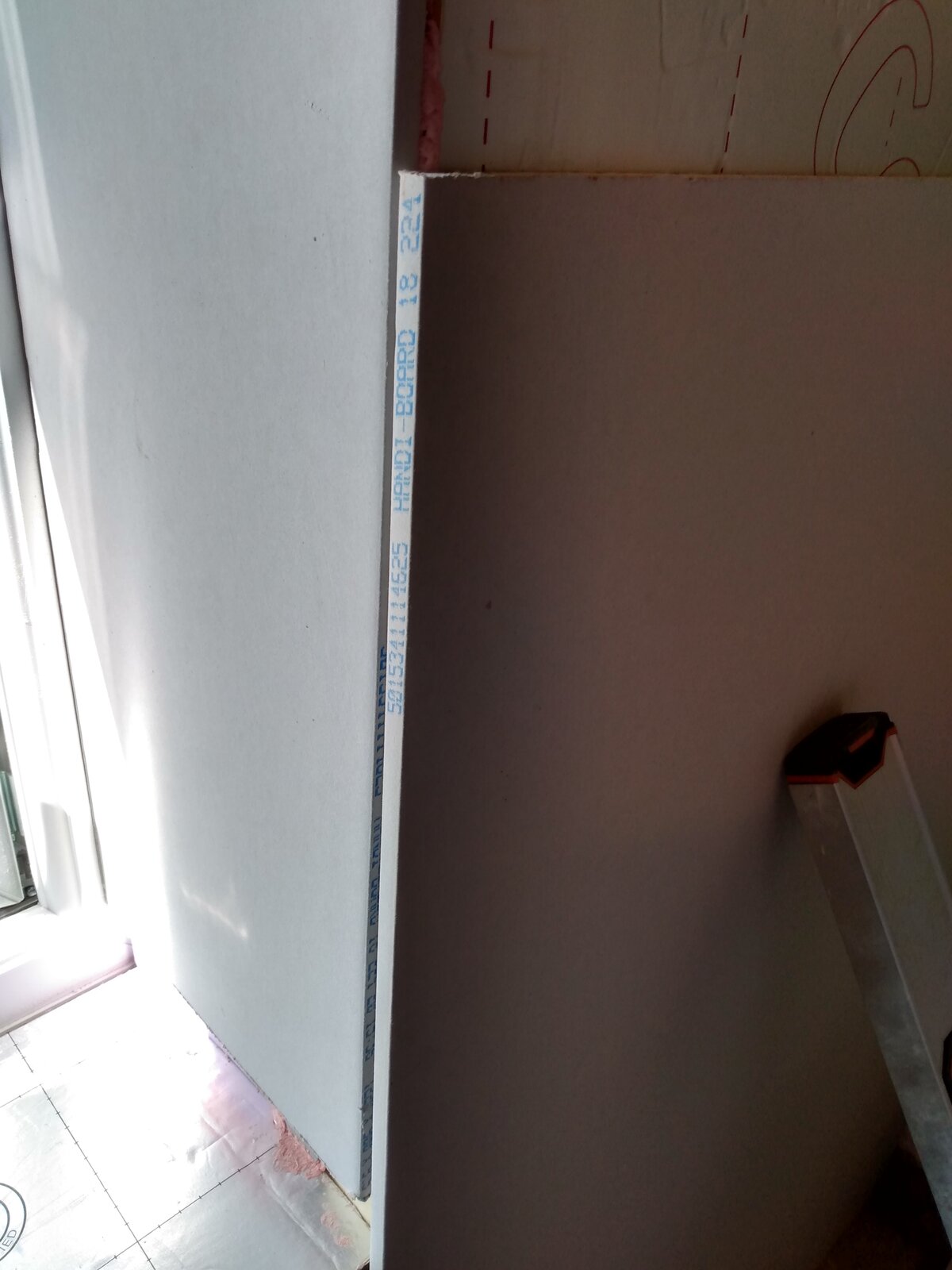

Can this board bit put in like this
Or should it be like this

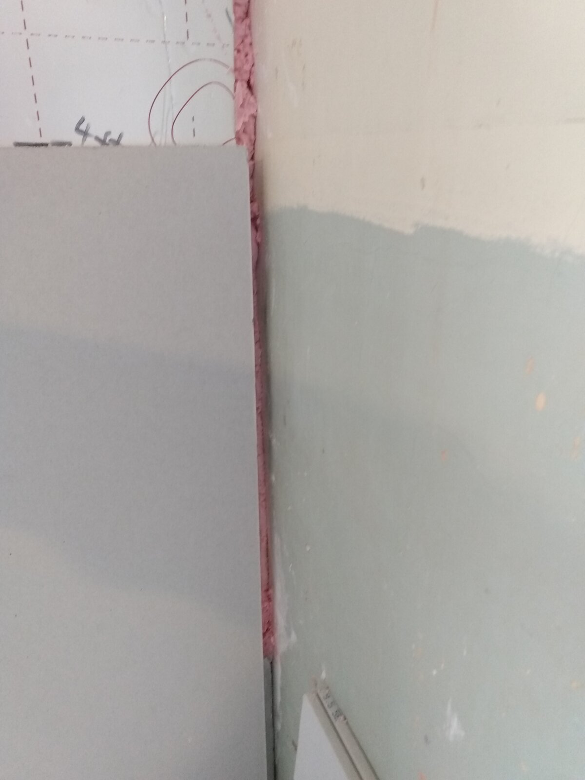

If like that, them is this gap by the wall ok for a plasterer to fill?
Wondering what would be easiest, how big are those metal corner strips plasterers use?
Are you using angle beads, the last ones I bought from Wickes are around 20mm (From memory) I stapled them on.
