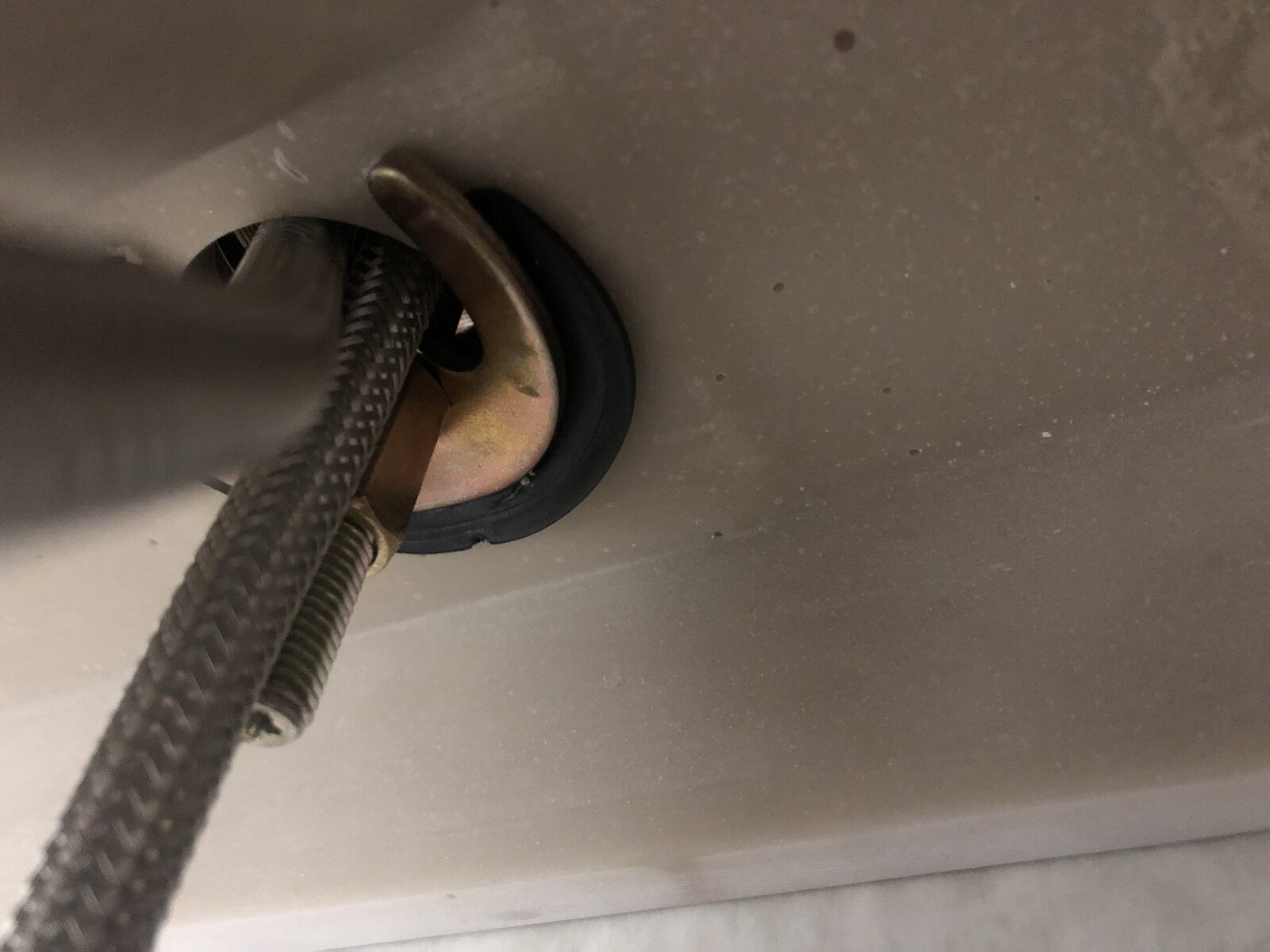

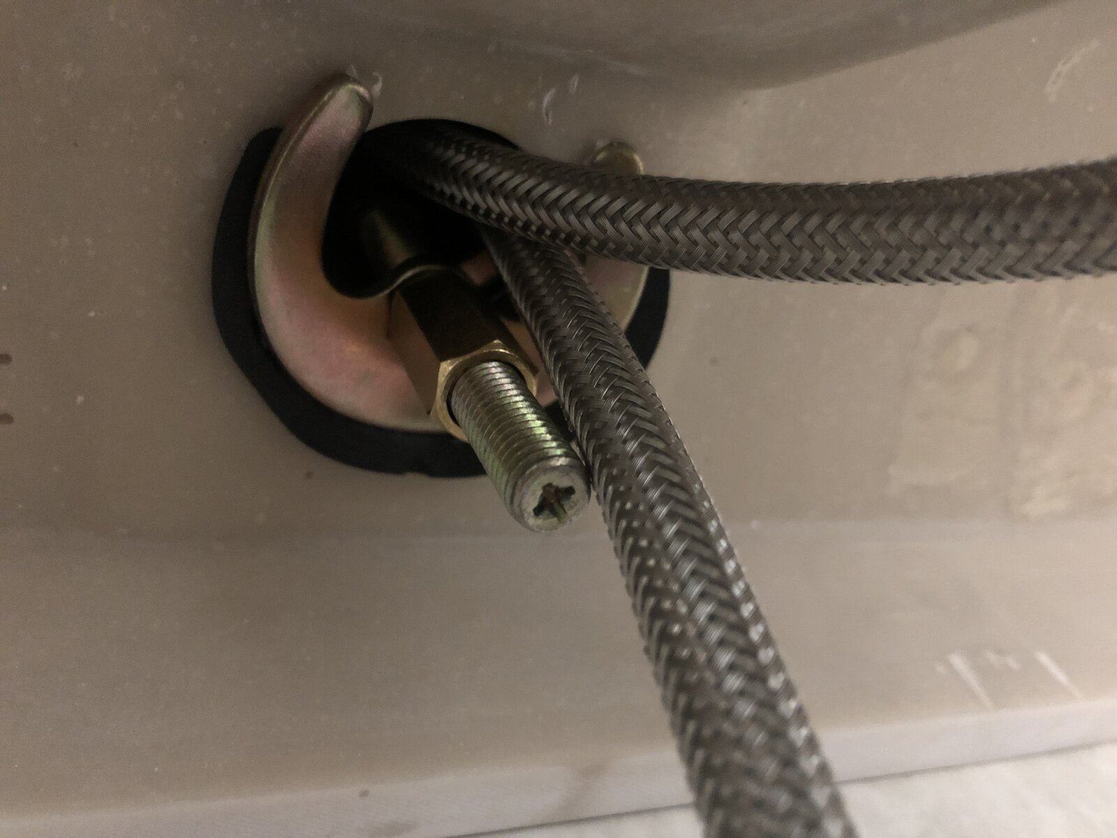

Thanks - very helpful. I’ve done this but the mounting plate starts bending after a while of tightening so the nut keeps moving up but the rest of the horseshoe bends. Is this normal? The tap still leaks slightly when it’s that tight, although not as much as previously.
I have not experienced a horse shoe metal washer bending , what's the thickness of the metal ?
Can you show us some pics ?
Hard to get the right angle to show the bend but you should be able to see in the second photo!

Hard to see if the metal is bending in your pic , can you remove it and see if it's cracked ?
The rubber horshoe washer isn't sitting correctly ,not aligned with the metal washer ,which may be causing it to " skew" when tightened up

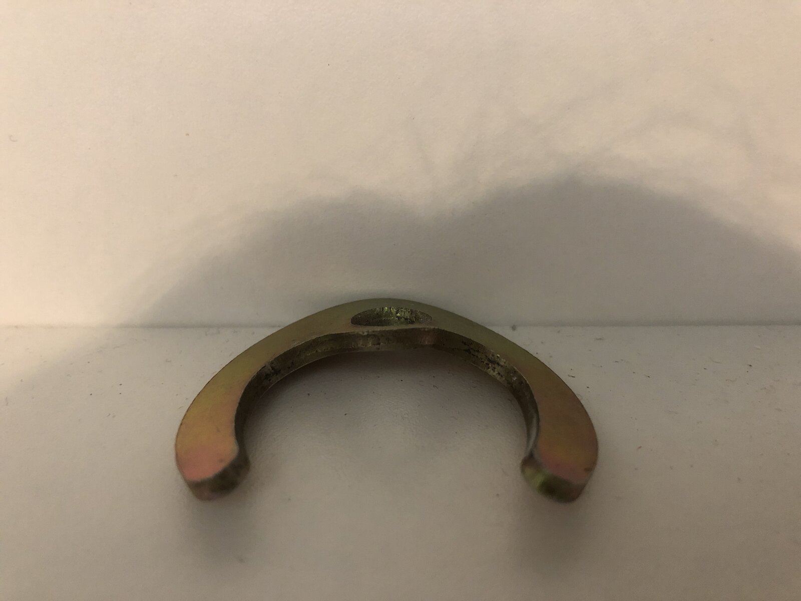

Have taken the whole thing off and it’s more bent than I thought! Rubber washer is damaged too. Must have happened when it was originally fit. Assuming best solution is to try a new washer entirely and see if that helps?

Well I ain't seen that before ,lucky the basin wasn't cracked. It would require quite some torque to bend that metal washer like that.
New rubber and metal washers needed for sure.
There are a couple of notches in the underside of the basin, so yes very lucky indeed. I actually turned the washer upside down on the theory it would bend back, it’s gone into place nicely and no leaks for now! Will still replace but at least a short term fix.
