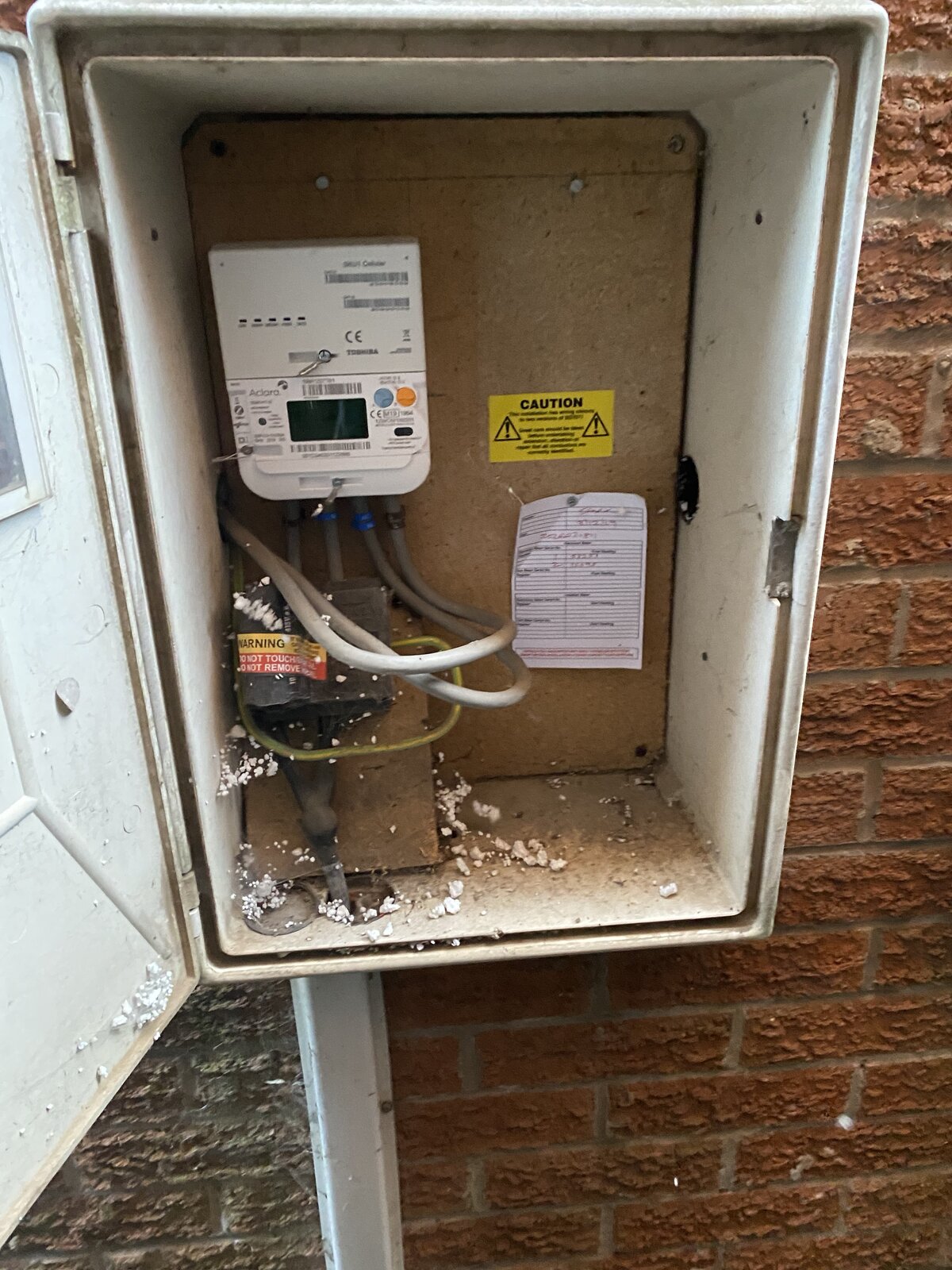

How to activate isolation on this smart meter.

No it was never my intention to use it as a safe means of isolation.
I’d pull the cut out fuse before relying on it. What interested me was I suppose the implementation by the suppliers who must be using this software driven device as a ‘safety’ device to isolate systems prior to work and for seemingly up to 72 hours.
I wrongly assumed that as an isolation device was fitted then it would be sensible to have some means of confirming and locking its state before any work was carried out on the user installation.

Prior to a consumer unit replacement for example. As there is no intermediate isolator between the meter and the CU where is the safe isolation point to allow disconnection/connection of the tails? Only answer is removal of the Cut Out fuse, which can be done with DNO approval but which as previously suggested likely results in an enquiry from the supplier.
No I don't assume the meter has a means of 'safe' isolation. I suggest that the meter has a means of isolation which when contacting the supplier for a disconnection is utilised and deemed by them to be 'safe'. The Aclara SGM 1400-B SMETS2 Meter certainly has a built in contactor that allows the supplier to disconnect the supply to the premises. As this is their only means of control. The cut out fuse being the responsibility of the DNO, then when the supplier provides a 72 hour window of opportunity for an electrician to disconnect/connect a CU, this is the only means they have without approaching the DNO, which the electrician could do anyway.

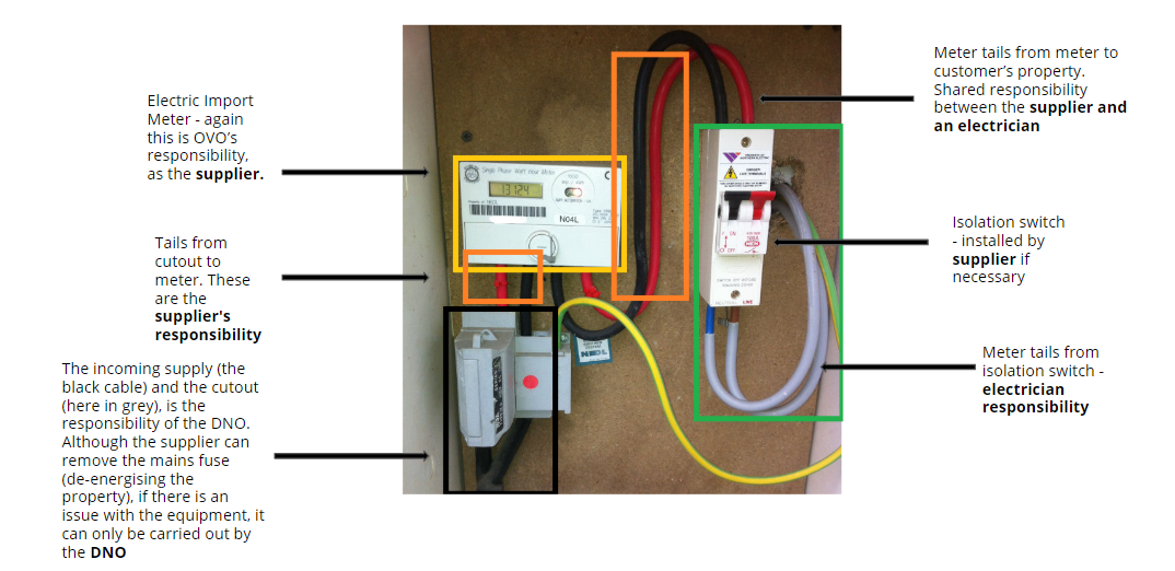

OVO provides a picture of responsibilities
Interesting use of the phrase 'if necessary'
This is the installation OVO manage
The only means of safely isolating the supply being the removal of the cut out fuse.
How is the inclusion of an isolation switch in this case considered 'if necessary'???

It means it may be necessary for the supplier to install it. It maybe be possible for an electrician to install it and have the supplier connect it later, or at the same time. In practice, many electricians will pull the cut-out fuse, install the isolator, and reinsert the fuse - then advise the supplier to reseal the cut-out.
Such an isolator is not considered to be either essential or necessary, unless the meter to consumer unit tails are longer than 1m (I think). They are always a useful option to have.

Interesting use of the phrase 'if necessary' ...
Yes, interesting. I;ve personally never heard of a case in which a supplier has consdiered the installation of a post-meter isolator to be 'necessary' - to the best of my knowledge, they only install such isolator (with or without charge) if that is resquested by a consumer.
I think there is probably a bit of a language issue here, such that where the diagram says "isolation switch .... if necessary", they probably really meant "If requested" (by consumer).
