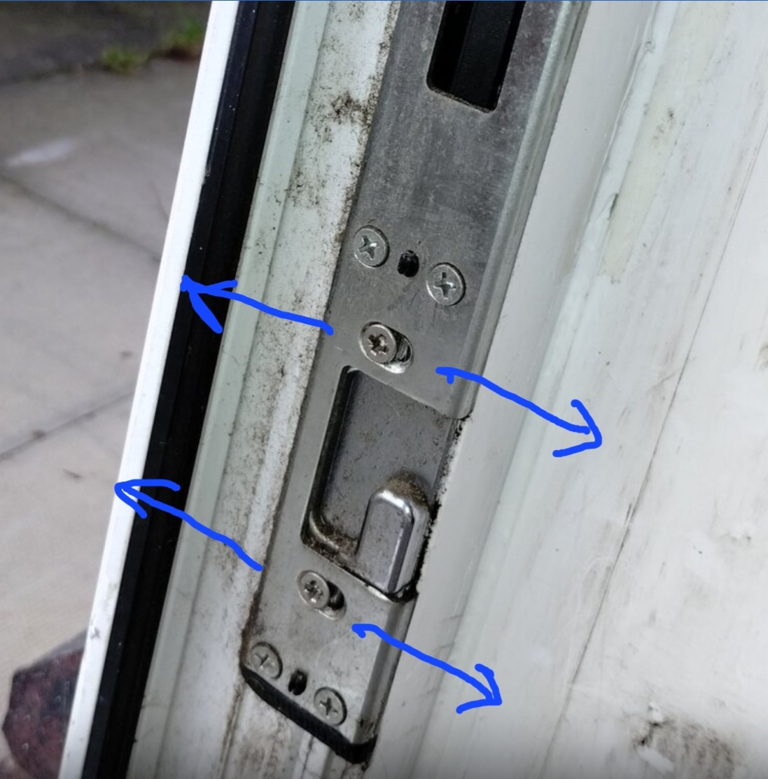

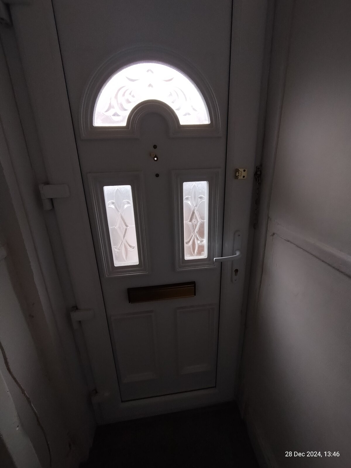

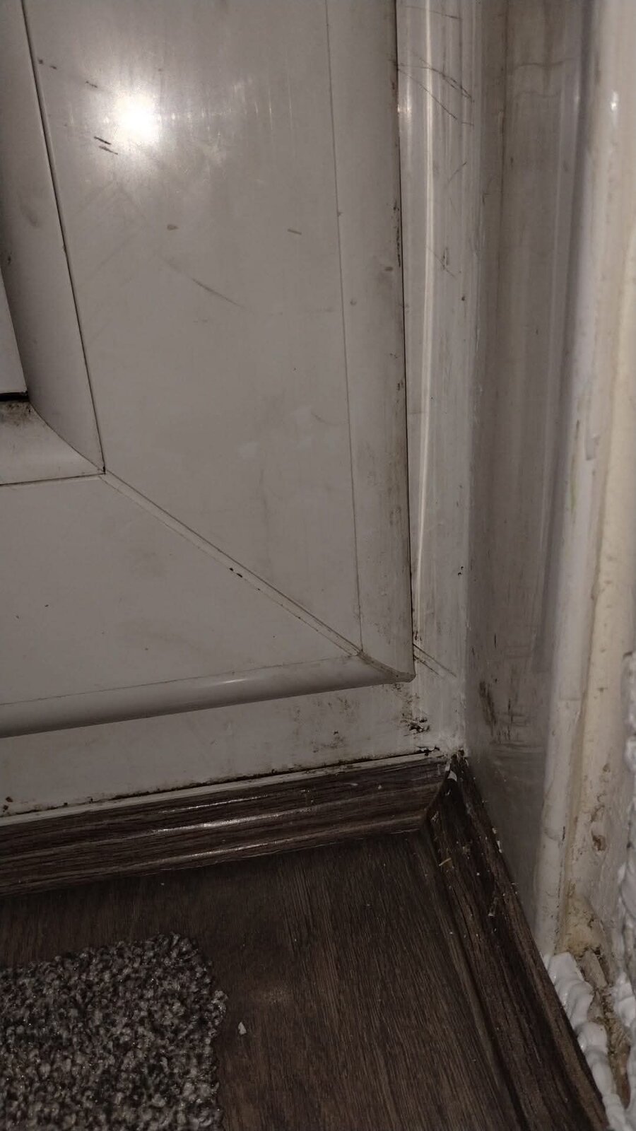

Hi,

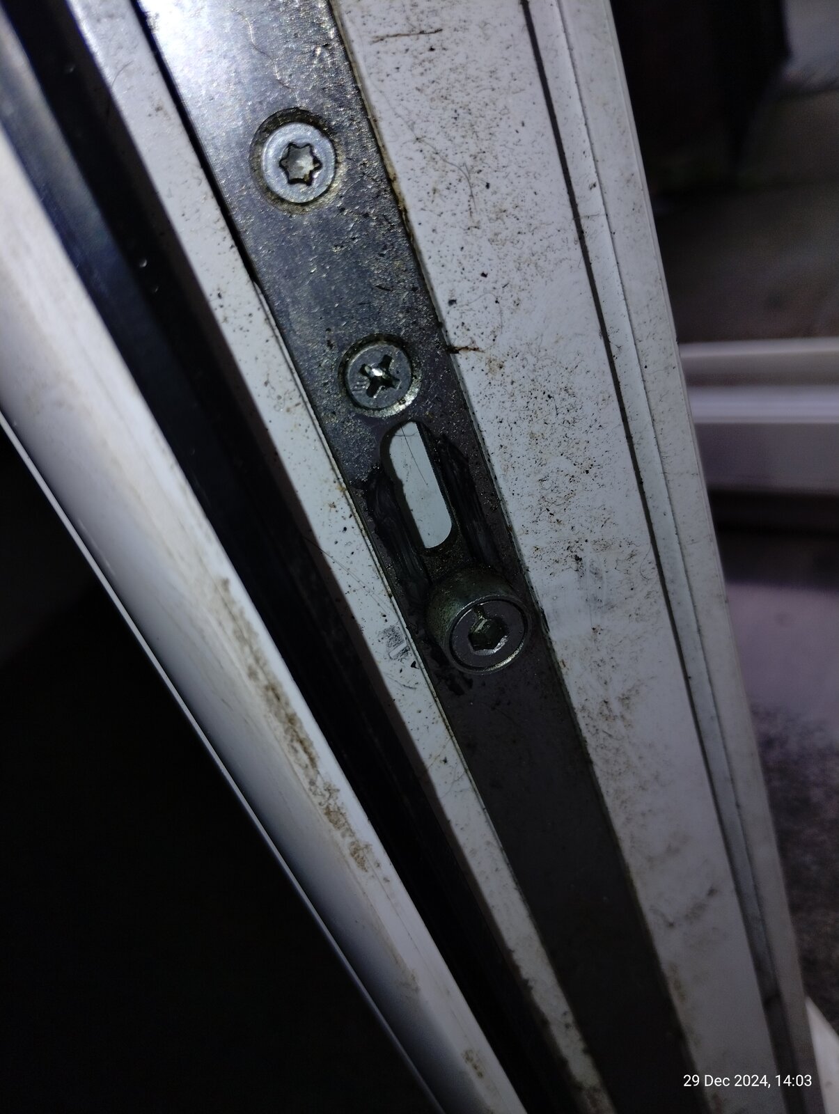

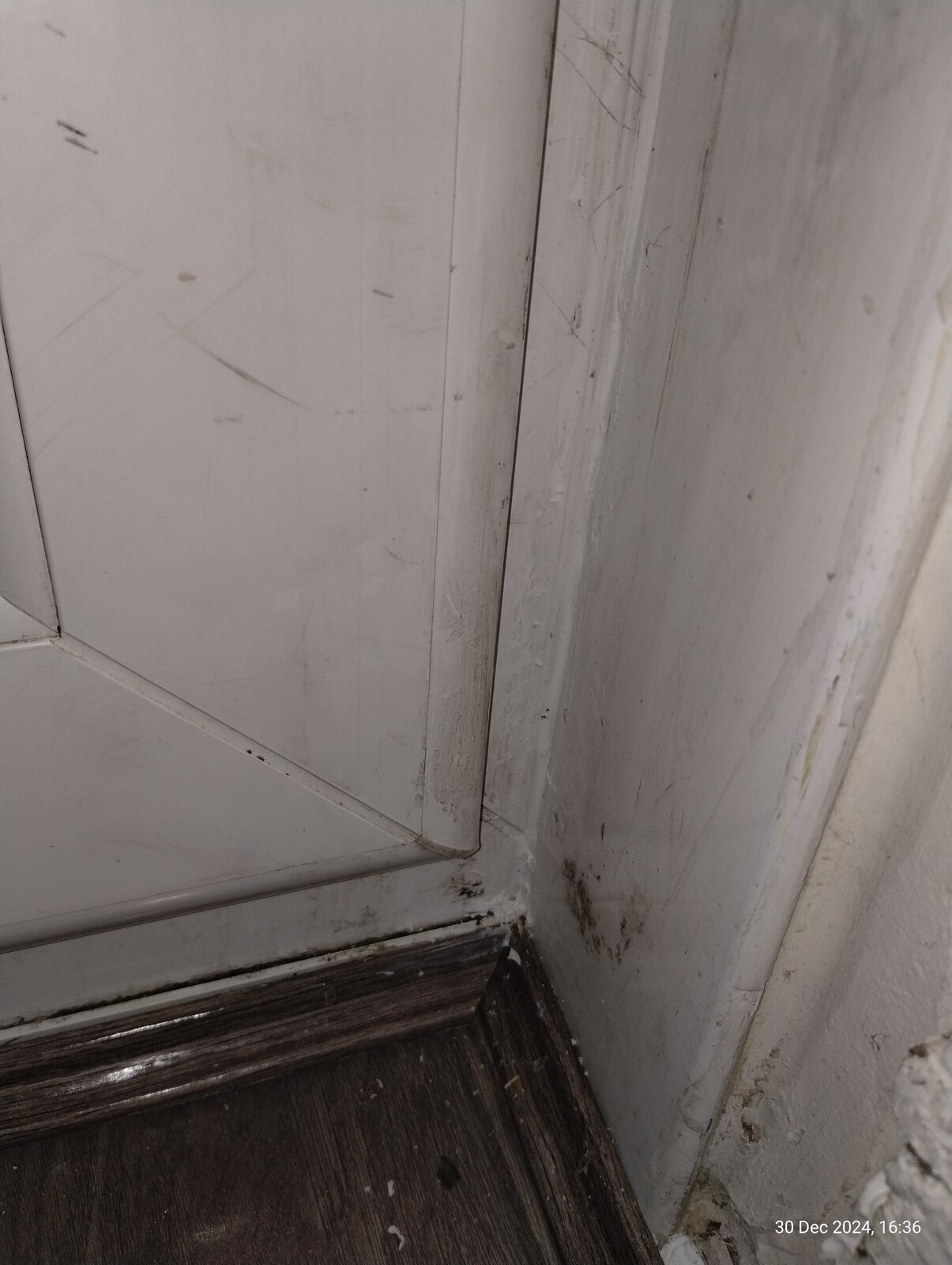

All corners, except the bottom right, of our front uPVC door are aligned with the door frame (pic 3). The bottom right corner is also where noticeable draughts are coming through.

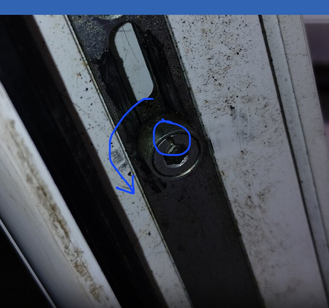

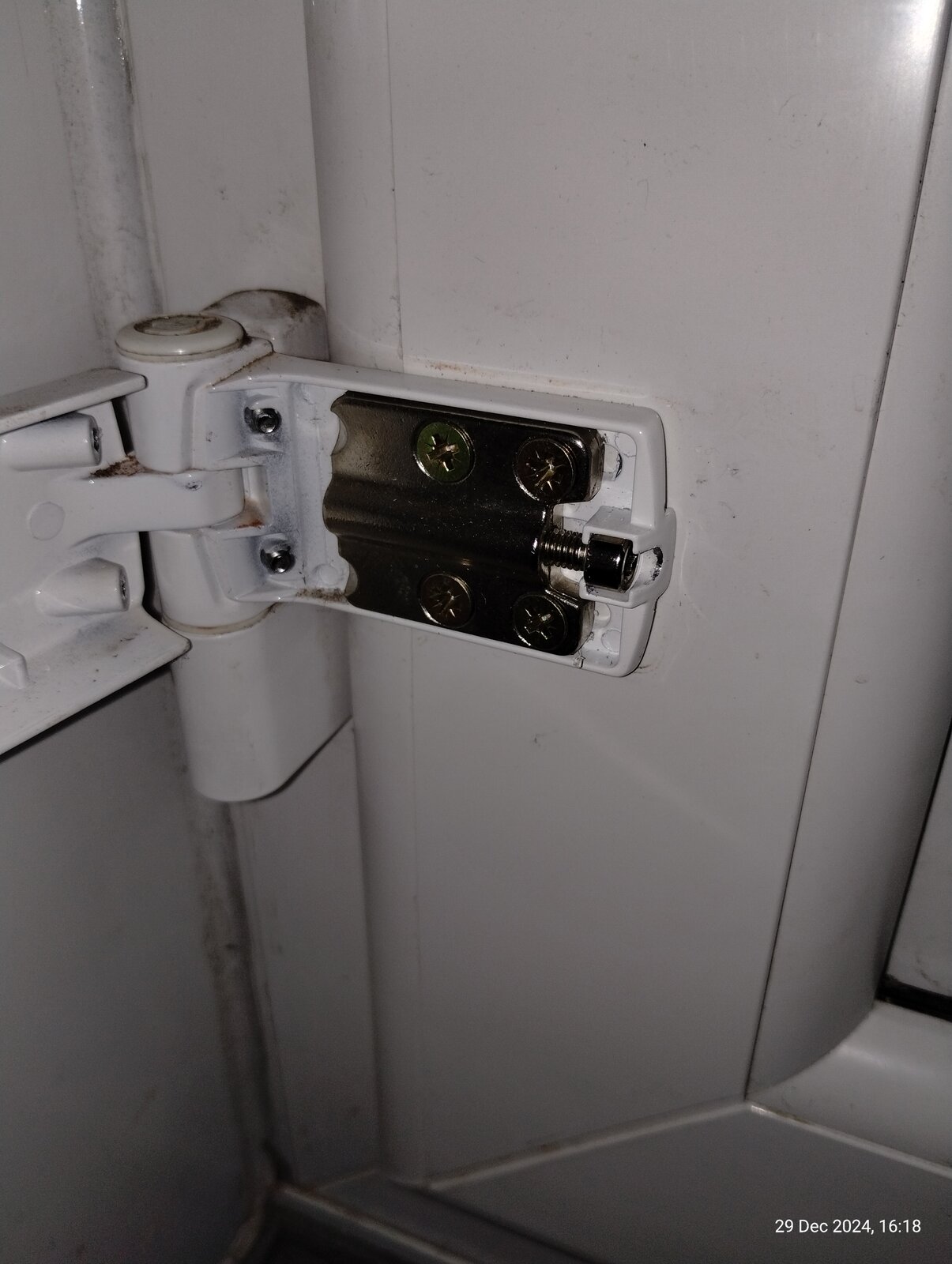

Underneath the 4 hinges on the door are two Allen key sockets (pic 1). There are none on top. One seems to be a compression one. The other seems to move the hinge forwards and backwards.
I have spent the best part of today fiddling with the hinges to try to sort this out. The socket on the right must be compression, as the top and middle part of the door are now very tight - can't get a finger in to pull the door forwards. But the bottom of the door - even when I engage the lock - still isn't as tight and I can pull it towards me a centimetre or two.
How can I bring the door further up? I'm hoping that would fix the draught. Would it be one of the two Allen key sockets , or is there another one elsewhere? There is nothing at the top of the hinges, only a decorative piece. Nothing for me to screw underneath it. Any ideas would be warmly welcome
TIA
