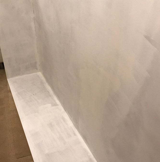

I am trying to make some furniture using MDF.
I have been recommended to 1) Sand with 120 grit, 2) prime with Zinsser BIN, 3) Sand with 220 grit, 4) paint with Dulux Trade Satinwood.
I am at the second step, and have just applied my first coat of Zinsser BIN with a gloss roller:
You can see it's quite patchy. Is this expected? Should I try another coat, or just move onto the sand + satinwood finish?
Thanks!!
I would give it a light rub with 250 grit and another coat. I always like to get a flat coat of undercoat on no matter how many coats , before top coating
I've only used BIN as a blocking coat, to apply emulsion over varnish or whatever.....as its shellac based it does this particularly well with minimal absorption. In your case I'd be using a dedicated MDF primer.
John :)
Thanks John, yes that was the alternative. The forums suggest BIN as a primer works well for MDF because of what you say - it creates a barrier to stop absorption so specifically the edges look nice. I am just wondering if this is enough.
Dulux satinwood says it is 'self-priming'; any thoughts on this?
Seriously, for any absorbent material like MDF (especially the edges) I'd be inclined to give a coat of primer then undercoat - this will absorb nicely. At that point I'd go for the BIN on the edges only.
Self priming paints are OK for those in a rush!
Enjoy your project!
John :)
just build up the coats on the edges, sanding inbetween. Its a bit more expensive but moisture resistant MDF doesn't fluff up anywhere near as much when cut or routed.
BIN is expensive but does have it's place I only really use it for problem substrates.
For MDF I would first give it a rub over with 250 grit then prime with acrylic primer and again rub back with 250 grit then as many coats of undercoat as necessary to get a flat colour sanding with the 250 grit between coats, followed by two cots of top coat, giving a light sand with 400 grit if leaving it for much more than 24 hrs between coats.
