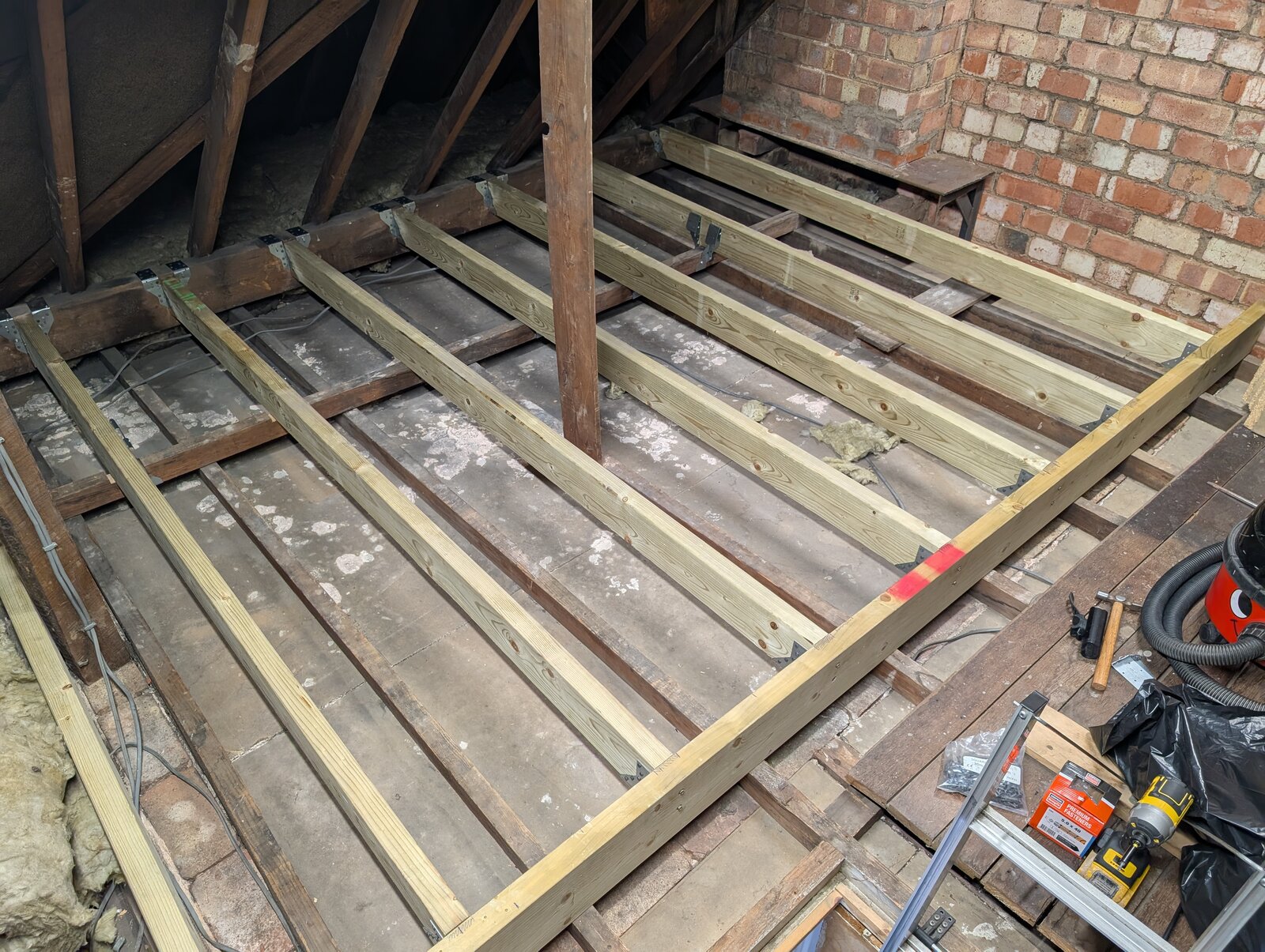

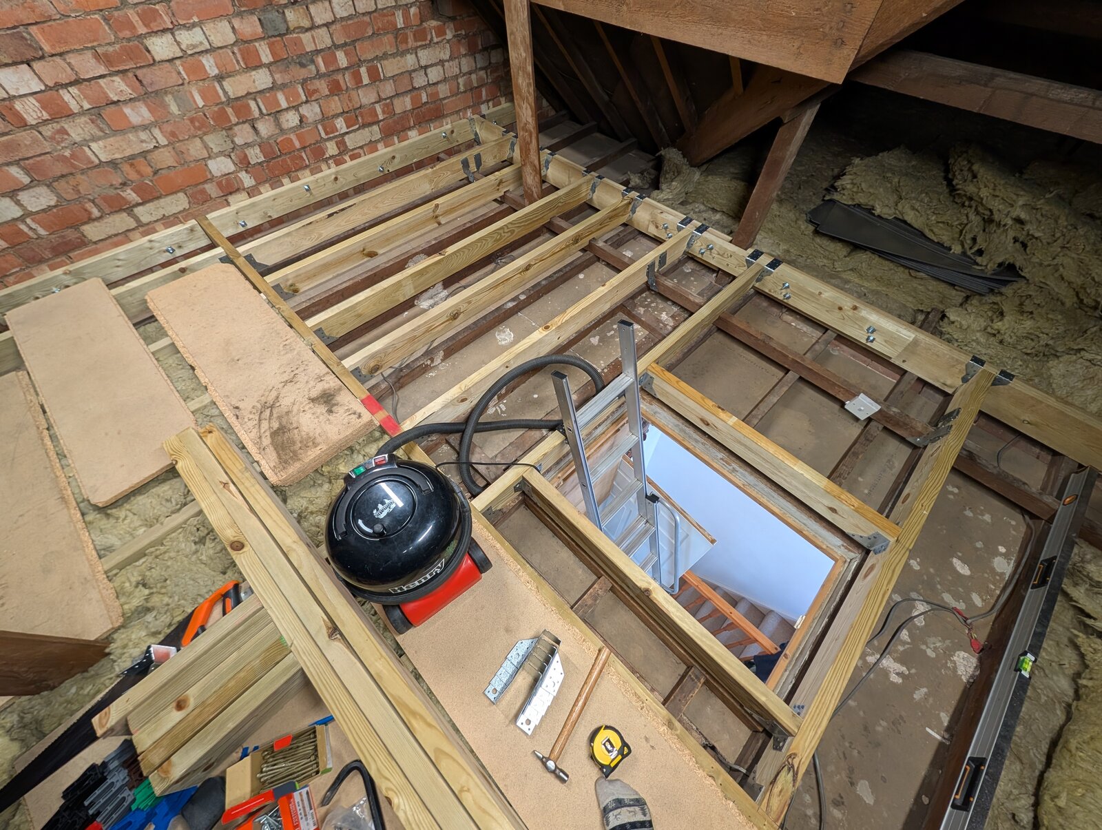

I have already completed two sections, where I was able to utilize existing brick internal supporting walls to rest new joists on. I attach two photos of completed sections.

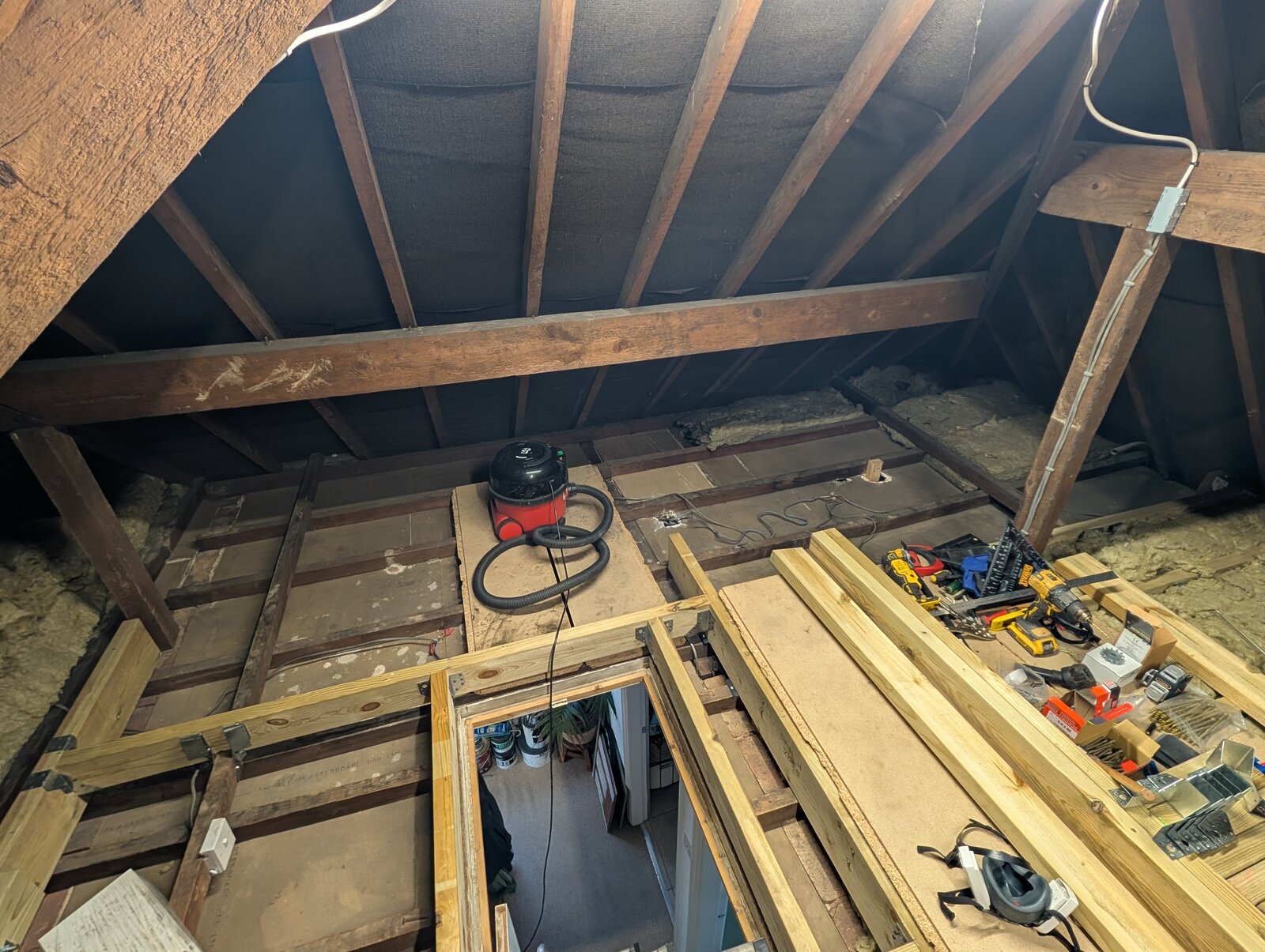

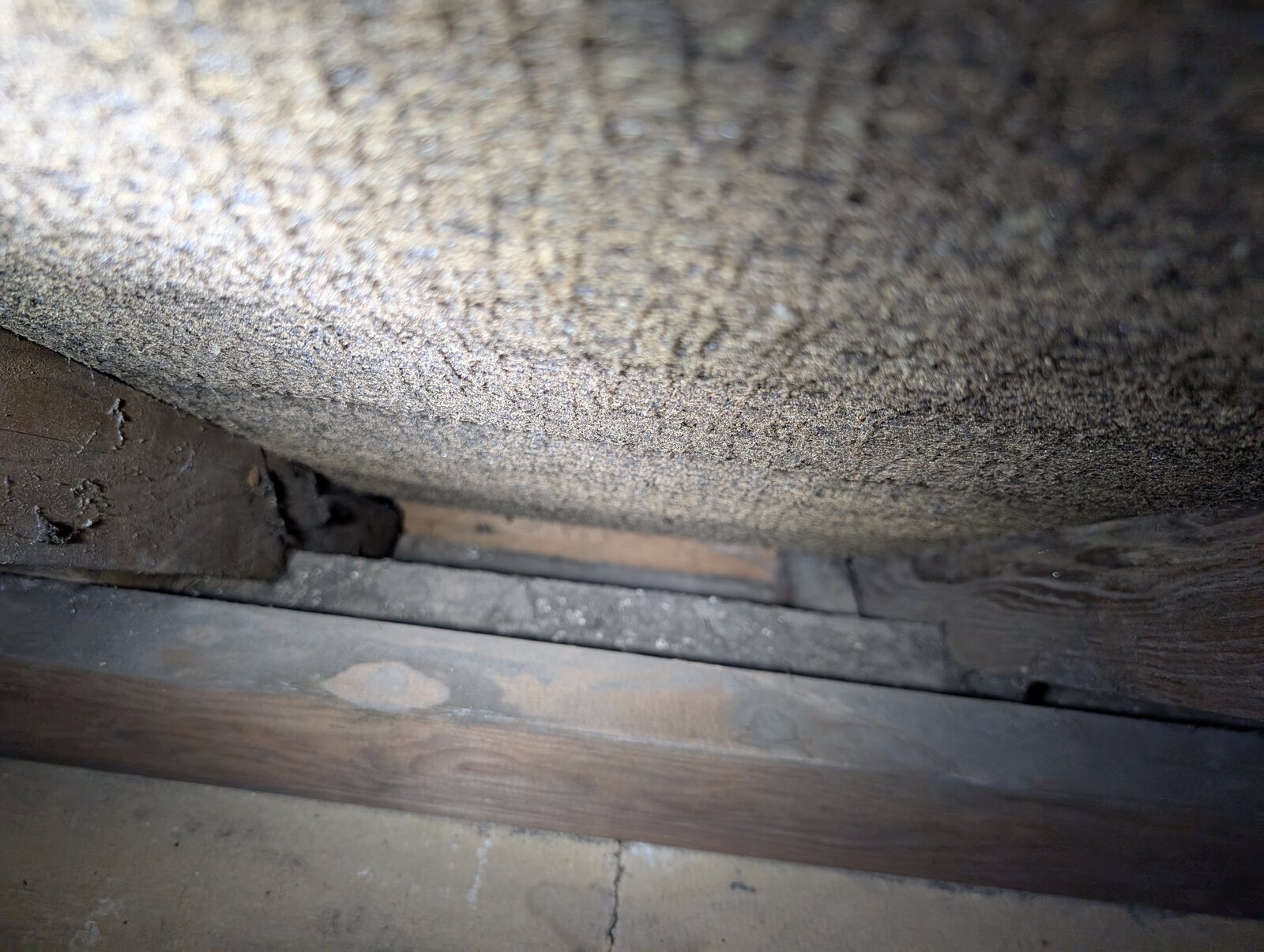

My issue is how to rest new 7x2 joists onto the existing wall plate, when the existing rafters at a 45 degree roof angle limit the available bearing for the new joists. I attach a photo showing the final section I want to board.
If I cut the new joists at 45 degrees I will compromise the bearing end substantially.
I'm happy to include some extra pictures or diagrams if it helps explain the problem I need to solve, please let me know what you would like to see.

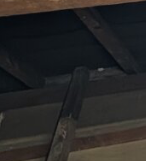

Not enough to cause a problem. Your rafters are much smaller and have a birds mouth notched into them "compromising the bearing" and the roof hasn't failed. You also have to remember that the majority of the load these joists carry, bears on the end nearest the camera, because the far end isn't usable space, unless you're planning on storing your hundreds of rolls of lead sheeting there
You already have one such timber cut thus and it's helped support your entire ceiling for years:
Cut your new ones to match the roof pitch and slide them out so they're just shy of touching the felt. All will be fine, and they will have plenty of bearing

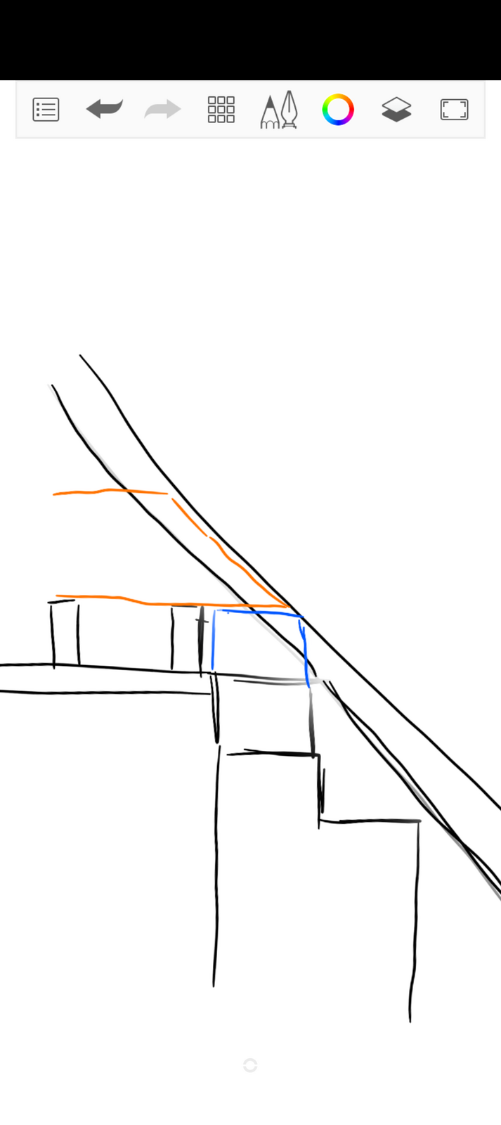

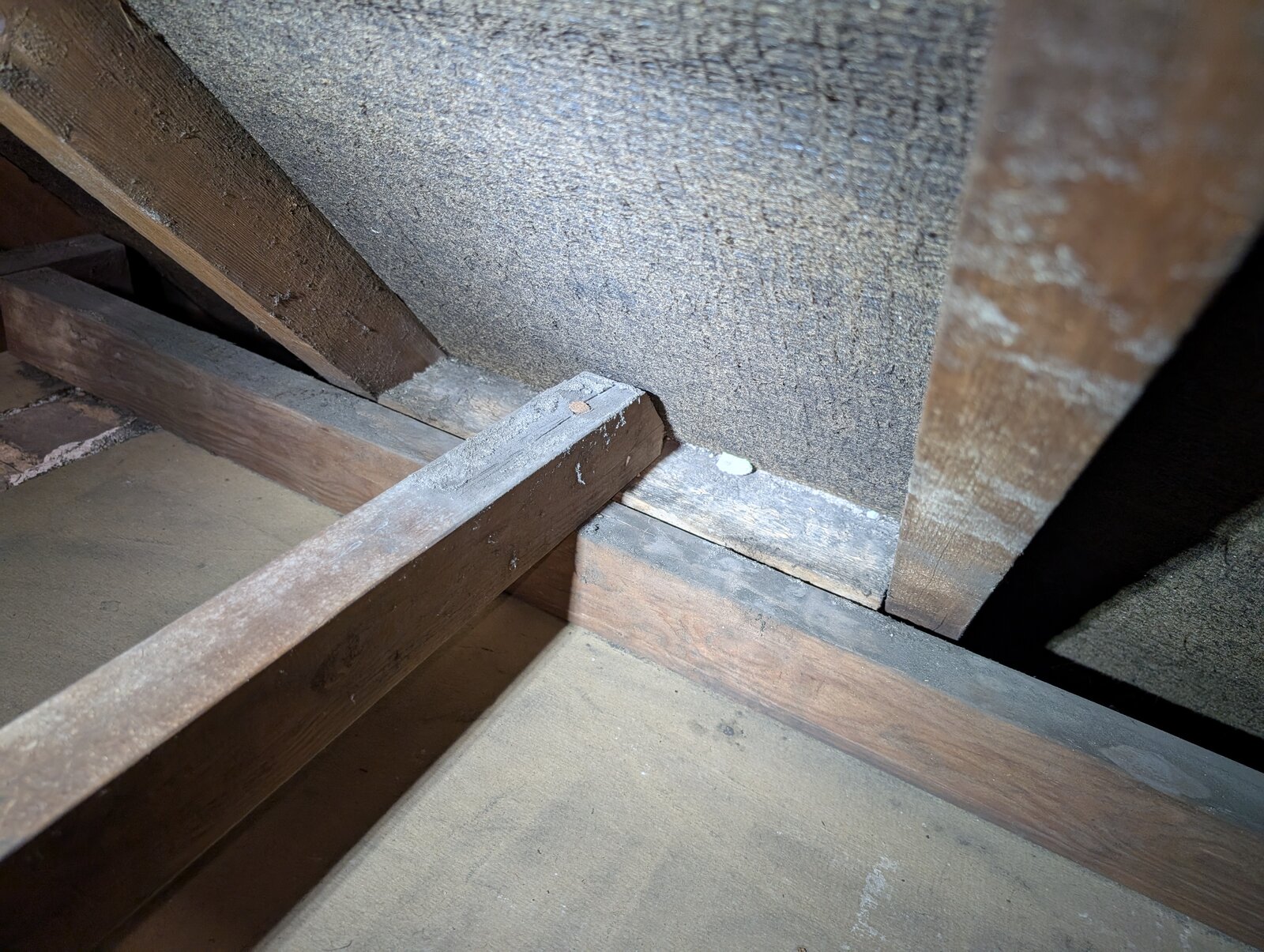

Thanks for the reply.
That piece of timber is just a tie which is tie-ing all the ceiling joist together, it's not taking any vertical load. They have however added an additional block onto the wall plate to raise it up to sit that timber on. The joist you can see in the foreground is just a ceiling joist running parallel to the wall, that's not the wall plate. The actual wall plate is behind that and lower.
If I add a block to pack the wall plate up, and slide the joist over it, I will have about 100mm of bearing but it will be right at the point where it's cut as shown in my sketch. Is that sufficient strength at the end?
What about bolting a metal triangular plate at the end of the joist to strengthen the end, or also bolting it to the rafter or strengthening the rafter?

Close up of corner and looking down to the wall plate itself.

Oh, yeah, it'll be fine. If you're still concerned set yourself up and experiment; cut one end to 45 degrees and put two blocks on your driveway the distance apart of the span when installed in the loft, put another couple of joists either side and a board over the top for stability, then load it up with 5x the load it will have when in service, huge stack of bricks, half a car etc. the load should be at the same place it will be when live (ie not at the sloped end because the head height there isnt big enough to admit it)
I'll PayPal you a fiver if it fails
You can bolt and glue it to the rafter if it makes you feel better; I don't think it will be necessary for strength but it's a reasonable shout to keep it in place

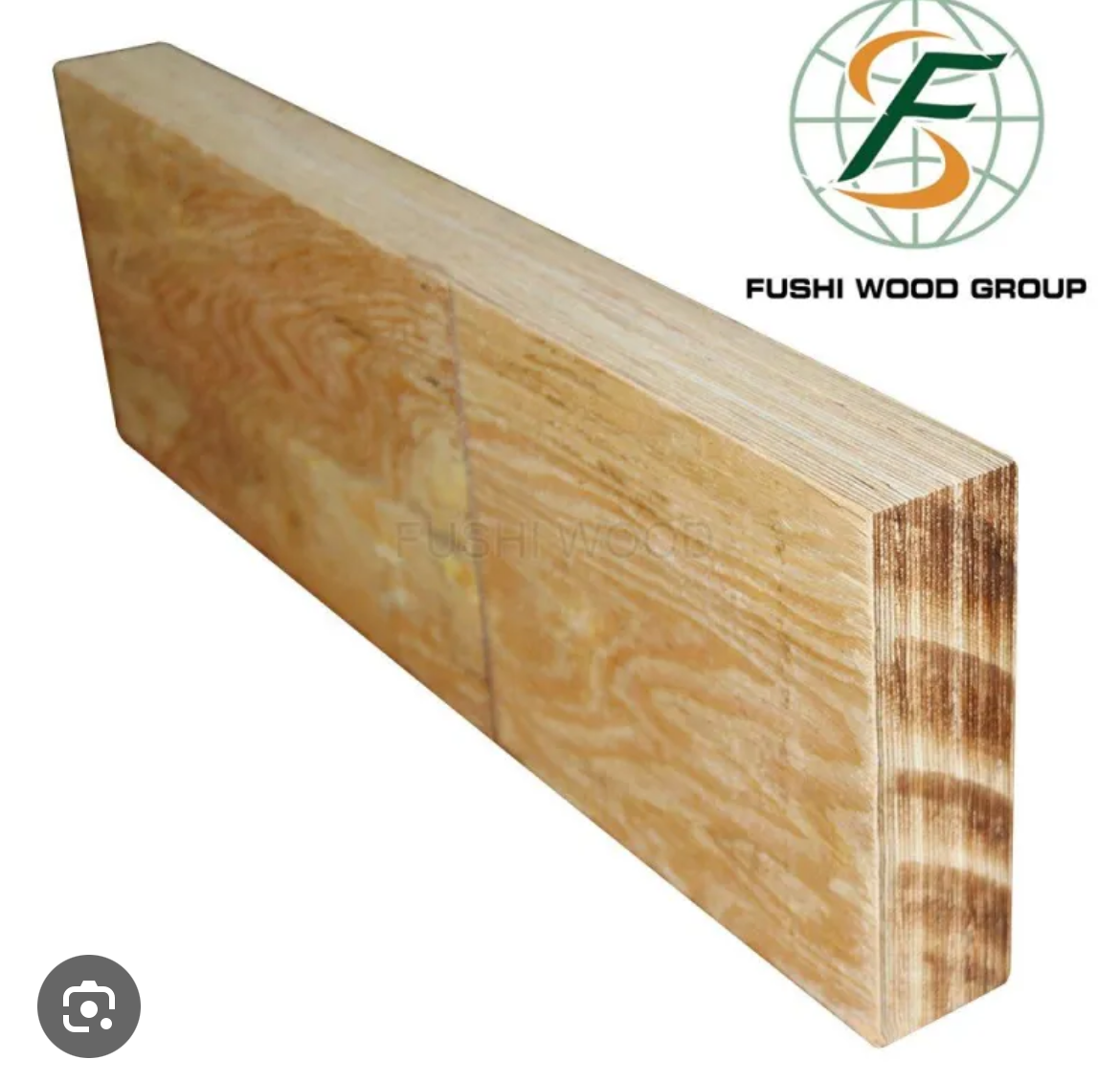

Some impressively huge wooden beams can be made by bonding multiple thin layers together - google LVL, glulam or parallam - made in a factory the leafs are very thin, glued and formed in a roller press in continuous fashion for incredible lengths. Made DIY you'd use glued/bolted sections of thinner sheet, themselves made of very thin sections..
Kinda like a kitchen worktop is made of vary small blocks all glued together so the joints don't align, or a brick wall has vertical joints that are always spanned by solid brick above and below (glulam is like a brick wall the blocks have horizontal glue planes, parallam / LVL have vertical glue planes)

Ive cleared the area of insulation now so I can see what I have to work with.
I'll try and explain but it might be easier with a diagram.
This area of the loft is above a bedroom with a large bay window. The bay window is a flat roof protrusion from the house. It is supported, I believe, by wooden beams spanning the 2.6m opening from the brick work outer walls either side.
Above the beam is a triangular gable wall, which is the wall in the picture below in the loft.
So the beam spanning the bay window in the room below supports this brick gable end, which in turn supports roof purlins and the roof ridge.
The ceiling joists run parallel to this, from wall plate to wall plate either side of the space, so they aren't connected to this gable at all.
My proposal is to bolt a ledger beam to this gable, and then run new joists from here perpendicular back to the main loft area which Ive already framed out and boarded.
Here is the bedroom below. The gable wall in question is supported above this bay window.
My main concern is that I don't know for sure what is supporting this gable end brickwork. It must be a fairly substantial beam, as the bay window opening in the room below is 2.6m wide and its double brick thick. Ive seen other 7x3 beams in the loft so it could be a double 7x3 beam supporting this end wall.

Just sister the joist where it sits on the wall plate if you're worried. You've removed bearing area by cutting the joist on an angle to fit under the roof, so double or triple up the width to compensate.
