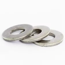

This is a plasplug and screw set, intended for use in brick, block or concrete walls. You tighten them with a spanner, or socket if you have one. The heads are harder to damage than cross or slotted heads, and easier to do up tightly. They will be very strong if correctly fitted.
Many cordless screwdrivers or combi drills come packaged with suitable sockets.
If you want, you can throw them away and use screws and plugs of your own choice.
The work like normal fixing but grip a bit harder to hold the weight better.
Use a spanner or socket but don't overdo it.
If you see the plaster being pulled in you're done, don't keep tightening.
Why could they not just included normal screws?
Because what is included makes the fixing more sturdy if wall is brick or block. No good with lath and plaster or plasterboard
normal screw heads aren’t generally large enough to grip the slotted part of the bracket. if you use screws use the holes in the brackets not the slots.
