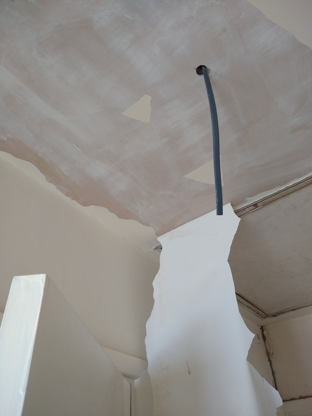

I was just about to paint my ceiling and I noticed a bit of it peeling off..
Well two minutes later and all of the paint has come away leaving behind the plastered ceiling wall..
In order to avoid this happening again.. Shall i paint the ceiling with a watered down white matt (70/30 paint to water mix)
Then paint again with dulux trade matt paint?

I would use Zinsser Gardz then your finish paint.

Odd, the ceiling looks like someone tried washing off distemper, which is not something that I would have expected in a house that is only 60 years old.
I suspect that the very first coat that was applied was not sufficiently thinned and may well have been applied by brush. When you use a roller over incorrectly applied paint it often pulls the softened paint off.
As NigeF suggests Gardz should seal the existing paint and prevent the moisture in the new emulsion from disturbing the old emulsion.
Alternatively, spray the remaining parts of the ceiling in the photo with water and scrape off any existing paint and then thin the first new coat as per the instructions on the tin of your emulsion. Then use the Gardz over the other ceilings that you haven't yet painted.

All of the paint on the ceiling has been removed..
I plan to use the Gardz and then paint. This will successfully complete the job?
Maybe the person who painted it inadvisedly used PVA on the plaster first. That would stop the paint adhering properly.
First clean the chipped area using paint scraper after getting clear and dry, apply oil based primer with stain blocking.
