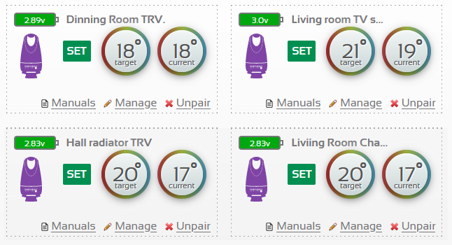

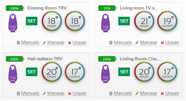

I have electronic TRV heads so my computer shows target and current 4 TRVs-1.jpg so I close the lock shield a tad if current over target, and if after a couple of hours target not reached, open the lock shield a tad, once set rarely need to touch.

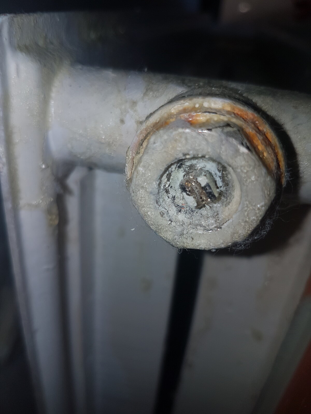

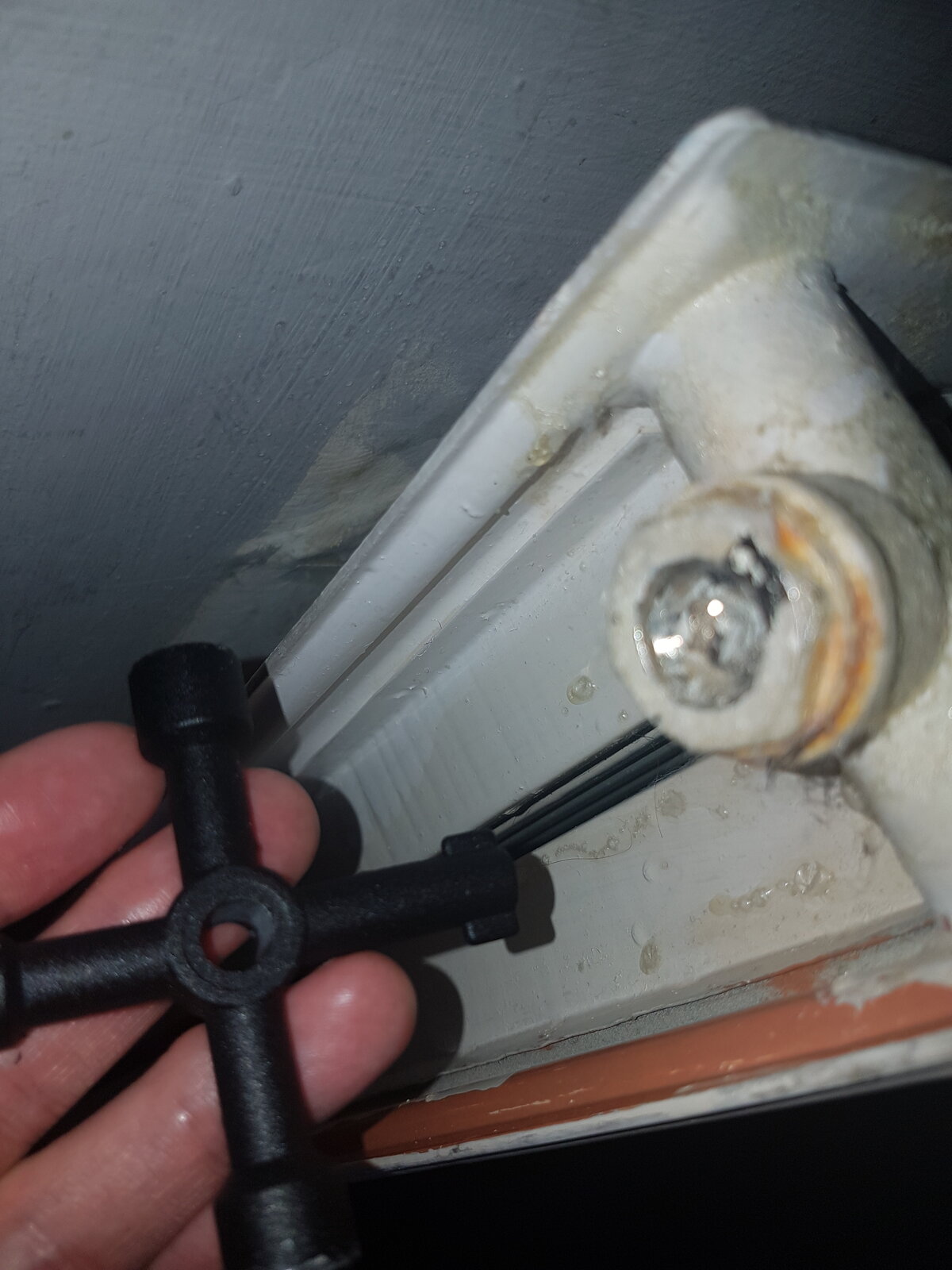

Finally had time to bleed the radiators. So annoying as one if them where the radiator key doesn't work and the place where you put the flat head screw driver to turn it had no grip, please see pic. What do I do?
Bleed key

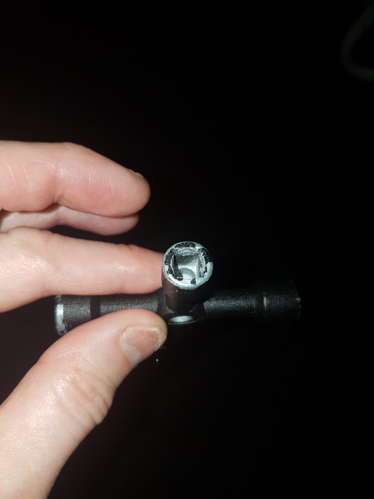

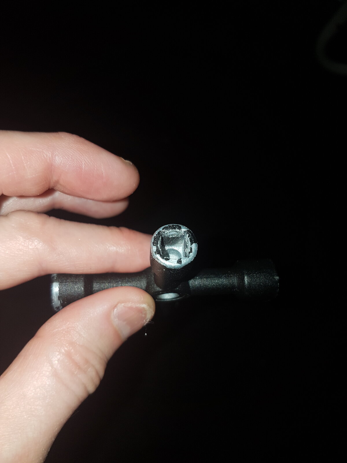

Don't understand why this key will not work?

I think the old one is clogged with hard limescale.
you may as well take out that old plug (with a spanner) and fit a new one. They are not expensive. Usually sold in pairs, one plain plug and one with vent pin. Close the valves at both ends of the rad first.
the modern ones usually have a "O" ring seal but PTFE tape on the thread may also do some good. It looks like the one in your pic was badly fitted, and not repaired when it first leaked.

Screwfix, Ebay etc. "radiator vent plugs"
keep a few in your plumbing box.
Those utility keys don’t always work. Either use a clock type, or as suggested, replace the bleed vent.
Well I bought a bleed key and it worked, don't think that other one is a bleed key.
