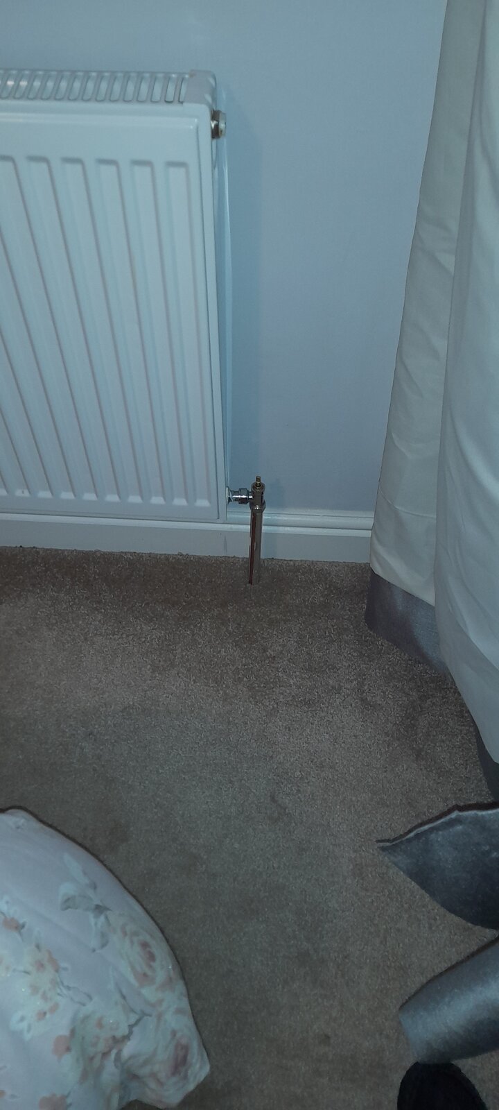

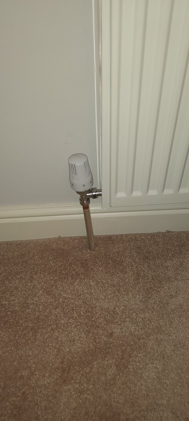

Radiator not heating up
Thanks, please find 2 photos attached
OK. Standard rad. No omnidirectional flow required (as long as trv is biflow which 99% are these days).
Only other thing is both valves could be piped onto same pipe (flow or return) but I doubt it.
It's back to a blockage on the return or flow and needs powerflushing (for as long as it takes) with the right chemicals, in the right fashion. Else it's floor up and repipe, or find an alternative route for piping above floors.
PS. I'd enjoy a crack at flushing that and clearing it. Pretty sure I'd clear it if a blockage. Else, study up on powerflushing and DIY with a machine on hire at your leisure.
