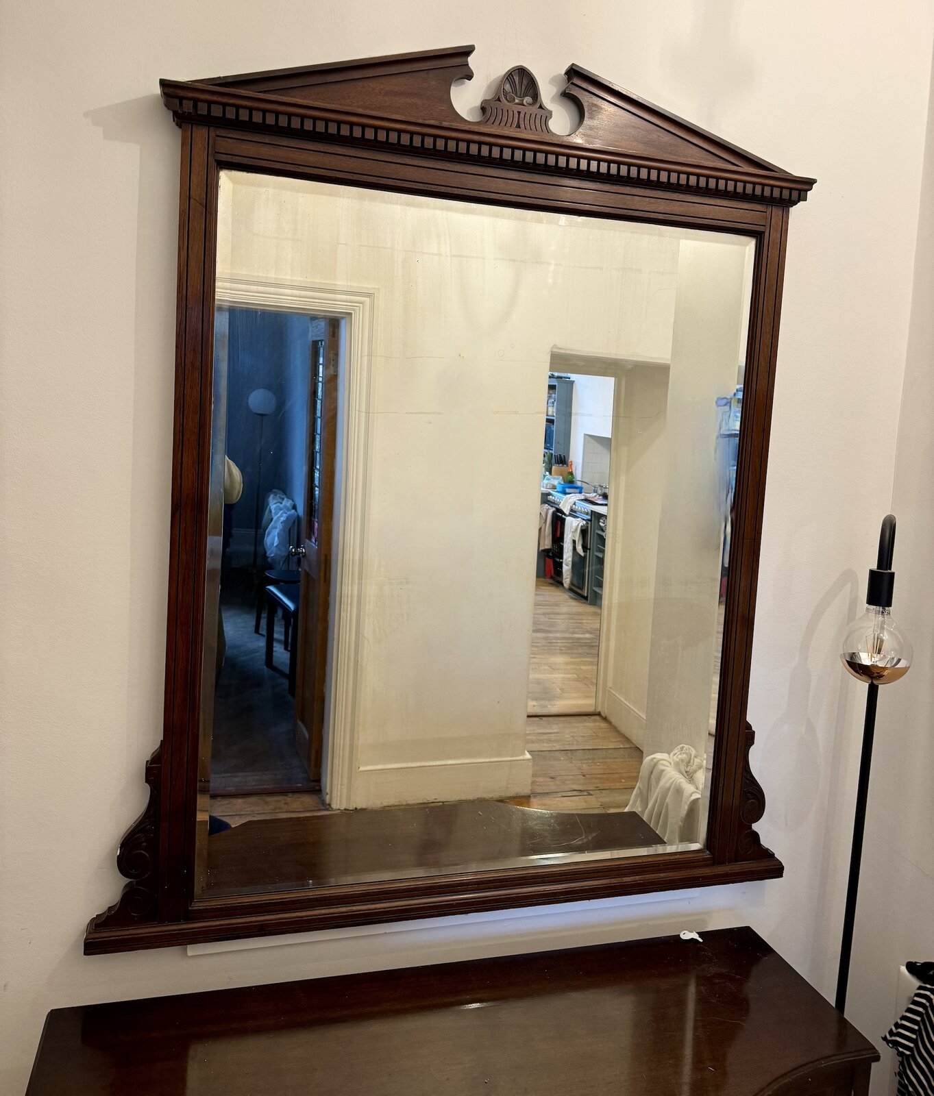

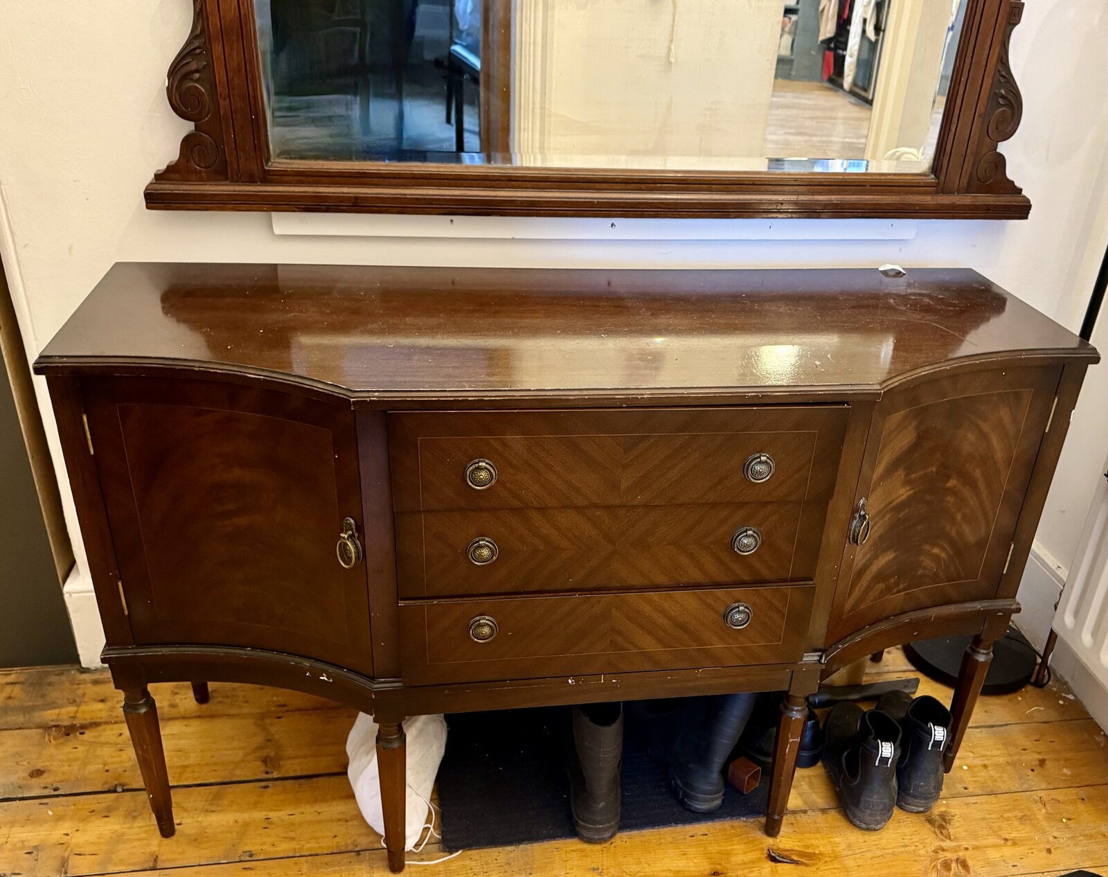

We inherited this console table with our house. It has been well used, a few minor scratches and bits of paint. How do I bring it back to its best?
It looks like a veneer finish.
Finely sand it until all varnish is opaque and revarnish with oil based gloss.

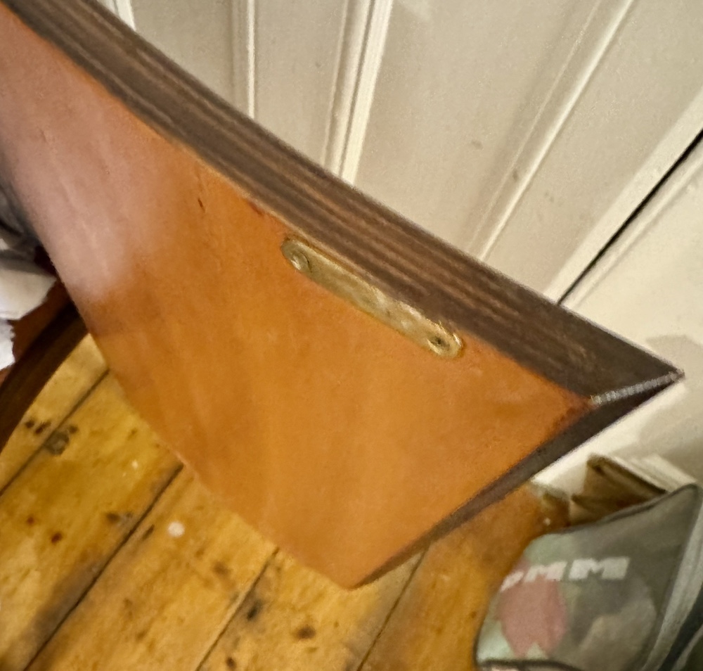

Would it just be the front that is a veneer?
If we sanded it, would it go a lighter colour and could we then oil or wax it?
Definitely veneer then.
Don't hard sand it.
Use 180 or even 240 grit to make the top layer opaque and then recoat.
Possibly the top as well. Be extremely careful of sanding veneered surfaces - modern (i.e. post 1920s) veneers are often only 0.4 to 0.6mm thick snd are frighteningly easy to sand through, especially when using power sanders
TBH I'd try to ascertain the date (any makers brands, labels or plates anywhere) and the exact type of finish before doing anything. Modern (i.e. post-WWII), factory made furniture will most likely be pre-catalysed lacquer or 2-pack lacquer, neither of which can be easily repaired - instead you need to strip and refinish. You also need to ascertain the type of finish, but I reckon that modern factory finishes are best scraped off using a cabinet scraper with a decent burr edge before a light hand sanding with P320 sand paper and a wipe over with a clean, lint free cotton cloth dampened with white spirits (to pick up any dust). Watch out for the manufacturer having spray stained different components (e.g.the legs) to get a uniform colour, too, as this may require that you restain the affected part or parts. Parts such as legs with small, lighter coloured chips are probably best dealt with by using an appropriate coloured timber touch-in pen by someone like Konig rather than refinishing
My own preference would be to seal the prepped surfaces after stripping with a light coat of dewaxed blond French polish, followed by a couple of coats of an appropriate sheen clear acrylic lacquer.
BTW, looks reminiscent of the Stag furniture produced in the 1970s and 1980s, but I may well be wrong
