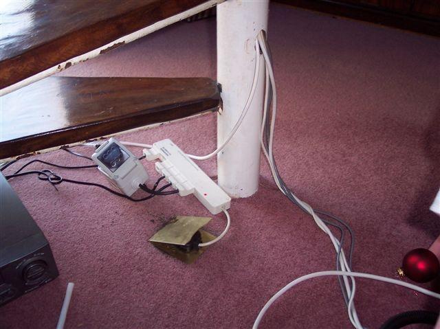

I think this was an MK socket but it was a long time ago.

Downright dangerous as well - just placed right to slice feet open
It is positioned so as NOT to be dangerous.
It is under the second tread which about 14 inches of height above the socket. People starting to walk up the stairs are facing the camera.
That said this type of flapped socket can be a hazard if located where people can walk towards themwhen there is a plug in the socket
Sorry, I wasn't referring to your particular installation (though I see it looks like that) - but to the fact that when there's a plug in the socket, the flap is just the right height to get feet. At a previous job, they had these at intervals across the very large open plan office. Given that this office was wired BC (before computers), there weren't many of them, and predictably you'd end up with them being used where they were "out in the open". One of the office clerical lasses sliced her foot open with one.
