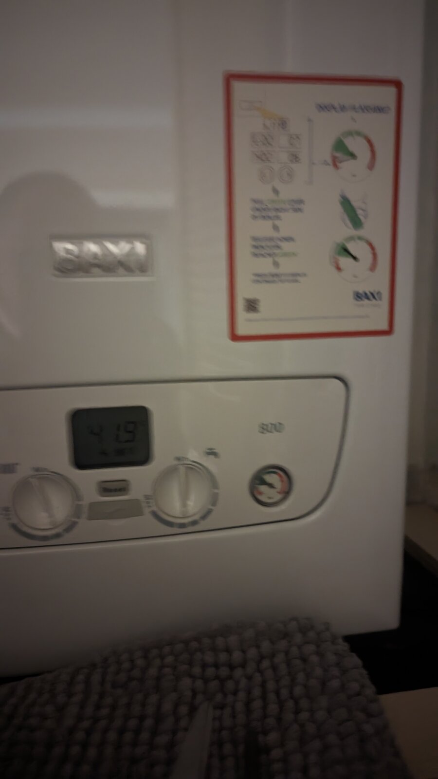

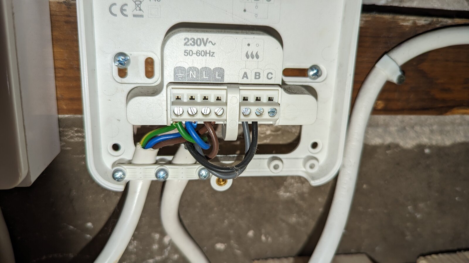

Hi all I'd like a bit of advice please... I'm looking to change my wireless Honeywell for a hive thermostat if someone could just let me know if my setup now is straight forward to change over to a hive receiver.....Many thanks

Sorry I should of mentioned we have a baxi combi thanks.

Anyone please I've just bought the combi boiler hive I just want to make sure it's ok before attempting to change the receiver thank you.
Thank you so much so I'm guessing once I turn off the isolated switch near the boiler the wires after will be dead? Thanks
You can’t or shouldn’t guess that they’ll be dead, correct procedure is to test for dead using suitable equipment, such as a 2 pole voltage indicator. It does look like the fused connection unit daisy chains across the receiver into the boiler.
You can’t answer shouldn’t guess that they’ll be dead, correct procedure is to test for dead using suitable equipment, such as a 2 pole voltage indicator. It does look like the fused connection unit daisy chains across the receiver into the boiler.
Yes it was daisy chained but I turned off the mains just incase . Thank you.
