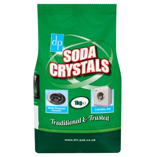

Depends what the deposit is. Very often it is a sludge of resident soap, fabsoft and the bacteria that feed on it. This is aggravated by overgenerous product use, and cool washes that do not dissolve it well.
This sludge can be removed with a HOT HOT HOT wash cycle, with no soap, no fabsoft, no bleach, and a cup of washing soda crystals. This dissolves the soap and breaks down the waxy fabsoft deposits. You will notice the water in the machine foams up and goes grey as the soap sludge dissolves into it.
You can put some white cotton towels into this cycle, since it will not matter if they fade or shrink in the hot wash. You will find the towels come out softer and whiter as the residue also washes out of them.
You can minimise future sludge buildups by reducing the amount of coap, and adding washing soda crystals. This will also soften the towels.
The soda is about a pound per 500g bag. It is not the same as bicarb or what Americans call baking soda.
