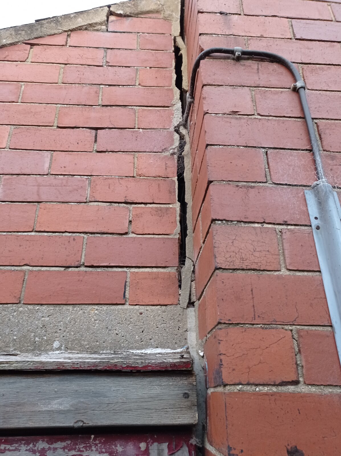

We have a single story extension that has rotated. Structural engineer says movement stopped decades ago and it is worth trying to save the extension. We can't afford to pay for the work so I'm trying to scope the DIY job needed. It needs a floor and some new lintels over windows/doors but I've got one problem that I don't know where to start with.
The extension wasn't tied into the house and when it has rotated it has come away as per the photo. How do I tie these bricks into the main house wall, and how do I close that gap? Any ideas gratefully received.

It wouldn’t have mattered whether it was tied in or not, nothing would stop that crack forming.
extensions are of course built on different foundations to the host building and so they can move differently.
the extension may have stopped rotating but it may still move around a bit….if that’s true, I wouldn’t repair with mortar….maybe use compriband.
if it’s stable then maybe you could grind out the pointing and put in stainless steel helical and re point
If your engineer has stated that movement has ended, you don't need to tie this in.
Point it up with mortar or mastic if you don't have the funds. Tooth or block bond if you do.
I'd put some sort of monitoring strips across the joint for a year or so first, actually measure exactly what's still happening rather than relying on someone's opinion.

See how good or bad it is then take it from there. If it's moving and you tie it into the brickwork then it may just lead to the extension and/or original building getting pulled apart.
