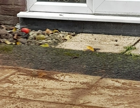

There was a sloping drive to a garage, garage made into a flat, and outside the patio door I have built up the ground so I can have a level area for seats etc. This has left me with a little of the slope left 1761827505039.png and I want to fill over that tarmac to level it out, just to remove the trip hazard with the edge of the slabs, but the slabs are a yellowish tinge, I would like concrete to match.

Buff dye is the answer.
Or just buy buff slabs, probably a much better match and will look better in every way. Chop up as required.
Yes mix it up with water and tryit, but might need a few coats to get the colour depth.

Coats? It's dye, to mix with the concrete!
You need it coloured right through. Using any paint on non-dampproofed concrete will result in a blistered mess.
I'd use 10mm pea gravel and more sand than normal, to maximise the dyed slurry that sits on top. 1 cement, 2 sand, 2-3 gravel.
Sorry I have misunderstood the post and the pic. Just re-rread it and looked at the pic and now realise it is a tarmac strip. I thought it was unfinished concrete.

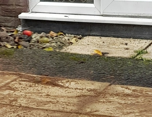

There was a sloping drive to a garage, garage made into a flat, and outside the patio door I have built up the ground so I can have a level area for seats etc. This has left me with a little of the slope left View attachment 397661 and I want to fill over that tarmac to level it out, just to remove the trip hazard with the edge of the slabs, but the slabs are a yellowish tinge, I would like concrete to match.
Replace it with more yellow slabs.

Oh, fill over the tarmac? In that case you can't!
Do it properly - dig it out and replace with something else or just accept it as-is.
