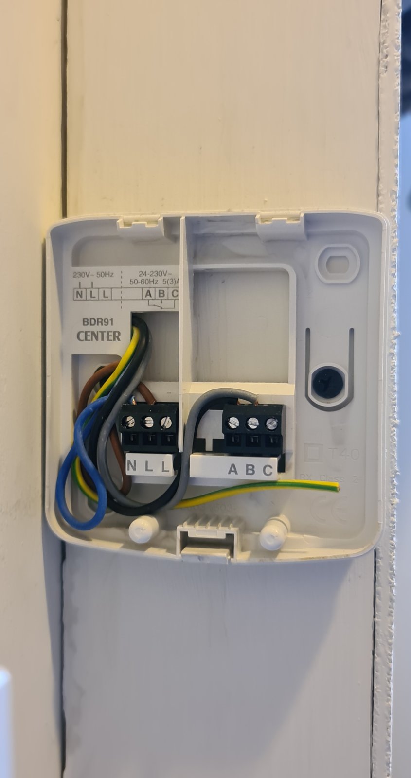

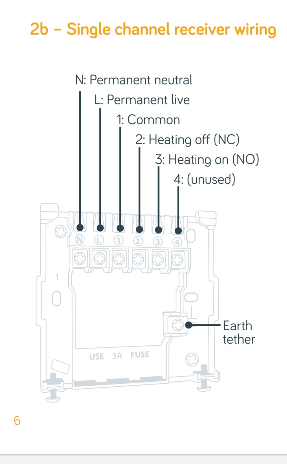

Hi .
Ive just bought a new Hive thermostat , i just need a little help to wire it up , i have 2 pics 1 is what is there at the moment and 2nd is what i need help with . I know there only 4 wires 2 of which i know L/N its the other 2 wires the grey and black labeled A and B um nit sure about .
Thank you

The grey and black in A&B go to 1&3 on the hive receiver, DO NOT MAKE ANY LINKS, some set ups require links as you may have read if you have been reading other posts.
Hi
Thanks for the reply , the Black wire is A and the grey is B here . I just need to clarify which one is 1 and 2
Thanks again
