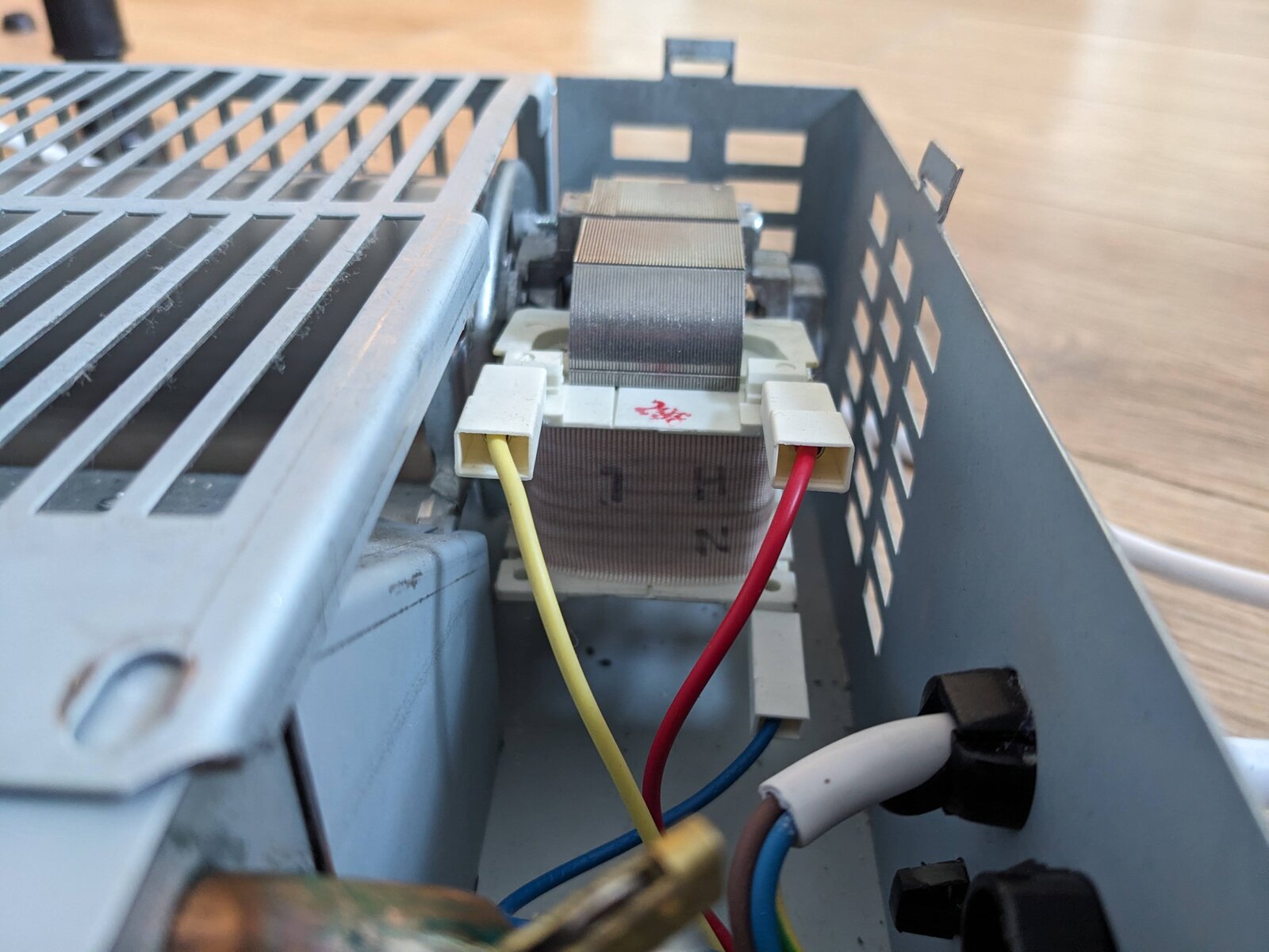

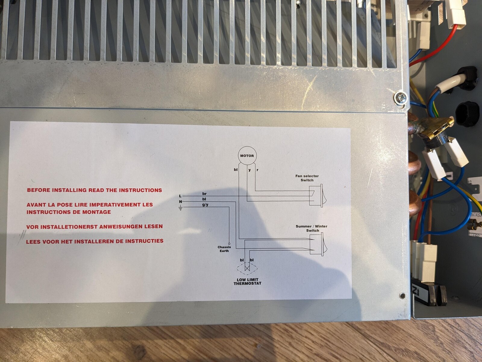

My under cabinet fan convector has a 2-speed fan, but I find the low speed setting still too noisy.
I'm capable of a bit of soldering and the like, so I was thinking about converting it to a variable speed, or keeping it as 2-speed and somehow reducing the speed of each setting.
I have attached a wiring guide for reference and would welcome any suggestions on how to go about this.

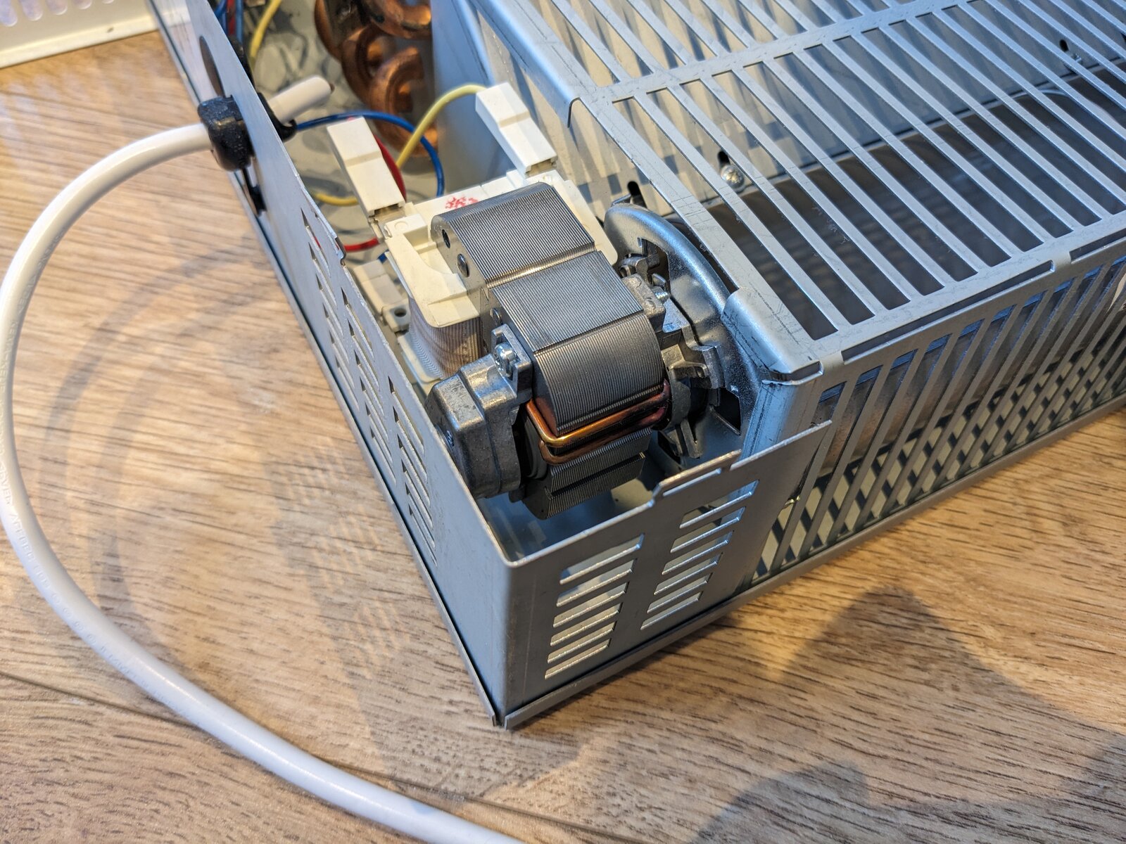

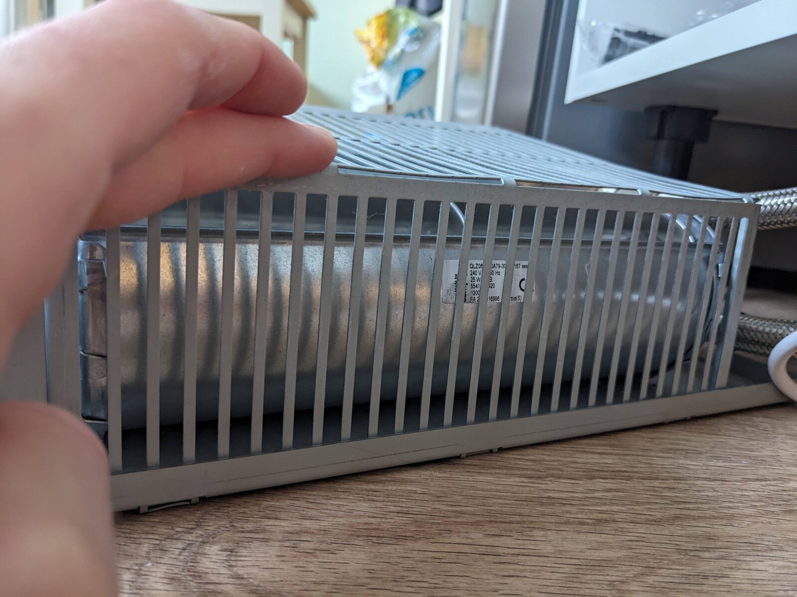

Thanks for your reply, please find attached a photo of the front of the motor where the 3 wires connect, a rear view of the motor and a picture of the only other label/markings that I can see. The label reads:
Made by Ebmpapst
QLZ06/2400A79-3025L-1677 aes
240V AC 50Hz
25W I.CI.B
55411.20420
1200050
FA 2510016996

That motor is a shaded-pole type. A suitably-rated fan speed-controller, widely available online or in store at a modest price, should do the job. But bear in mind reducing the speed will also reduce the fan's cooling ability.
