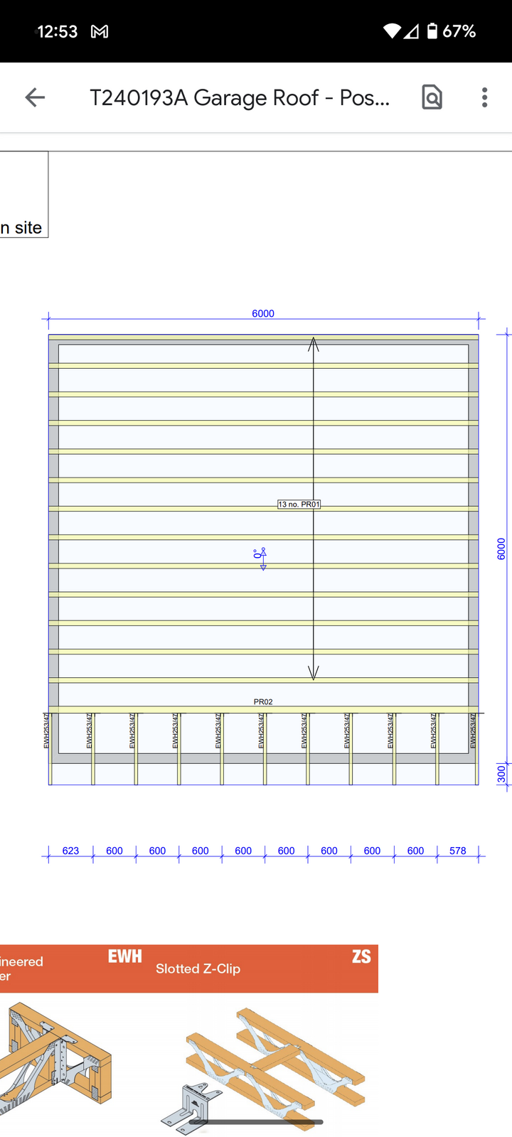

I'm planning on using 6m long posi joists across the walls to create roof structure on a double garage... It's to have a flat roof, with slope created from tapered pir.
Any ideas as to how to form an overhang over door? Other than literally hanging a bit of frame work off the deck? I can't irnvusage there is much to fix to on a posi joist? (never used em before)....

In the absence of any specific design from your supplier(?) - keep the last joist back a wee bit from the inner face of the wall. Fix a same depth timber to the face of the posi, the run timbers off joist hangers to the outside.

Good idea. Thanks
Precisely what posi joist supplier has suggested
So OK with front overhang detail. Now thinking about fascias... How much will roof need to be past wall to allow for cladding and fascia?
The internal lip of (cap) fascia is 30 - 35mm. What do you mean by cladding? Are you adding material to the external walls?
Walls are to be 6*2 timber studs, noggins and metal strap bracing... So yes, likely clad with vertical gravel boards, with battens over joins...
So total cladding depth approx 50mm....
