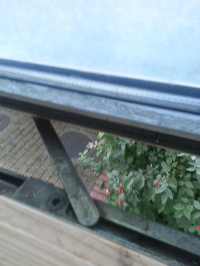

No, no it's still a metal bar I was just saying it appeared to be as dense as those padlocks. It's a metal bar 1.3cm width, <1cm height, 6 inches length. It's the thing that slides to adjust how much the window goes out. I don't really use social media and probably'll had some trouble with bluetoothing to my laptop from my phone, I'll see if I can get a pic of it exactly. Though it looks more like https://www.google.co.uk/search?q=m...isch&q=copper+metal+bar&imgrc=2LFtfGlEVQ6IhM: than the padlock above.
If I were to use alan keys to unscrew the device surrounding that 6 inch metal as well any advice on those like what the most common alan key size is used generally if there is a common size. Also does anybody the name of the screwdriver that fits into screws which seem to have a star shape?

The metal you refer to is likely to be brassed steel, and not particularly hard - at least to a good hacksaw blade!

There's one.
For some reason, four times uploaded.
You can see the hexagonal alan key slot there too.

This one shows the thickness.

It's just so that it opens more to get a bit more air in as it's generally way too hot in my room.
Do you know if that is in fact brassed steel or what metal it is out of interest? Judging from your post count I take it you've done a lot of DIY or possibly work in the field? I'll have to get a hacksaw then. Cheers.
Fair comment, but you'll need to lose the ends of that stay once you have cut it!
The metal will be steel with a plating to prevent rusting.
